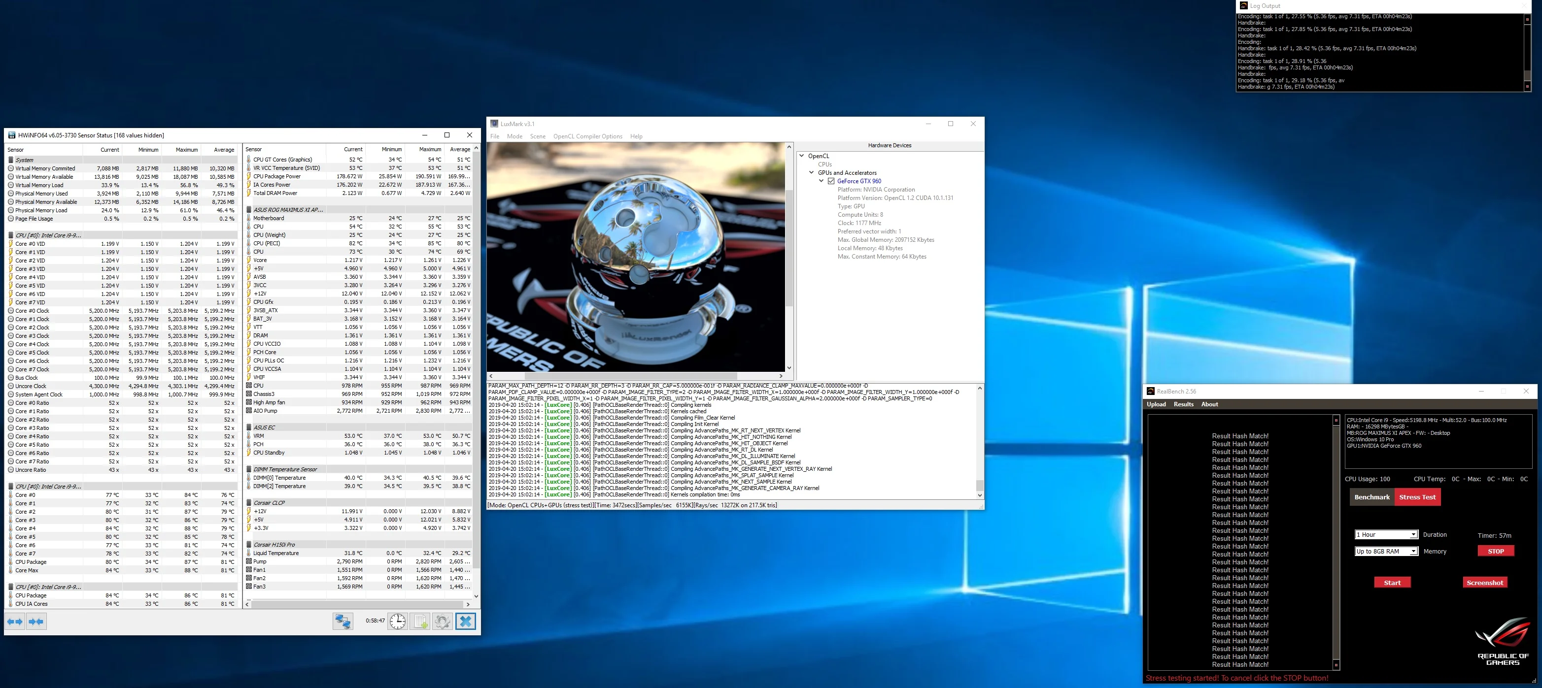

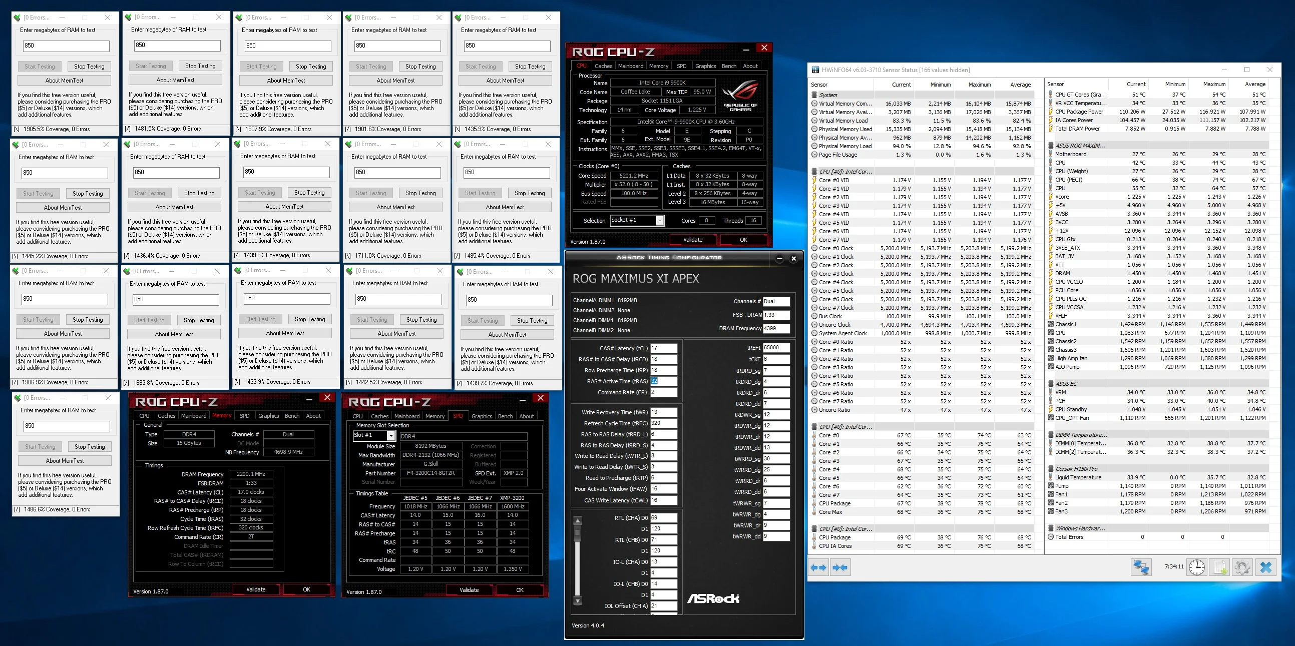

Temps seem excessive for that load voltage, what are you cooling with ?
RB not showing any temps ?
For some reason Realbench stopped showing temps after a Windows update. I might do a clean windows installation this weekend. Hope it fixes it. I'm using a Corsair H150i 360mm and temps are similar to the Kraken X62 280mm I was using before. Honestly, I'm not impressed with the Corsair, I'll probably delid the CPU and go custom loop.
