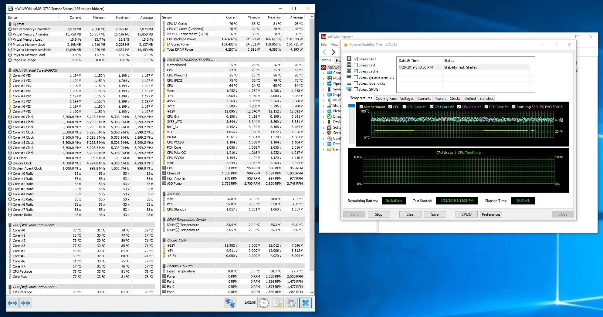

Testing 5.3GHz for 1 hour of AIDA64 (CPU, Cache) at 1.252v under load max temp 81C. Bought the delid kit and copper IHS. I'm going to delid it next weekend. Hope I do it right.
Can someone check\help please.
