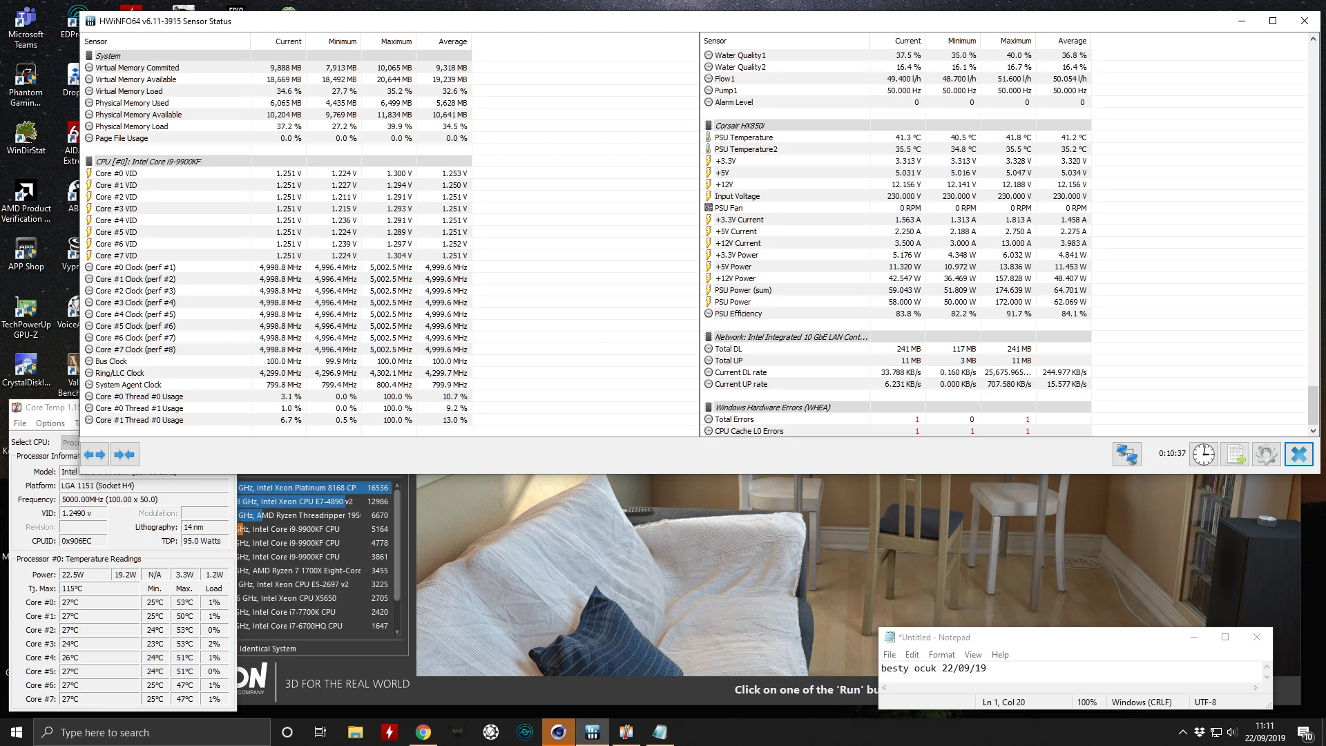

Hey matey, I have retested at 5ghz, this binned chip when tweaked pulls about 160 watts. Bios is set to LLC2 1.195v.

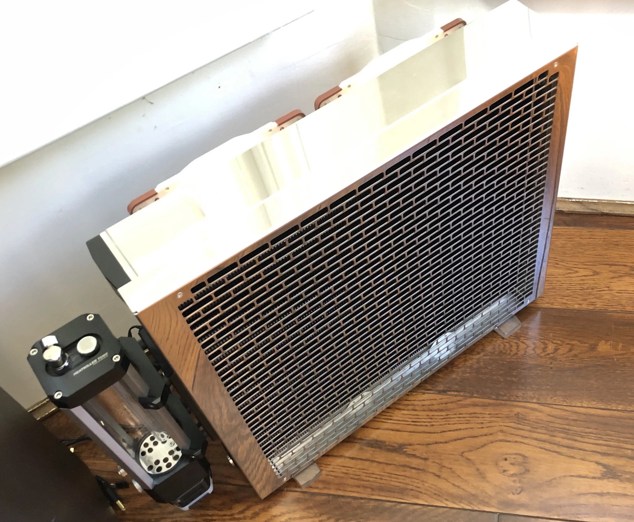

the secret was to stick one of these on my loop:
lol that's badass!
btw, the L0 errors are related to not enough vcore. Another .010 should get rid of those.
You can also get those if your cache/uncore is too high but yours is already at 43x uncore so it's a main core bump that's needed.

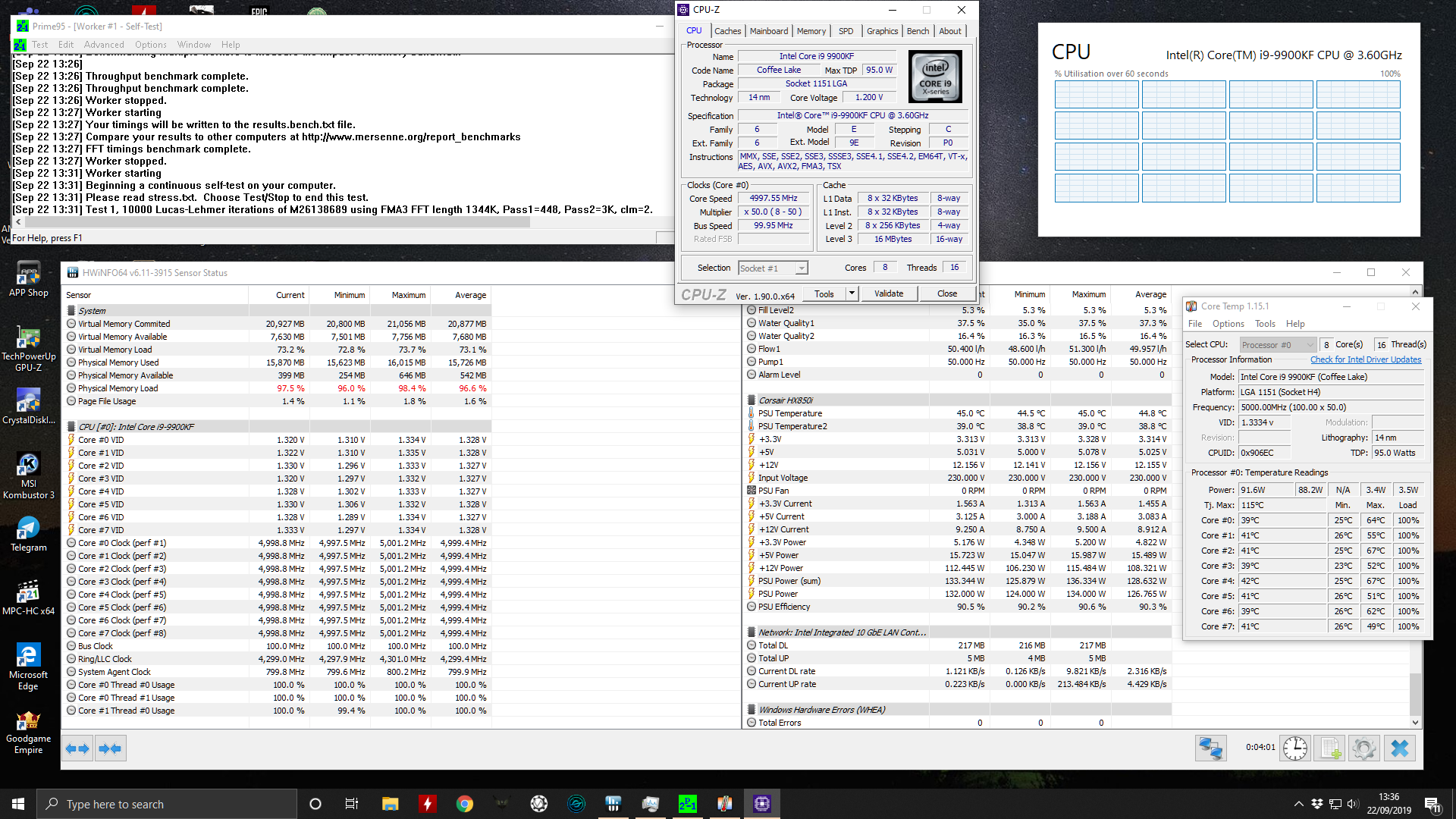

This is where my system taps out due to temps:

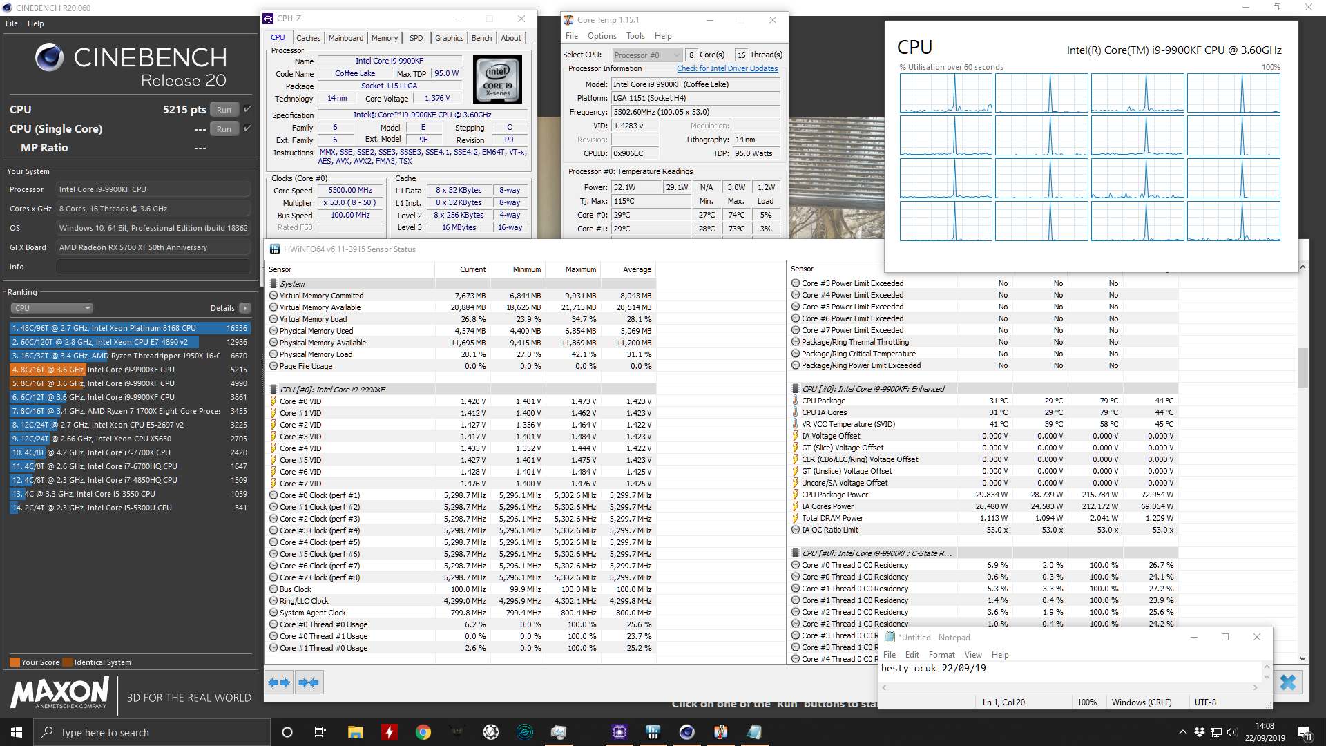

Scores would be higher if was running realtime/admin etc. I was more interested in temps and power draw.
9900kf @ 5ghz 1.2v LLC 1 (maximum LLC)
Prime95 AVX/FMA3 100% load
Going to be touch and go with prime 95 with 8fft temp wise. FFT 1344k is not as bad temp wise. The issue with the 3800x and most likely the 9900k. Is that small fft temps can't be cooled at higher frequencies. At 5Ghz you maybe on the edge but 5.3GHz is likely going to be high enough to hit max temp. No amount of water cooling helps, but a chiller is the only way other than phase change. The temps increase exponentially and at some point you hit the wall.

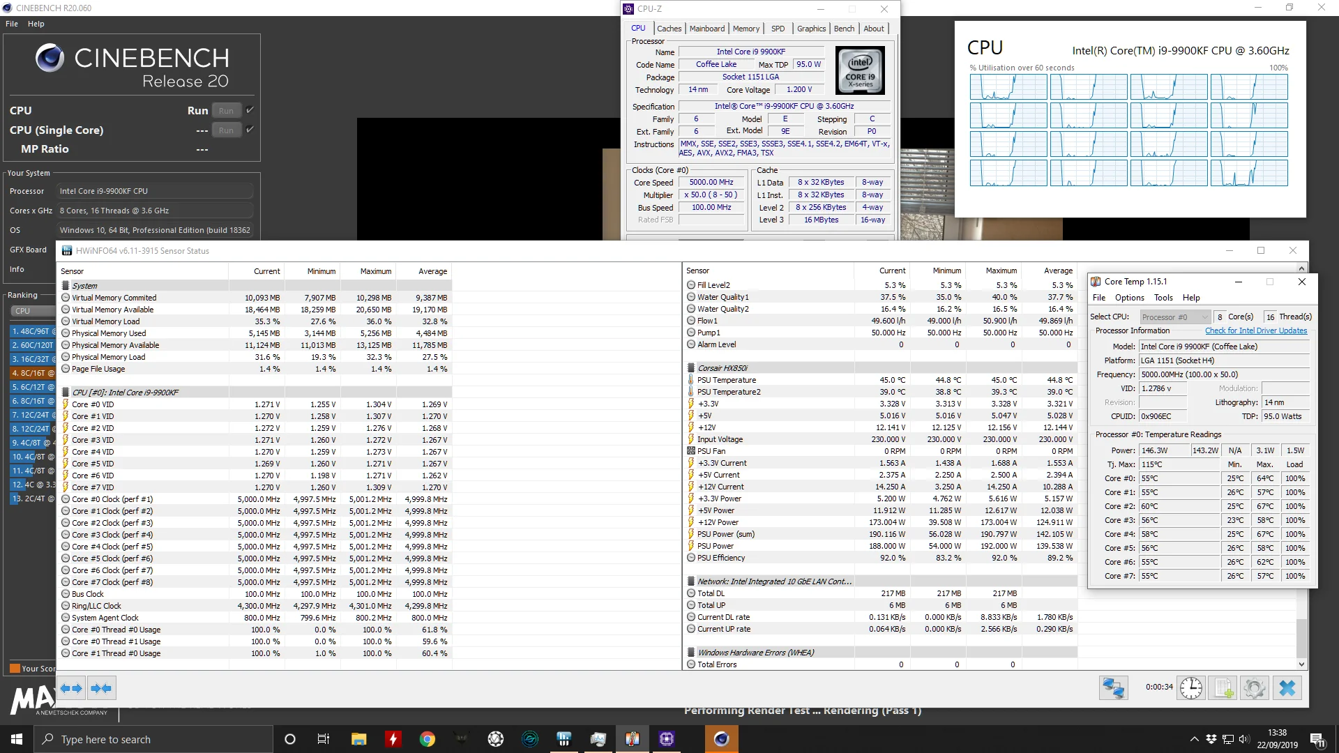

prime95 8k/16 threads run 5ghz @ 1.2v = 181w peak package draw.
if anyone else wants me to run with any other settings then shout.
P95 for cpu stress testing is generally as follows:
Small FFT and number of torture threads should equal your cores + HT threads. So either 8 or 16 (if you have HT on).
You can hit "disable AVX2" and then "Disable AVX" in that sequence if you want to disable AVX which will draw more power and add more heat.
