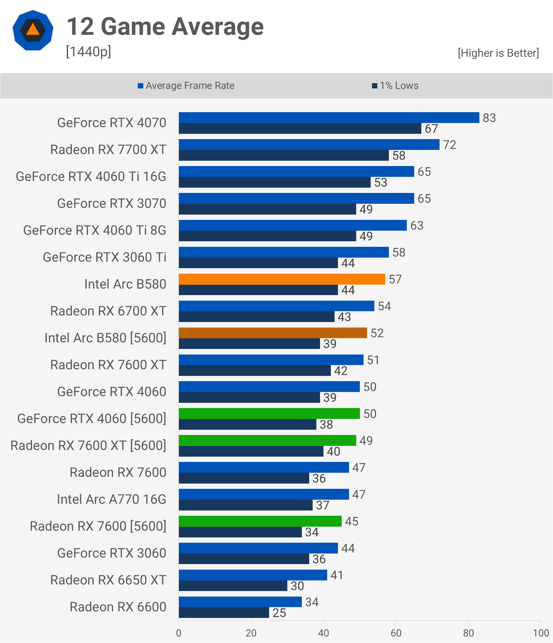

Not quite as rosy at 1080P though, with the B580 dropping off by a huge amount on an older 5600, whereas the 4060 and 7600/7600XT results barely change.
Intel Arc B580 GPU Re-Review: Old PC vs New PC Test
Intel's Arc B580 debuted as a budget-friendly GPU champion, but new data reveals performance struggles with older CPUs. Our re-review dives deep into benchmarks, CPU limitations, and...www.techspot.com
They can advertise it as what they wantyou seem to be really focused on 1080p here.. if so then this likely isn't the card for you.. Intel themselves have advertised this as a 1440p card![]()
- the average framerate in the above 1440P chart is <60fps.... just because it has 12Gb RAM doesn't magically make it good at everything at 1440Pto be fair... it ***** all over your 6650XT at 1440p (even with a slower processor) and is within error margin of it at 1080p.. although given you've got a pretty lame CPU then you're best sticking with what you haveThey can advertise it as what they want- the average framerate in the above 1440P chart is <60fps.... just because it has 12Gb RAM doesn't magically make it good at everything at 1440P

The issue was never 1440p performance, so posting pics of the 1080p testing and saying there's no problem, while completely omitting the 1080p testing is... Exactly what you're accusing HUB of
You're aware that the Techspot review you've posted is identical to the HUB re-review... Because Steve of HUB wrote it, being a Techspot writer![]()
- been pretty clear about that from the outset.. maybe have a re-read and you might catch up..
The problem is is that I have read what you've postedoh dear.. here he is... again...
I'm focused on 1440p as that is what is applicable to me :cry - been pretty clear about that from the outset.. maybe have a re-read and you might catch up..![]()
ok champThe problem is is that I have read what you've posted
You're saying 1440p is fine and tried (and completely failed) to obfuscate the point of the discussion. Everybody knows 1440p is fine, nobody has tried to say anything different.
Once more, nobody is trying to tell you you've bought a turkey. Nobody cares what you buy. Your GPU doesn't have feelings.
