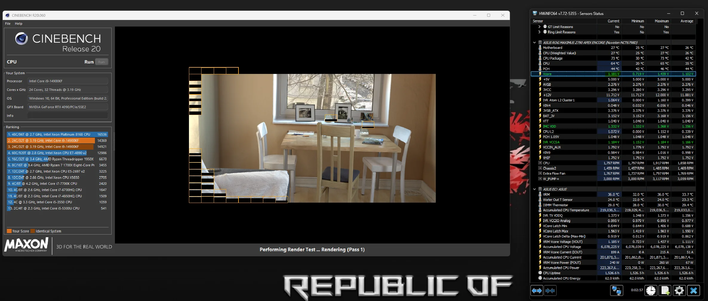

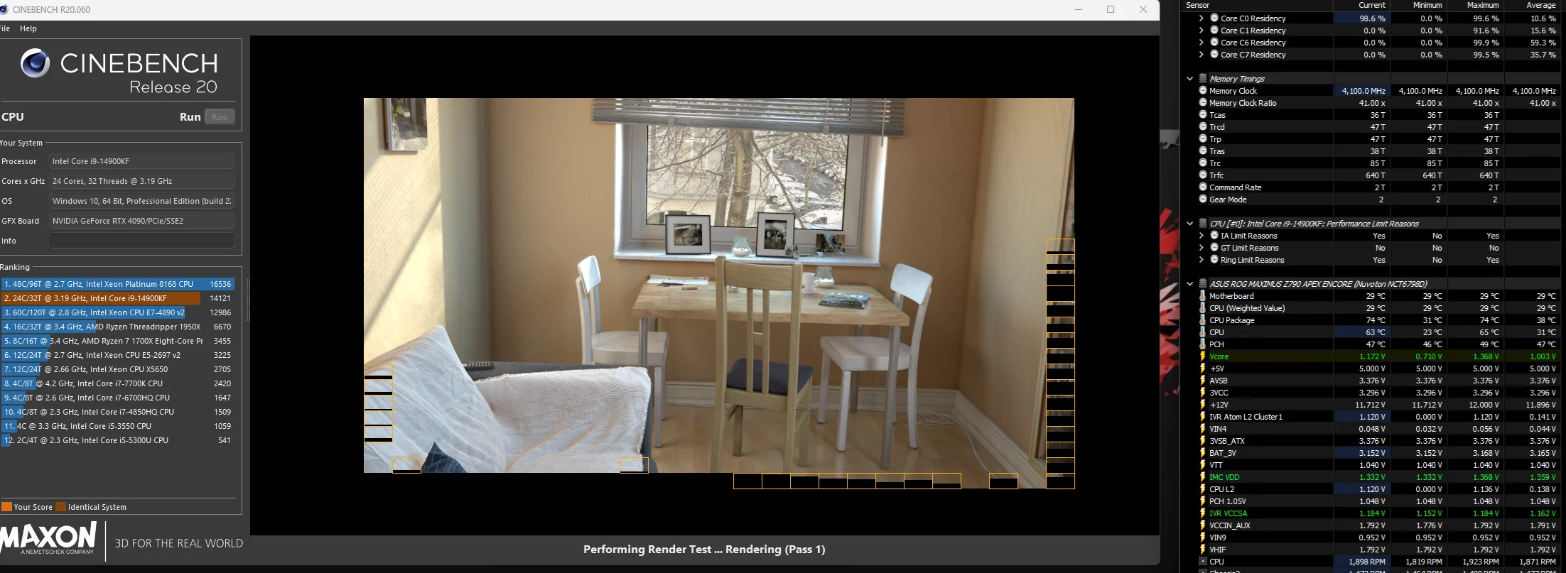

I don't have one of these chips, but from observation, mainly tech jurnoes i see them running 1.5v or even a smidge above that in heavy MT workloads, i've even commented on it here, saying its utterly insane, its mental, and was told i don't know what i'm talking about.
They’d be right. That isn’t how these CPU operate at all. You’re only about 200 to 300mV off.
Just to make sure there's no misunderstanding, the above is using Intel Specification for ACLL. The below screenshot is using ASUS Optimised profile which uses a different milliohms value.
