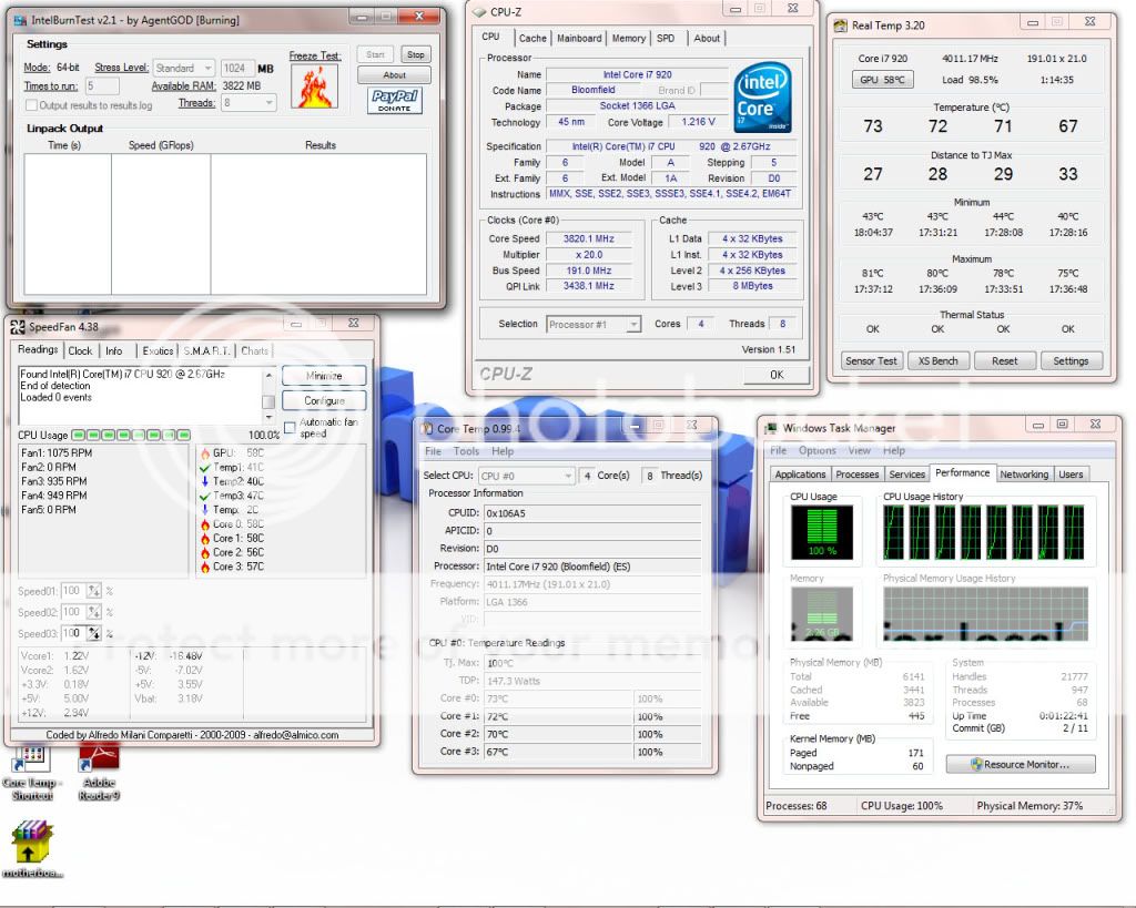

currently testing 4.051ghz HT enabled
Memory at 7.7.7.22
1.3v
currently browsing the internet and listning to music at the same time as running intel burn test v2.1 with 16 threads and maximum stress level
100% cpu usage 90% memory usuage.
currently on pass 5 ;)
things are looking sweet for my system, and this is a awsome clock and i consider if i can pass 20 of this test then im fully stable. Prime95 is obsoleet now i never use it anymore as intel burn test 2.1 is the ultimate stress test for ram and cpu.
