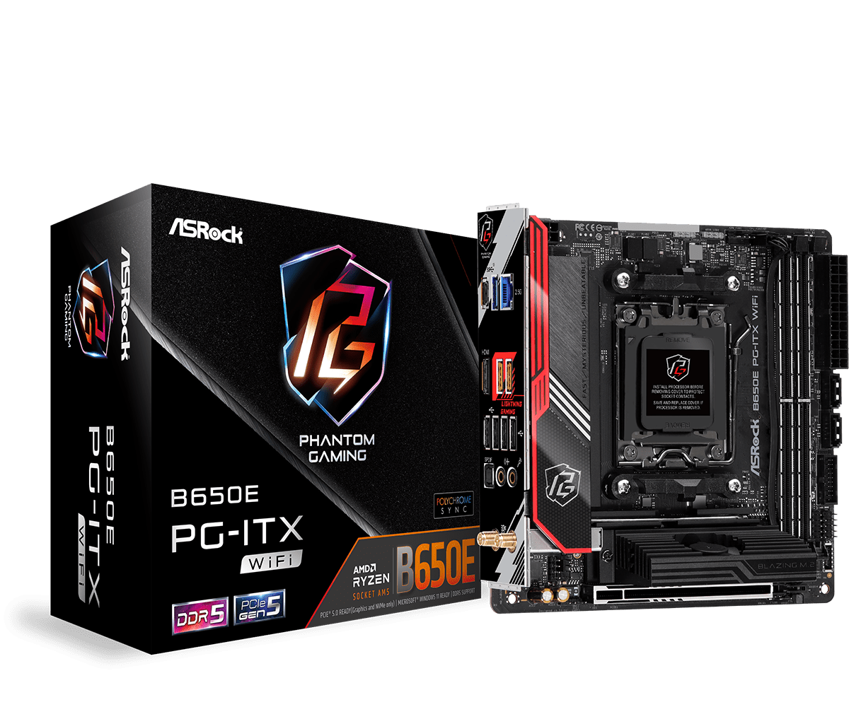

To be honest, I'm thinking maybe just spend the extra and get the ASRock offering with a 7600X - I can't see fans anywhere on their design except the M.2, which I can just leave off or replace with a heatsink instead. It's not going to be overclocked, I just want something trouble free for the next 5-7 years with a CPU upgrade path should I need it.
Yeh, the Gigabyte boards seemingly have their own issues too though. Strange Asus didn't want to send you a fan - there's literally a video on YT where the guy emailed asking for and got sent one.
Reading a review on the Asrock motherboard it mentions lowering the tj max settings to 85°c to keep the vrm in check.

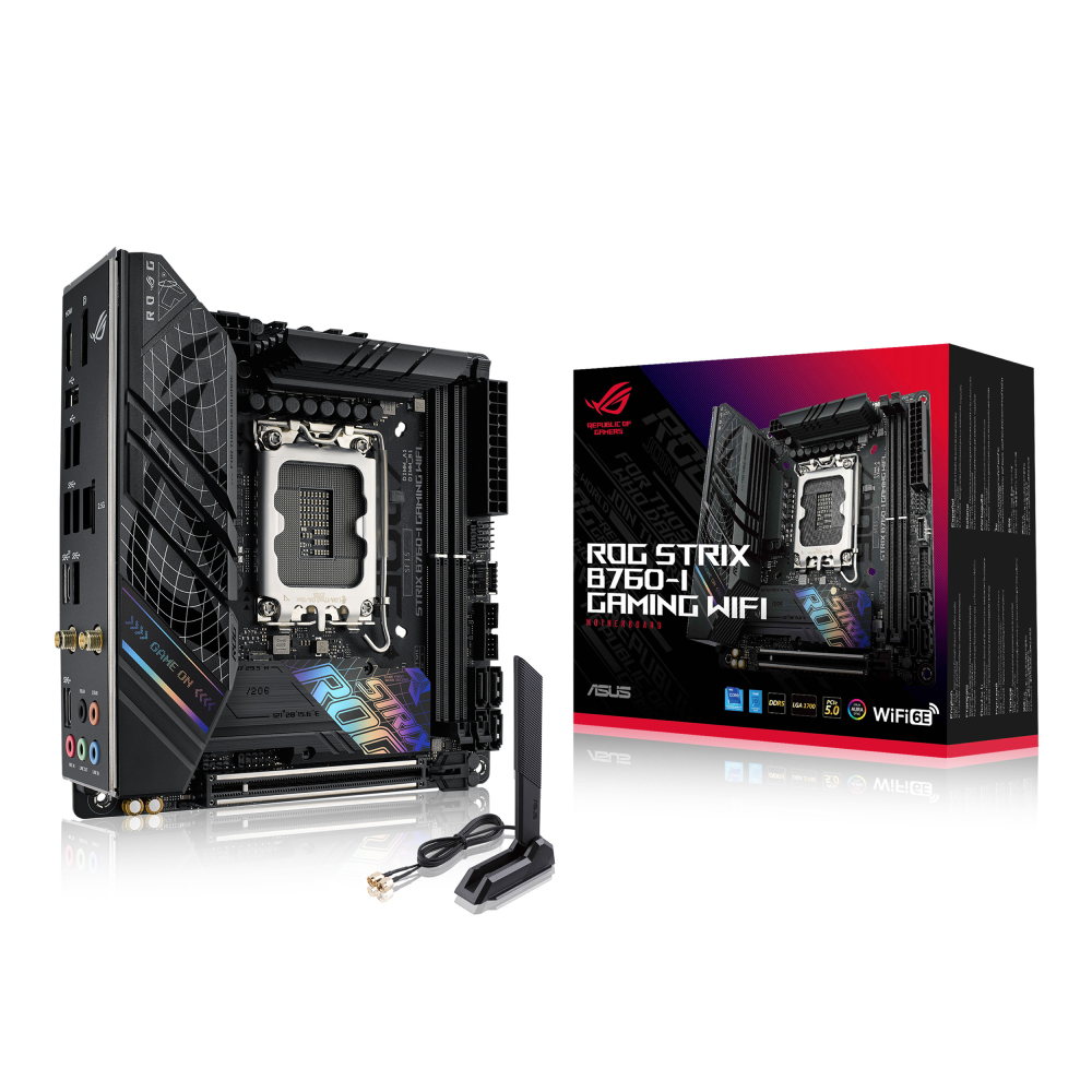

Currently running a Intel 13700K cooled with Noctua D12L, Asus B760i Mobo (only ITX mobo I have found without a fan) and RTX 4070 FE.
