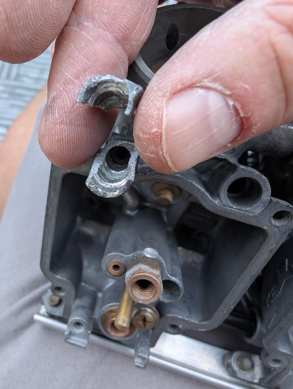

Well, if ever there was a cruel reminder of how quickly things can turn, this is it. That jet was absolutely under no conditions coming out, no matter what I tried. Seized solid. Pretty sure the ultrasonic cleaner made it a lot worse. Expensive lesson to learn!

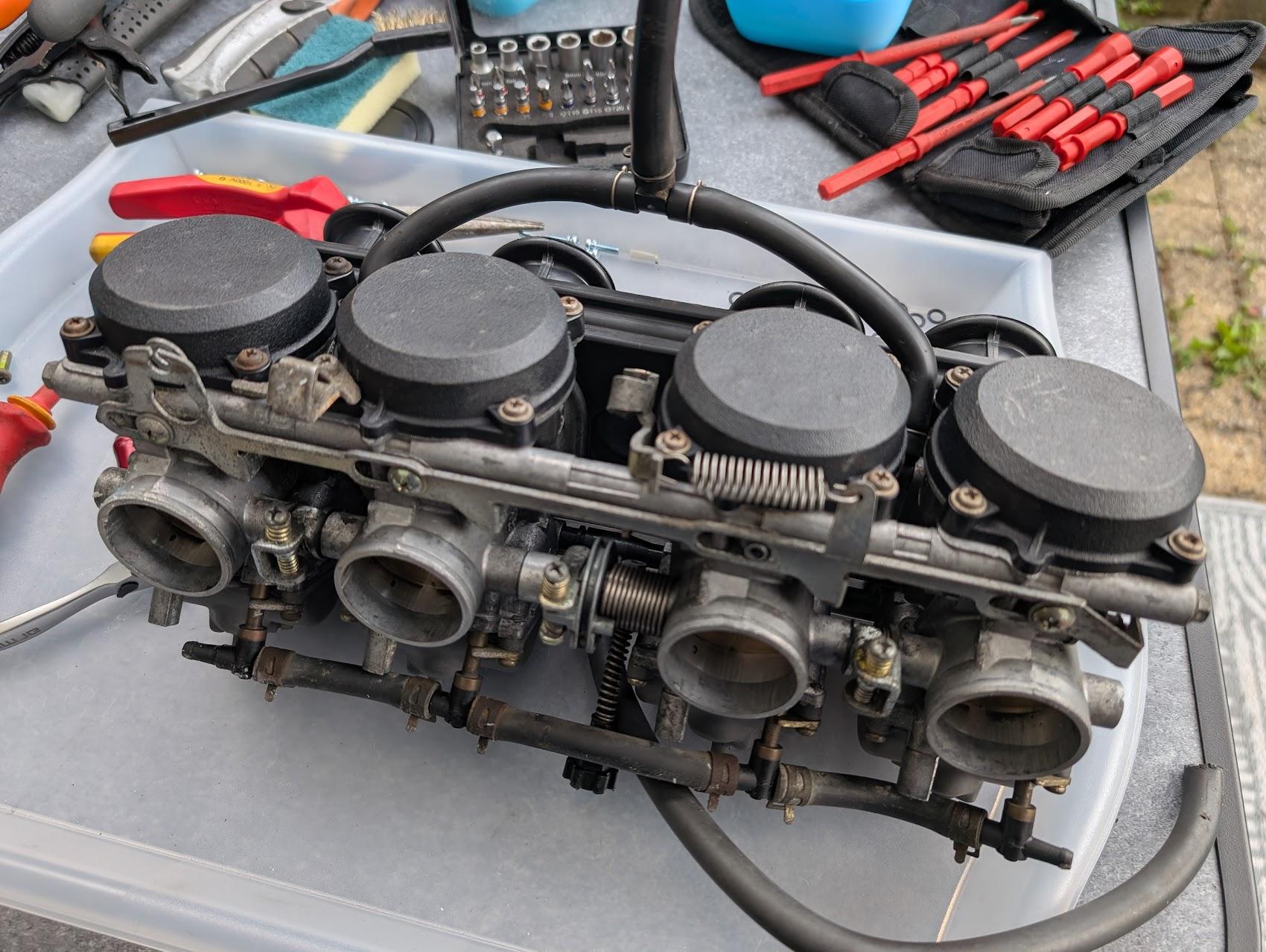

Finally some actual progress. Carbs all cleaned, completely rebuilt, ready to go back in the bike.
The missing screw is driving me nuts so I'll need to sort that before it goes back in.

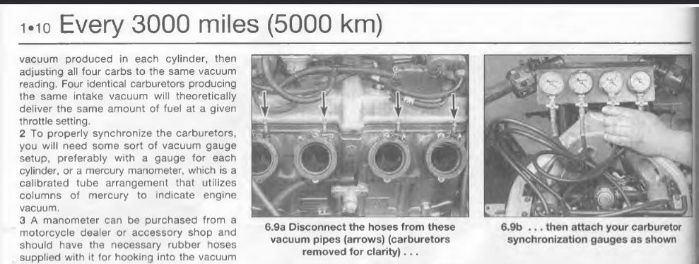

Do you know where the takeoffs for the vacuum lines for balancing are? I had to take the carbs off the 9 to get to mine, yours might be equally hidden when the bodies go back on!!
Edit - that doesn't look too bad at all!

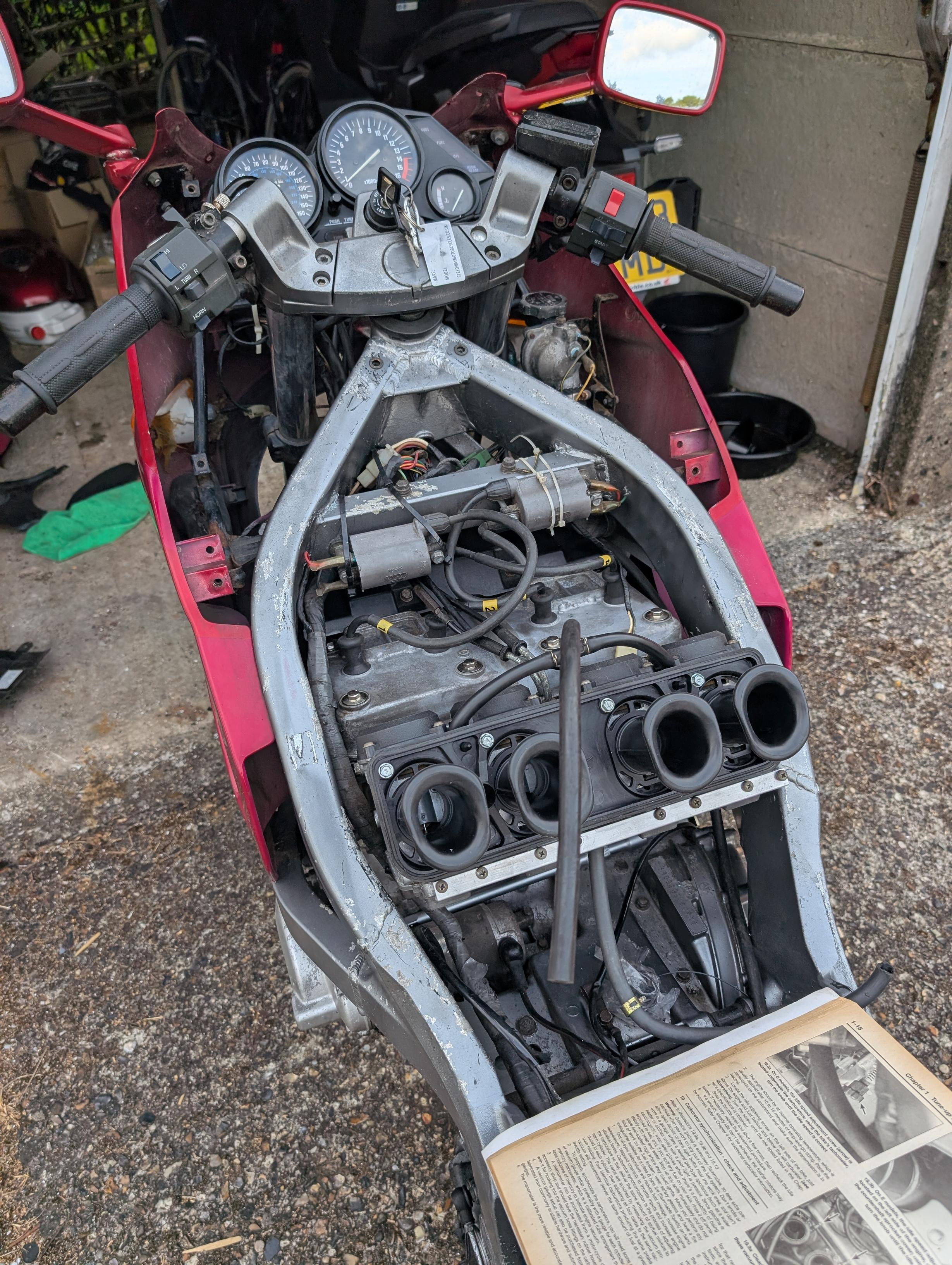

Yeah they're really easy to get to. Problem is that I've no idea where those hoses are meant to go, forgot to take photos when I took them off, so now I need to figure that out. Also have no idea where the other hoses on the carbs are meant to go and can't find any answers in the Haynes manual so now I need to research all that too.
Also, as the excitement is mounting, I couldn't help myself and connected up the throttle and choke cables and screwed the carbs back on.

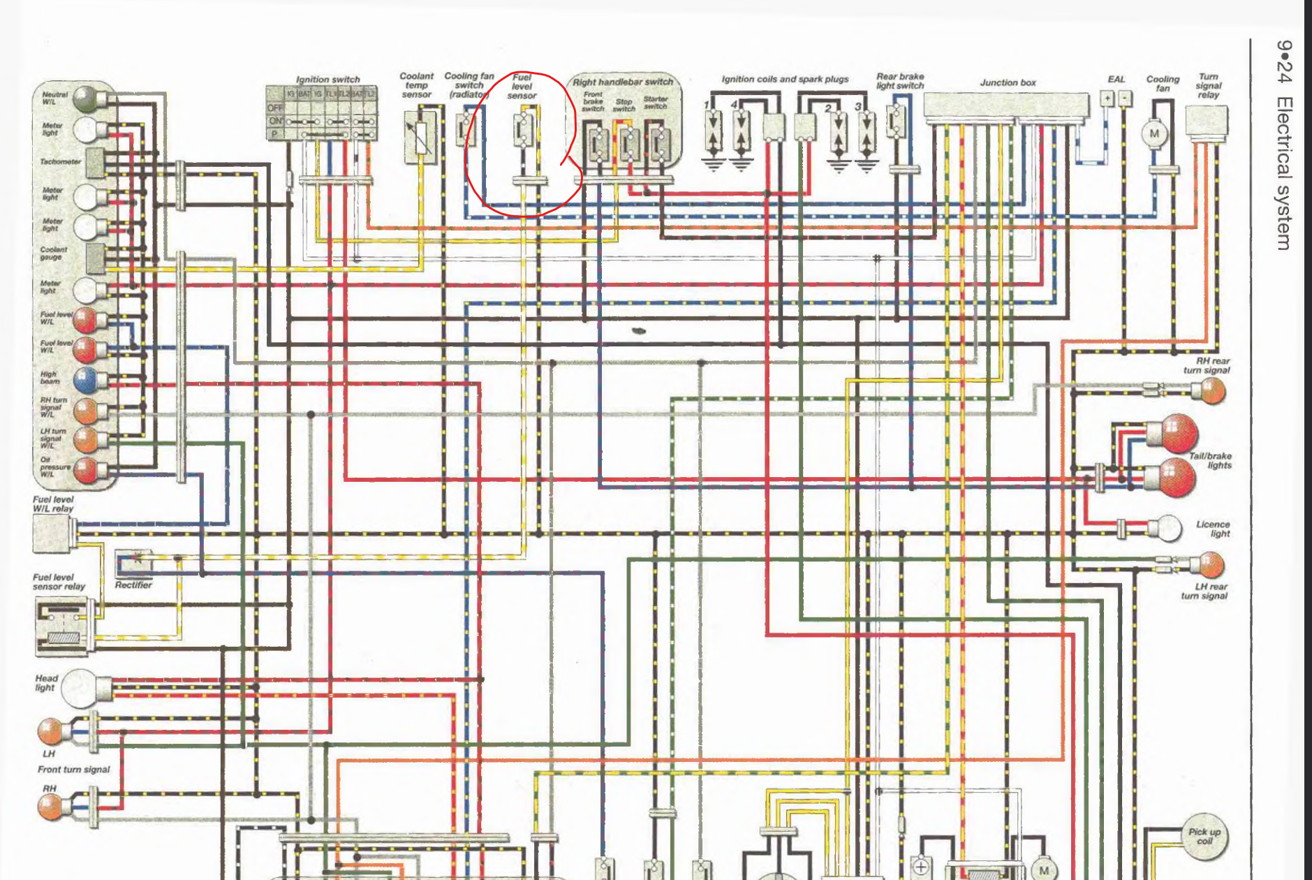

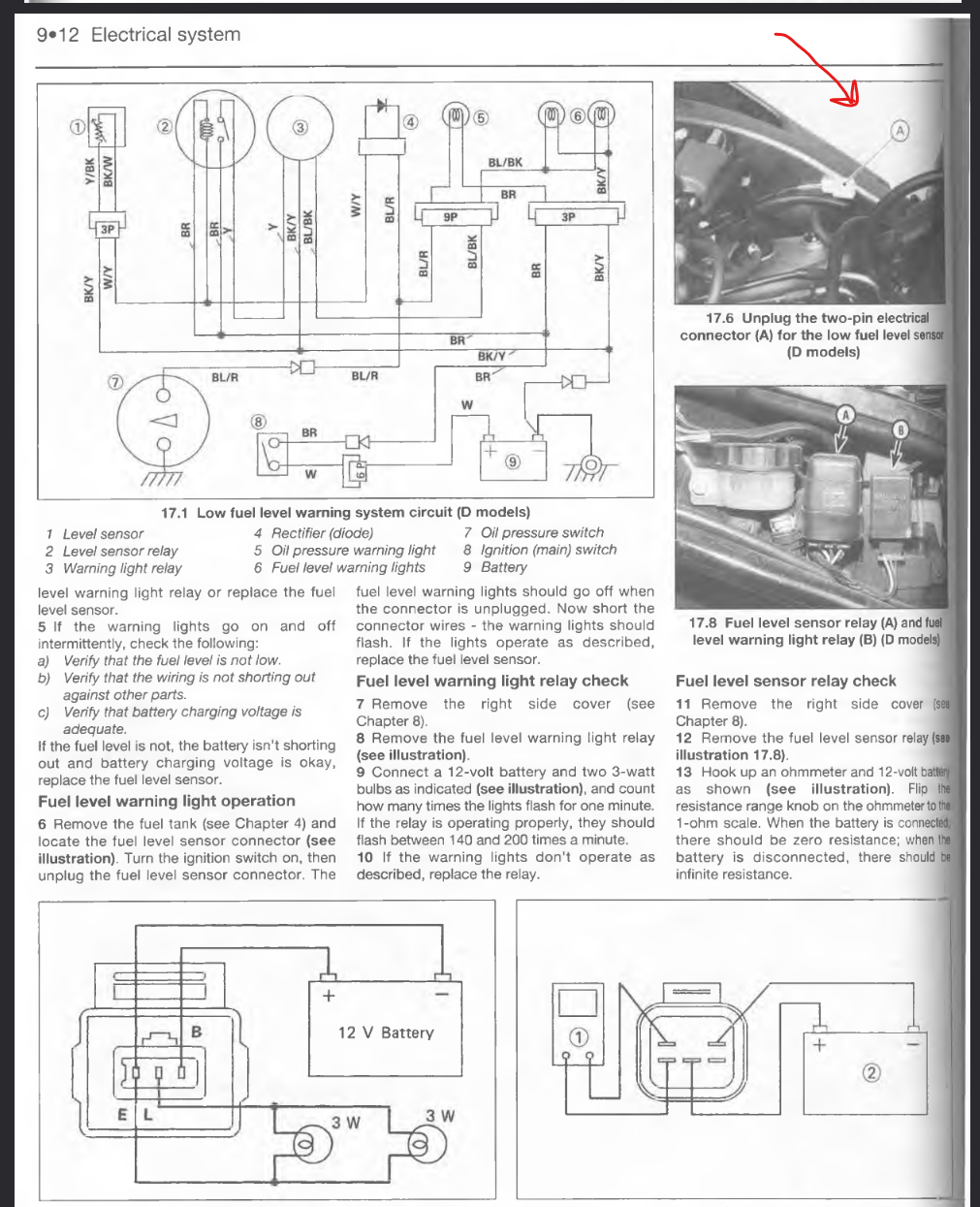

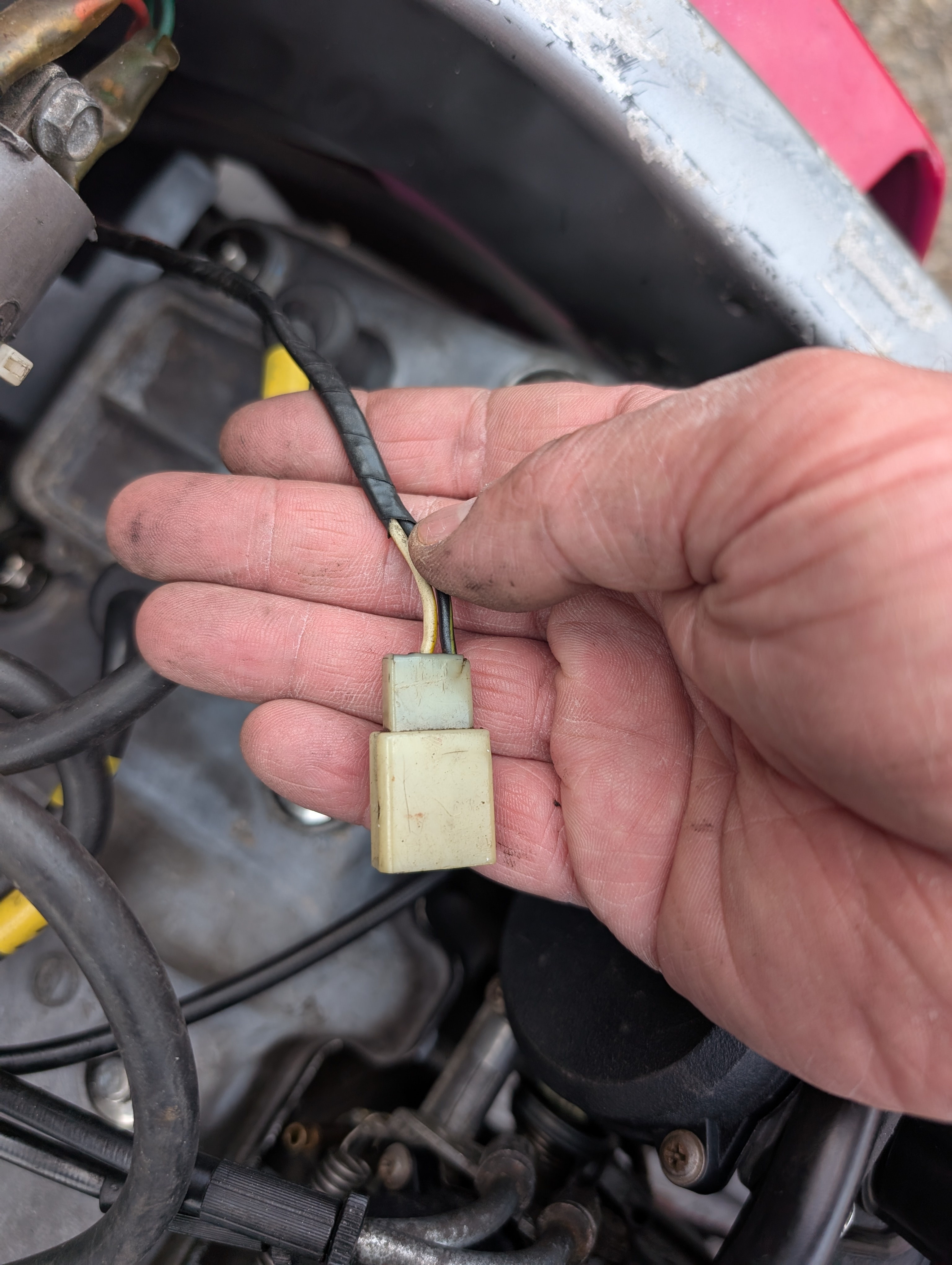

I also need to figure out what this little fella is for. It wasn't connected when I started stripping the bike so god only knows. It lives under the tank, I wonder if it's something to do with the California bikes as they had additional emissions stuff.
I'll grab a multimeter from work and see if I can suss it out.
Getting close :D
Yep, that looks like it! Cheers @haaammit
I sussed out some of the hose palaver too, just need to confirm where the three vacuum hoses on the intakes go. Pretty sure it's the vacuum petcock, will need to confirm.

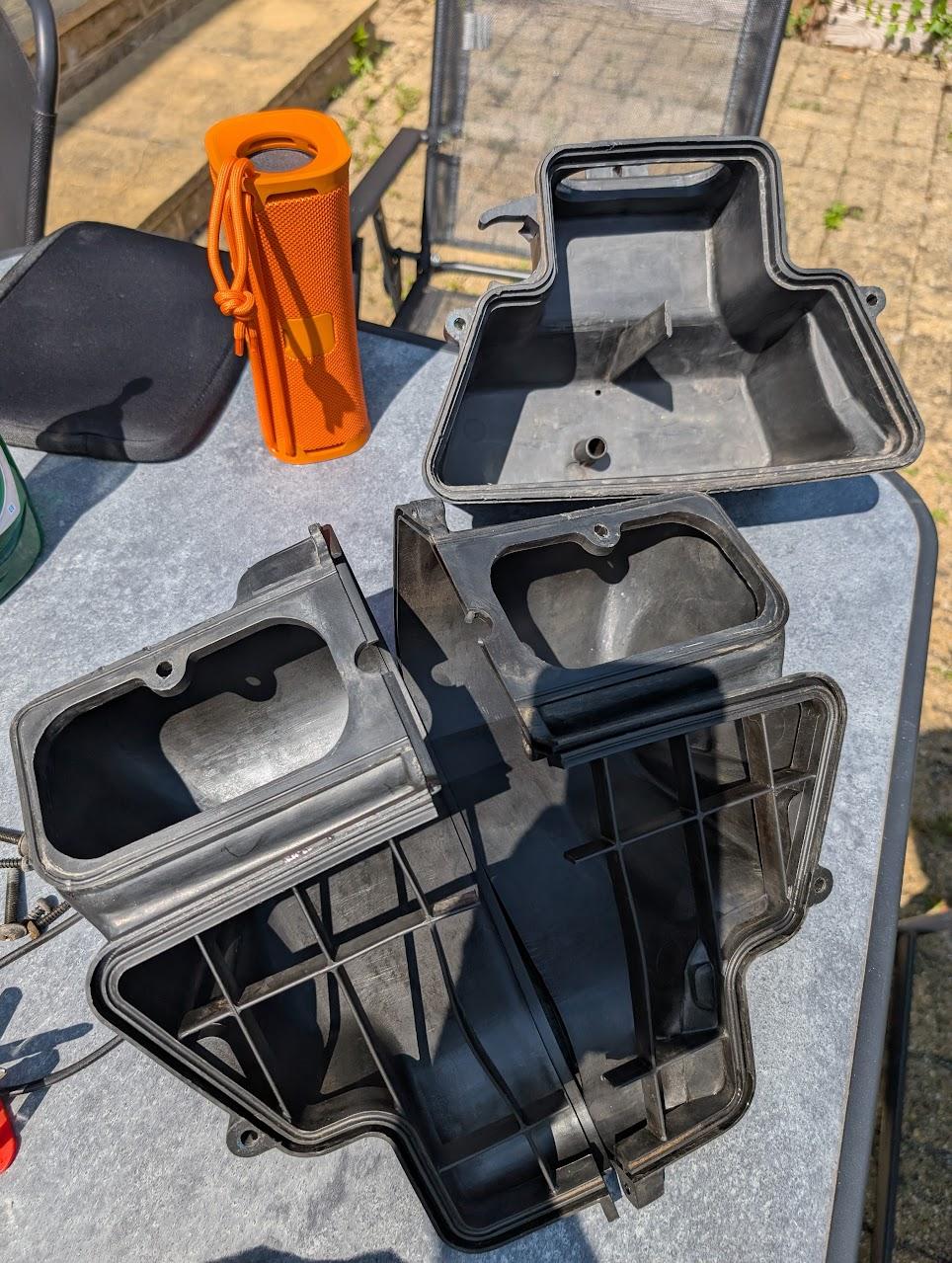

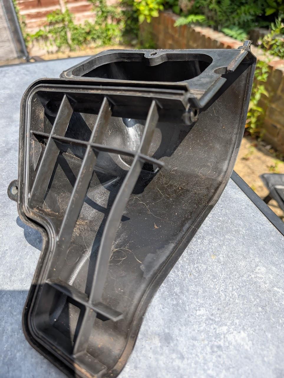

Gave the airbox a thorough clean over the weekend, it was full of mold and cat hair, looked rather tragic!
Before:
After:
All reassembled ready to go back on the bike.

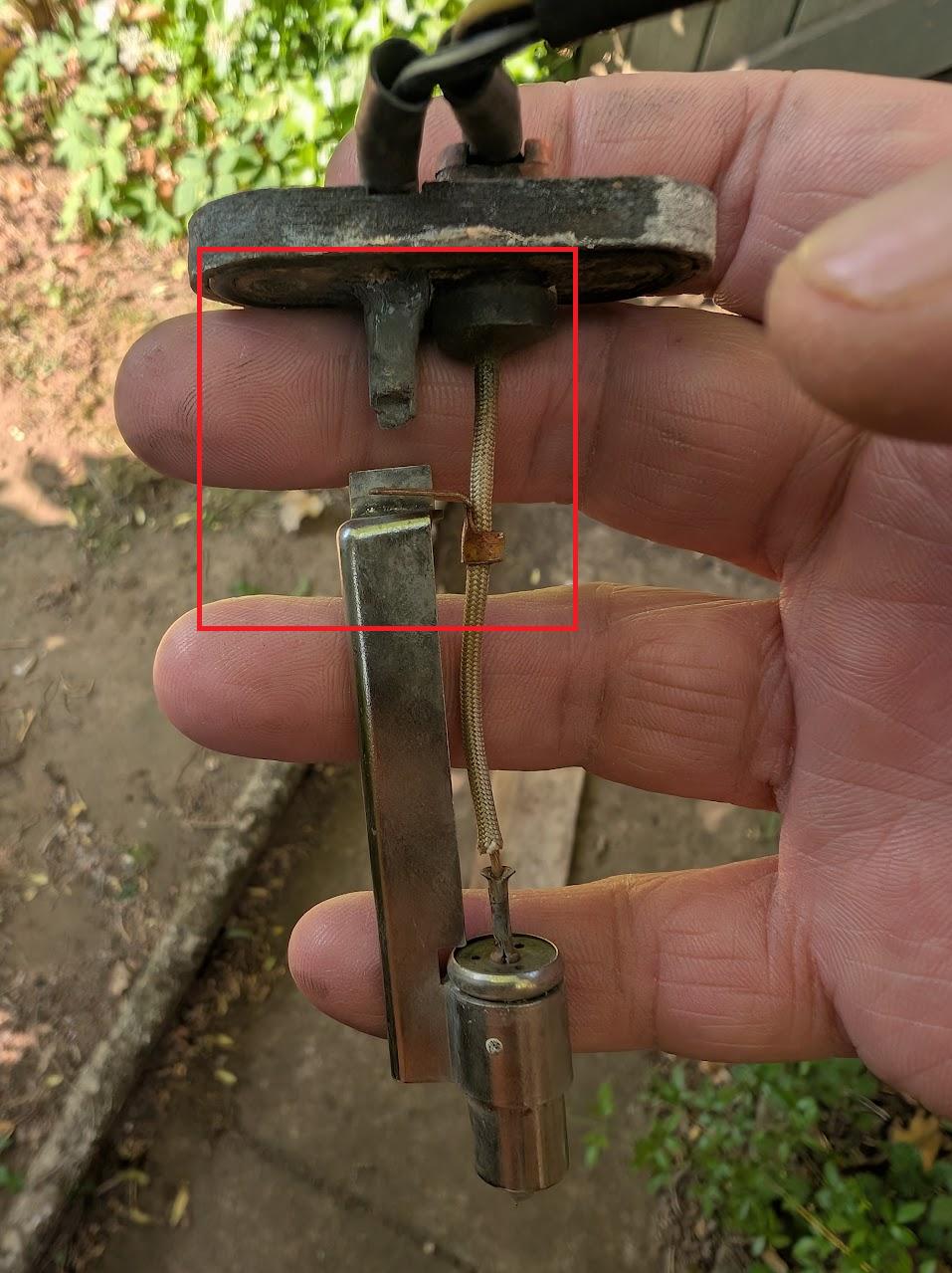

Now the tank. I vinegar'd it again and the results were much better this time, however the vinegar also ate the cap lock and the fuel level sensor, so I ordered a new lock (arrived yesterday) and I need to figure out something with the sensor. The shiny bit here is meant to be screwed to the grey bit, but as you can see the vinegar dissolved some of the grey metal so it needs repairing or replacing. I also relined the tank with Por15 tank sealant, it'll have been setting for 96 hours tomorrow so I'll start reassembling the tank over the weekend hopefully.
How much? £100 for a new sensor. Taking the mickey I reckon, fortunately I remembered we have a full-on machine shop at work, with lathes and mills and all sorts of stuff, and when I told the guys in there that I was reviving and old bike, their response was "aren't we all" :D
I said I'd bring them a box of donuts and a knackered sensor and they'd see what they can do, so that might be an easy fix.

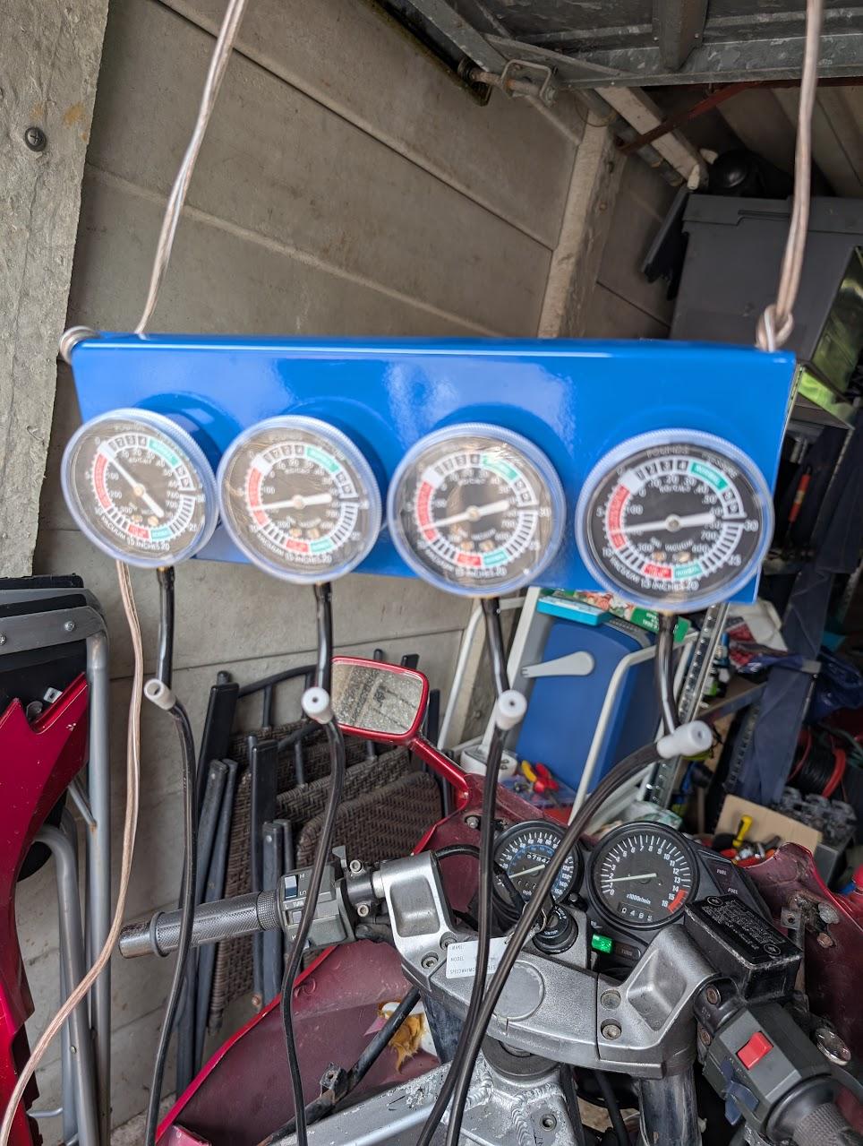

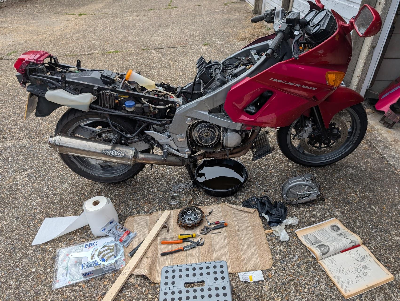

Well, I *think* the engine is ready for the most part:
Carbs balanced:
Engine flushed, oil drained:
Old clutch out:

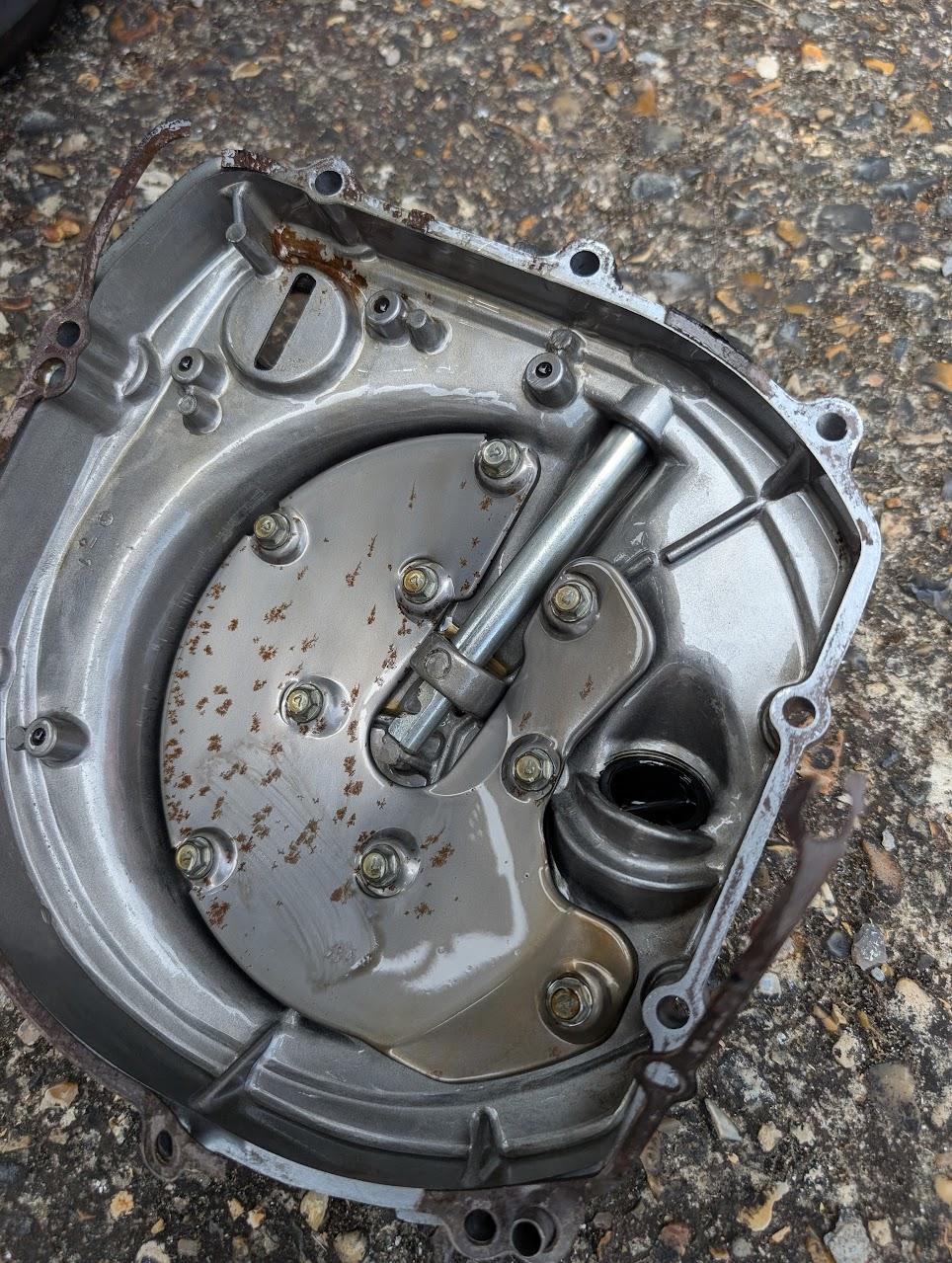

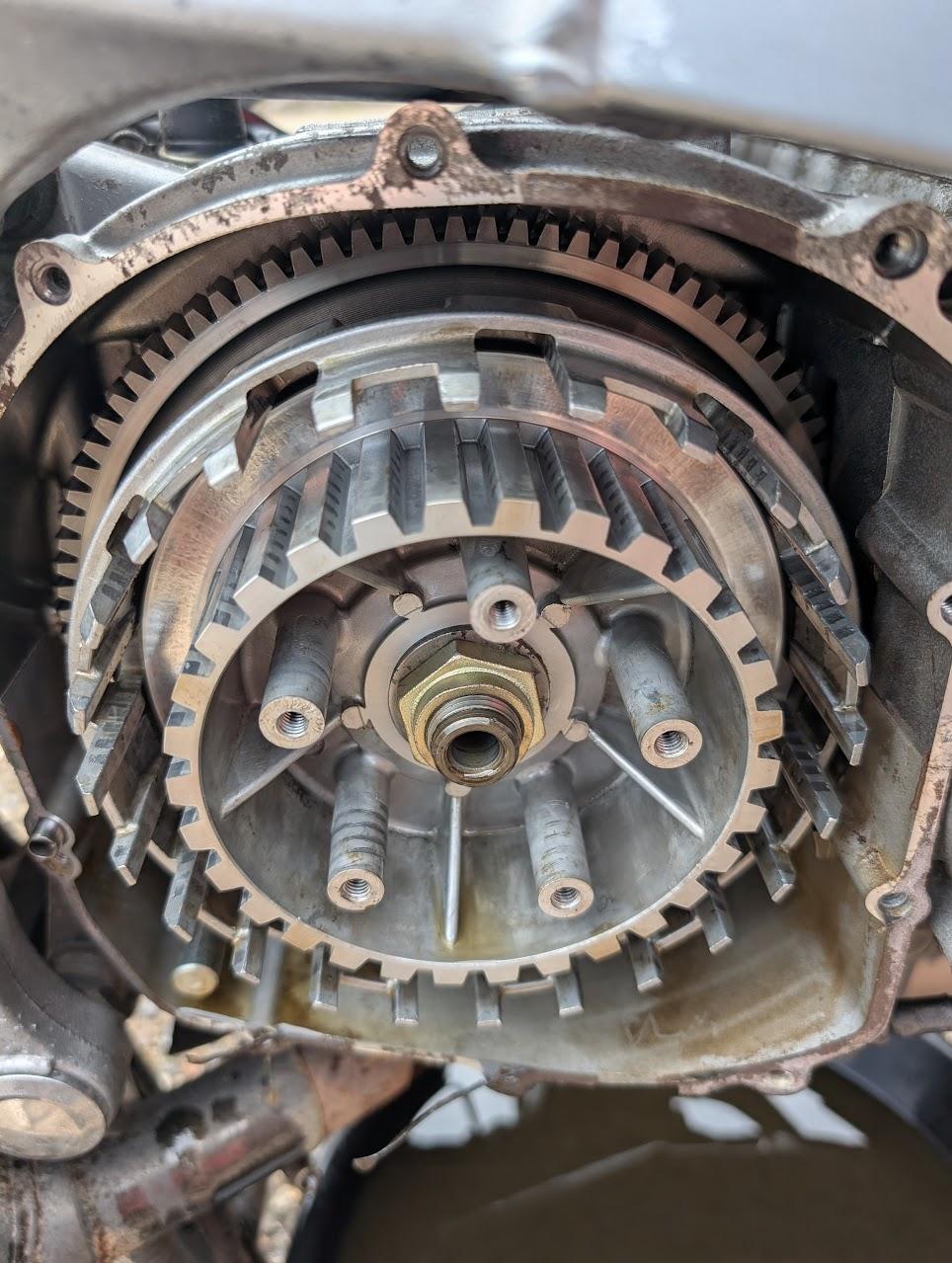

Dunno what these marks are on the inside of this clutch cover, seems harmless enough:
Couldn't get the clutch basket off unfortunately, but had a look and it looks plenty good enough:

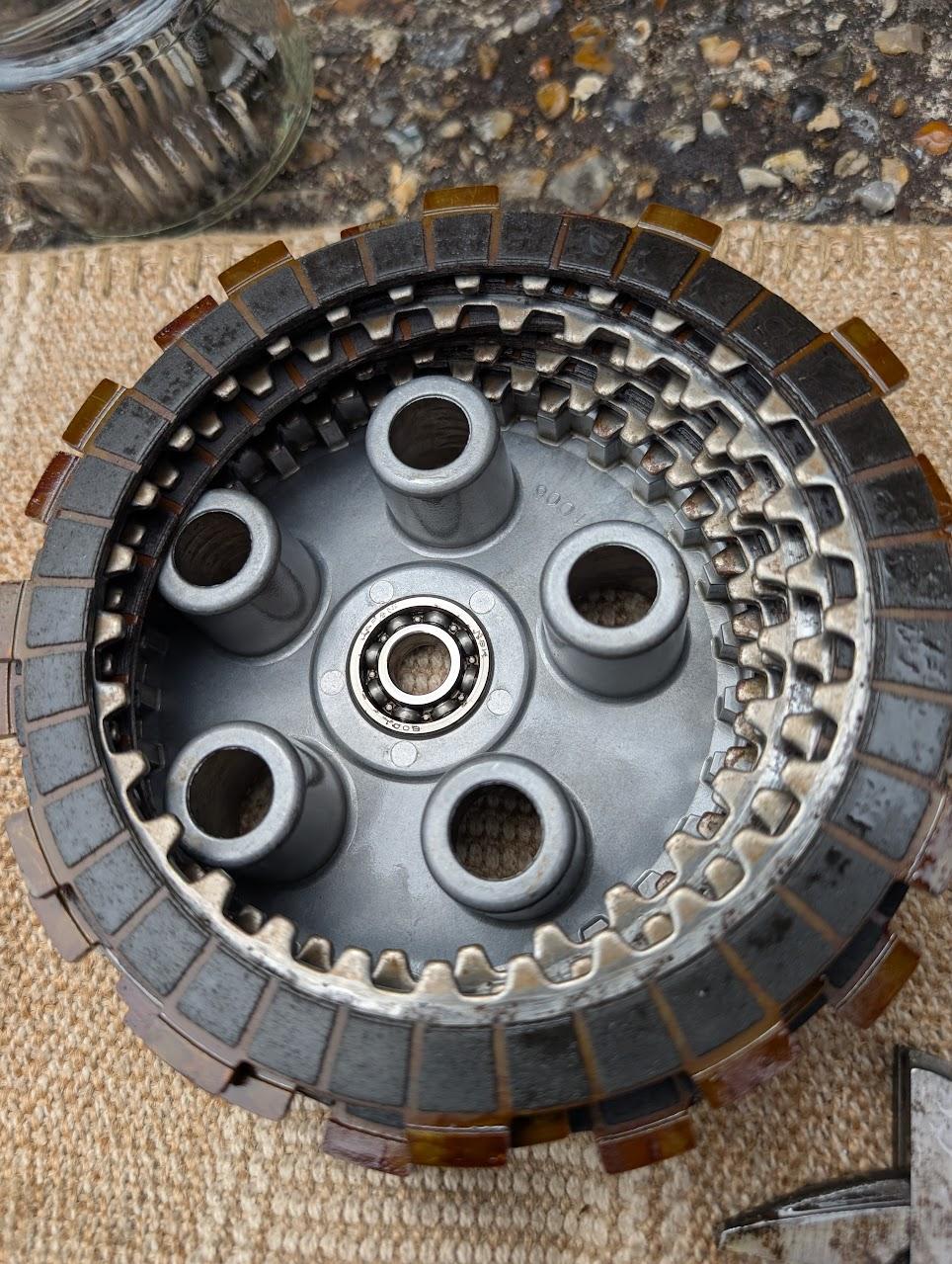

The old clutch plates didn't look too bad tbh:
Random photo midway through all today's work:

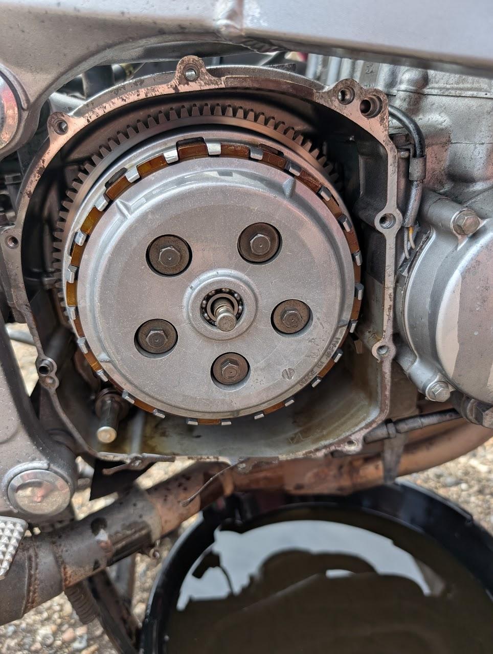

New clutch fitted, new oil and oil filter, and this is the result:

Those marks are rust spots, just wet’n’dry them off
That'll have to happen during the next oil change, I didn't have any to hand and I certainly didn't want the bike standing dry. I figured if that was 35 years of rust, another year should be fine :D

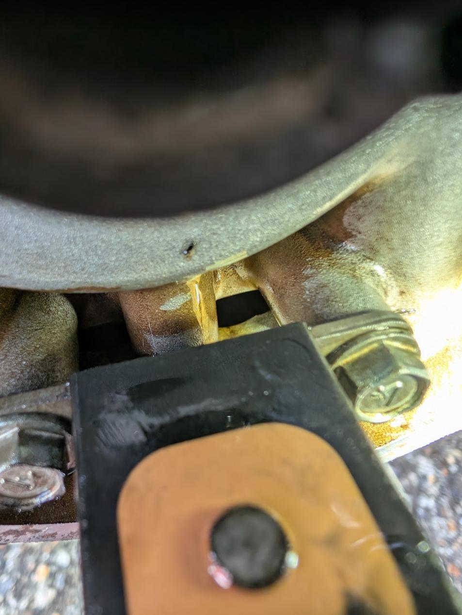

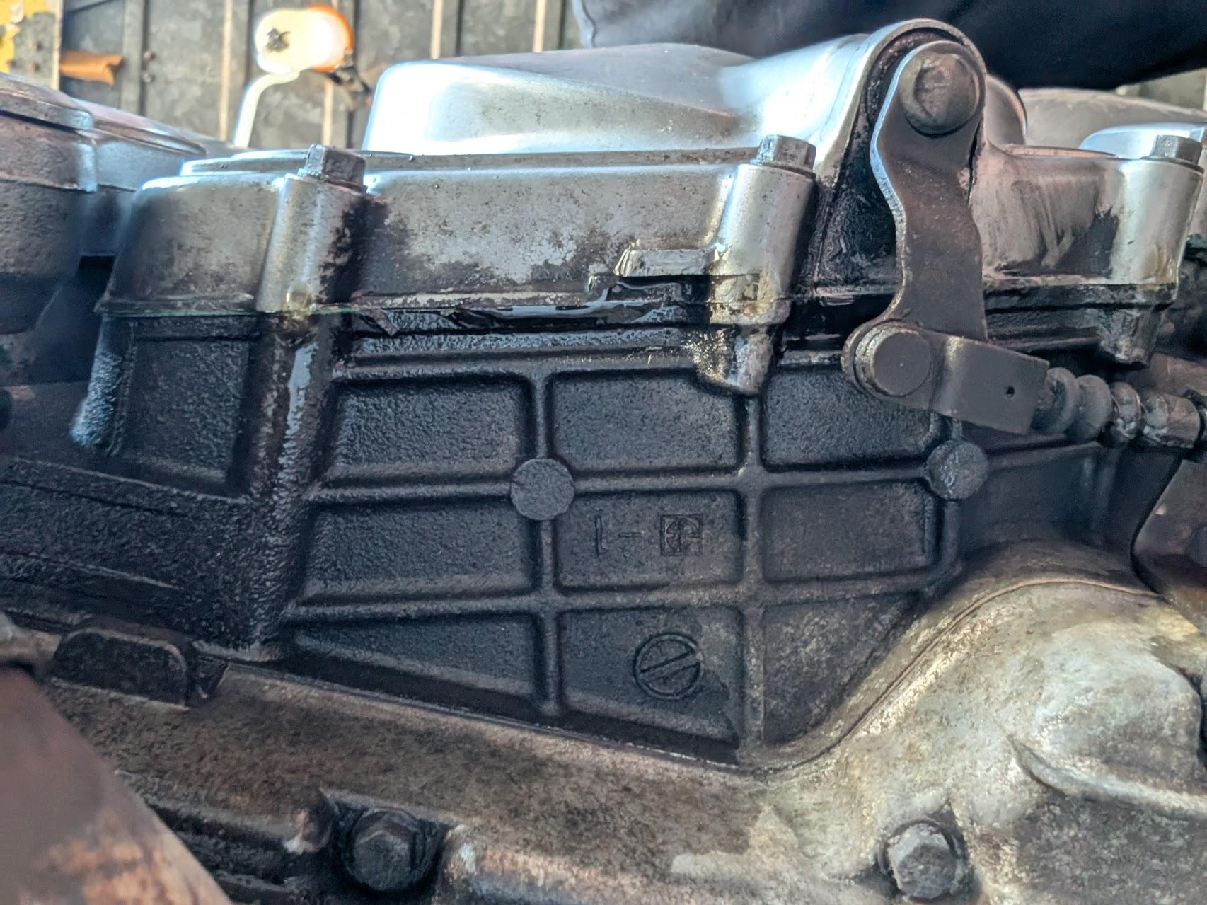

Spoke too soon, it's got an oil leak from that exact gasket :D
Not a major leak, just a tiny drip, but I've never owned a vehicle that leaks oil and I'm not starting now! Will order a new gasket and more oil and do it again.

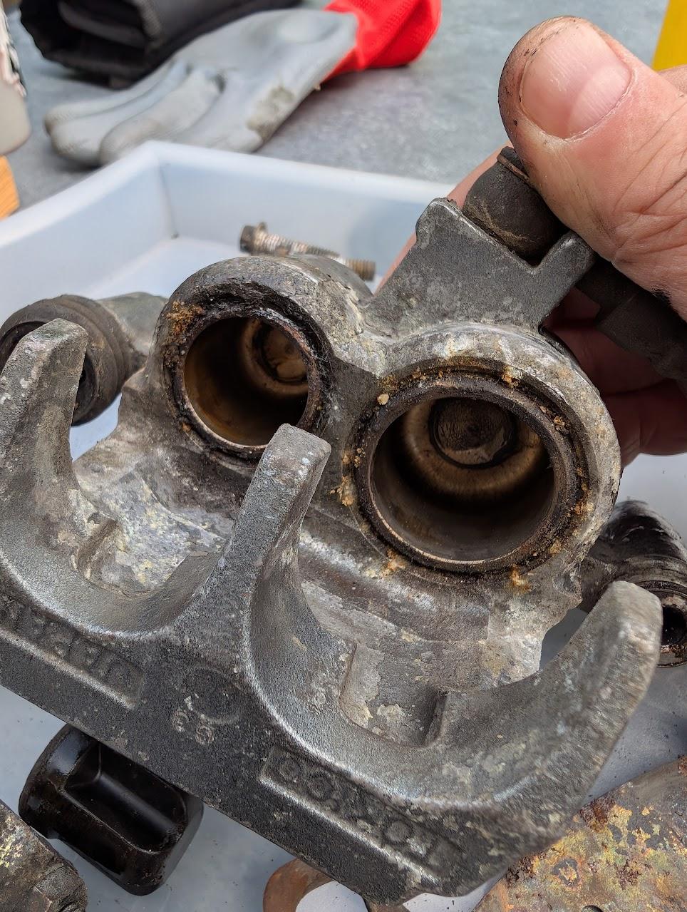

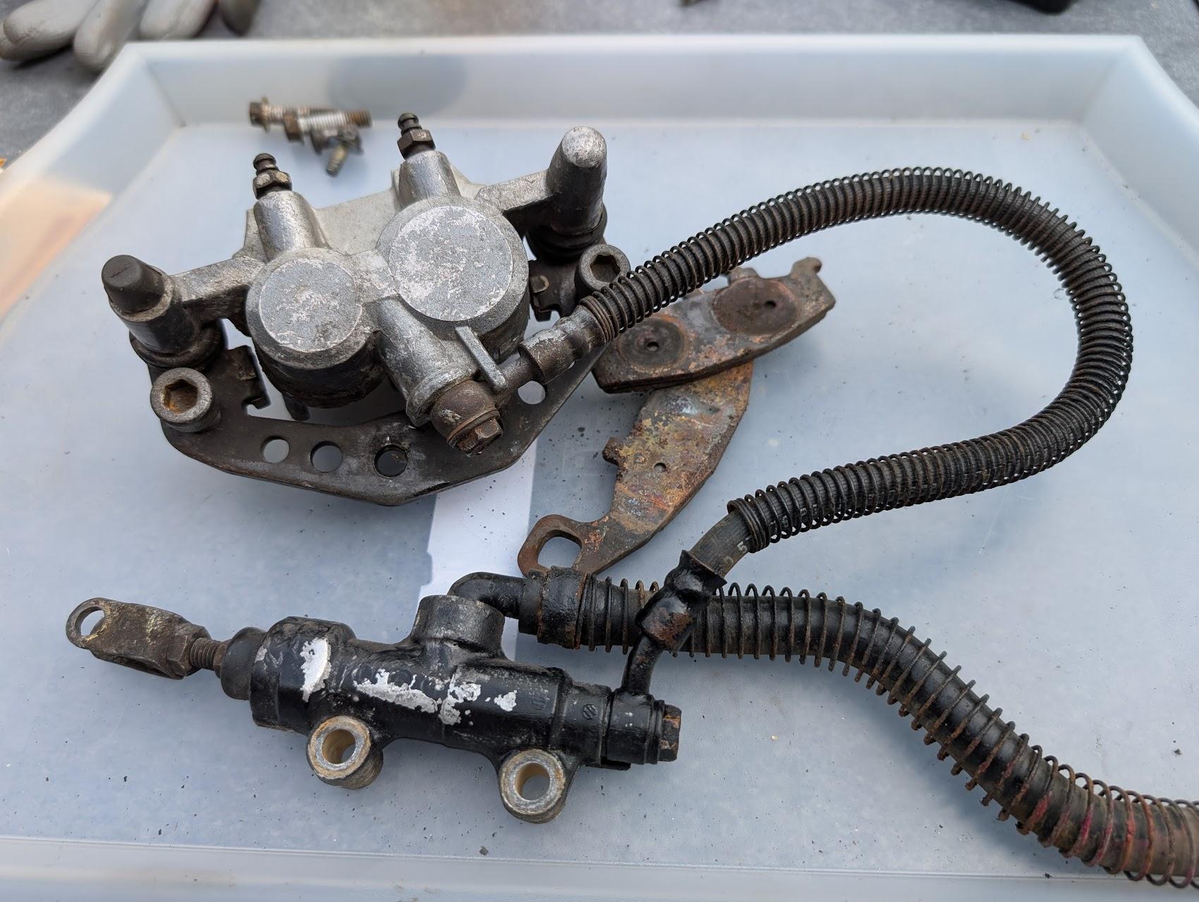

Also removed the back brake assembly to start getting that to work, and, well, I'm not surprised the back brake didin't work :eek:
Given the absolute sorry state of this, I'm going to get quotes for a professional refurb of both the master cylinder and the caliper, I think this bike deserves it tbh.
