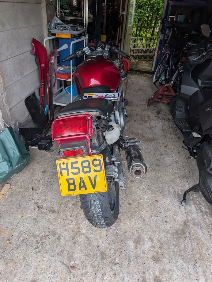

Also got the new tyre fitted to the rear and the wheel balanced. This afternoon I got home a bit early and had some daylight left so took the opportunity to tidy the garage a bit, this is how the bike looks atm:
All being well this weekend I'll be fitting the new chain and sprockets, refitting the rear wheel and starting on the panels.
I could've been done with this ages ago but the idea is to have it mechanically sound, so every time I find something that's even slightly questionable, it gets removed and either rebuilt or replaced. I've given up on the cosmetic side of things for now, once I've got it running and had it out for a blast I'll decide what to do with it.

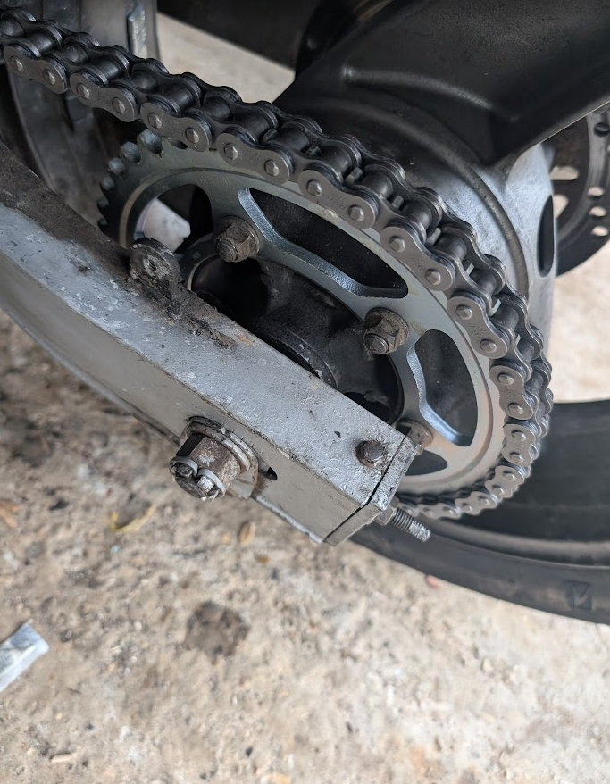

New chain and sprockets fitted. Wheel back on. Aligned and ready to go. Unfortunately I seem to have misplaced the rear brake line, so ordered a new one, it's arriving today.
Unfortunately my ultrasonic cleaner wasn't yet delivered so I just gave everything a rough scrub and shoved it all together. Depending on what I do with this bike, I might strip some bits over winter and properly glam them up, or just flog the thing and start a new project. Will see.

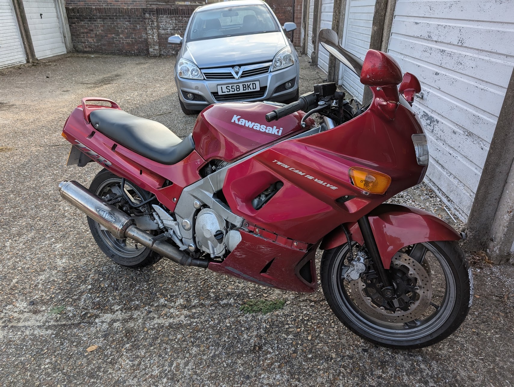

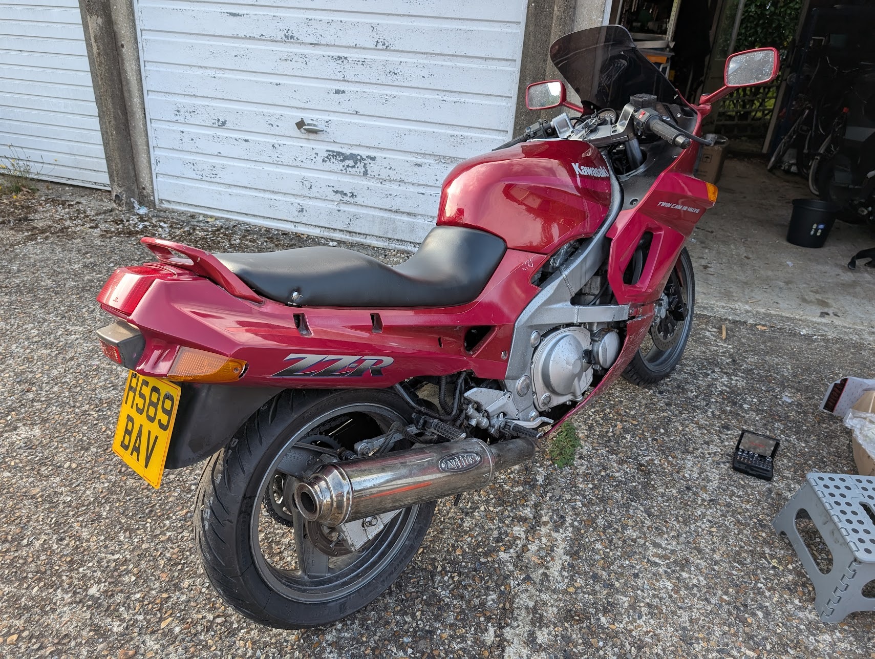

As it stands now:
Fortunately I have quite a few local runways, so I took it for a little spin.
My report:
Firstly, let me get the obvious out the way, this bike still need quite a few little jobs done. The chain clearly stretched a bit as it's obviously brand new, the indicators for some reason flash really fast when the engine is running so that'll also need looking at. The plastics are hilariously badly damaged, so bad I didn't even want to clean them too much as I reckon I'll replace them anyway. As you can see from the sight glass in the picture, mayo in the engine. More on this shortly.
It starts on the button, and that engine is sweet as a peach. It not only hits the 14k redline with ease, but seems to absolutely love going there. Given that all the bikes I've ridden in the last few years are all minty fresh, new bits of kit, there's something genuinely charming about riding a proper old school mechanical machine. No traction control, no ABS, not even an electric choke. Just you and the machine. No safety nets, you screw up and that's it. The tyres are still at tyre-fitting pressure which is way over their rated pressure, and I couldn't adjust this as my local petrol station's compressor doesn't take card, so I'll probably have to wheel out my own compressor tomorrow to get them right. The clutch stuck a few times, nothing major, I think it's just because it's a new clutch / new oil / etc. Only happened a few times and then that was that. As for the mayo, I got the bike up to temperature and then redlined it a few times to really heat the oil up, and the mayo is now gone, so I'm hoping it was just residual moisture in the oil / engine. We'll see.
