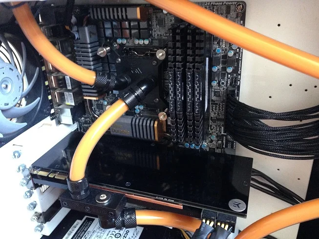

Old PC:
Single Loop:
PA120.3
PA120.2
XSPC D5 Dual Bay Reservoir/Pump Combo V2
EK-LT - Acetal
EK Water Blocks EK-FC Block and Backplate
EK Compression Fittings
Mayhems Pastel - Orange Coolant
Kit
Modded Lian Li G70
Asus ROG SWIFT PG278Q
2600K @ 4.7Ghz
Gigabyte Z68X-UD7-B3
Corsair Vengeance 16GB
MSI Reference GTX980Ti
Asus Xonar DX
1 X Samsung 256GB SSD Pro
1 X Crucial MX200 1TB SSD
OCZ Gold 850w Power Supply

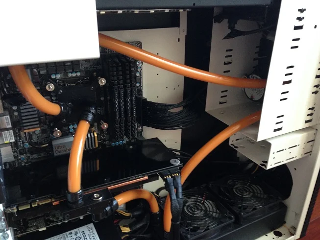

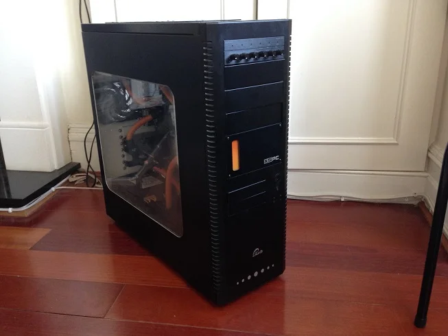

These pictures were taken the last time I put my loop together for the 980Ti launch. Watercooling is very expensive so I typically try and time my upgrades around the nvidia Ti launches. I've run both crossfire and SLI before and if you ask me these setups are more trouble than they are worth - it's also double the cost which can get prohibitive give how expensive GPU full cover blocks are

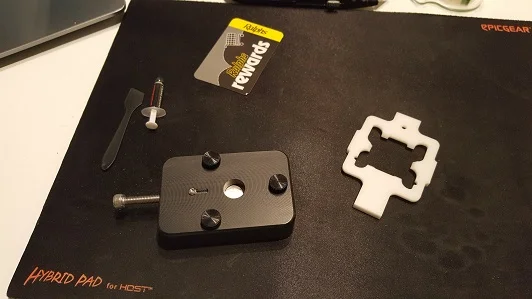

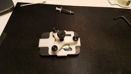

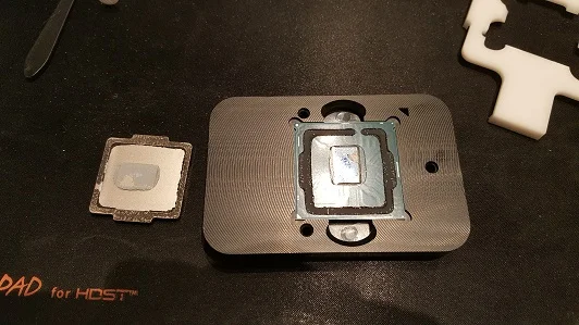

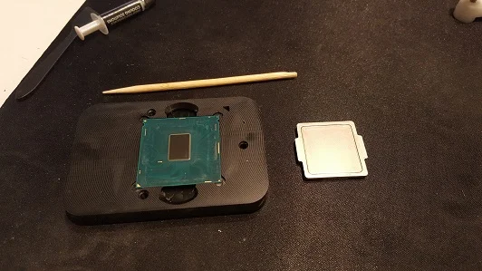

Rockit 88 - Black Body × 1 with Re-Lid Kit - 1150 × 1 (enables you to delid the CPU lid to reapply thermal paste to the internal heat sink improving contact and reducing temps)

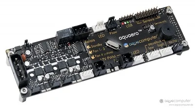

Been researching fan and pump controllers tonight and mechanisms to monitor my loop temperature. It's been a while since I've looked at this but one brand keeps coming up in the forums; Aquacomputer Aquaero. I want to move away from my existing fan controller to something more hidden and found the Aquacomputer Aquaero 5LT to be highly recommended. To monitor temps I'm looking at a Alphacool Eiszapfen Temperature Sensor which should screw into the port on my XSPC D5 Bay Res. Here's a pic of the controller.
I did look at other internal fan controllers but none of them seemed to offer the level of software control that Aquaero does. Let me know guys if you disagree or have any additional thoughts - given build day is on Friday this will likely be an addition after I have the build setup but it's something I've wanted to do for a while given Los Angeles can get pretty warm.

Hello mate!! That sounds rough regarding your block. I'm assuming your block was defective. Reason why I want to alphacool is that I was interested in the software. Does the device you linked work with a PWM pump?
Few packages arrived over the week but I'm unfortunately short a CPU :( It should come tomorrow but it's put the build back a little.
It's got it's own power drawn from sata power so I guess it probably would, but it only takes one pmw input so it's more suited to turning one CPU fan output into many (upto 11 apparently) rad fans using the motherboard's temperature probe and fan profile settings. I've just got my D5 pumps on the lowest flow settings at the moment.
I see the Swifttech version is also pretty popular. http://www.swiftech.com/8-WayPWMsplitter-sata.aspx
I think this one also supports PWM control of pumps
Looks like it's basically the same thing. One input from PWM CPU motherboard output and drives multiple fans using sata power. You couldn't use either to run pumps and fans at different speeds.
That's what I'm thinking. The Aquaero seems like the best solution on the market. I'll try and get on discord if/when my new PC is up. Do you still game on Sundays?

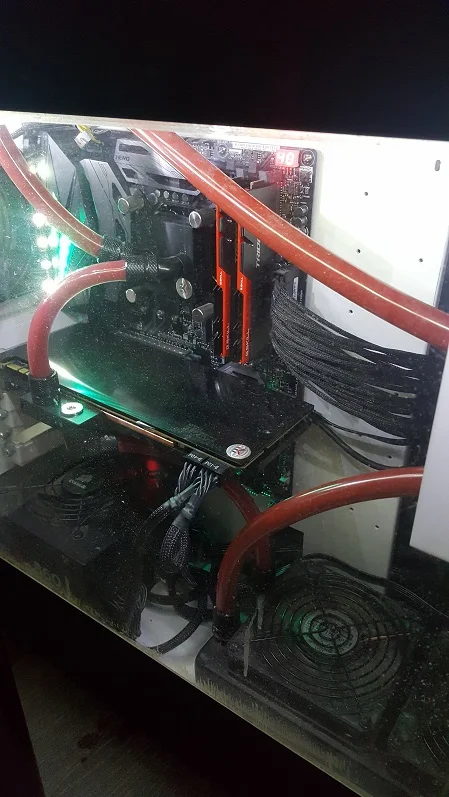

Build time! It's getting late here (had to wait for the CPU to arrive) so I'll try and get the CPU and GPU prepped tonight and do the rest of the cleaning, install and loop tomorrow morning.

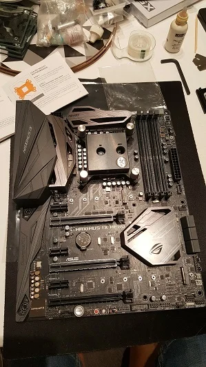

Installed the CPU block. Compared to my previous LT block I found the instructions to be lacking a little. I.e., the plates you have to install are not marked so you have to guess regarding thickness. The screws which you install for LGA 1511 are also not clearly differentiated from the other screws. Other than that it was fine and not that different from any other install
