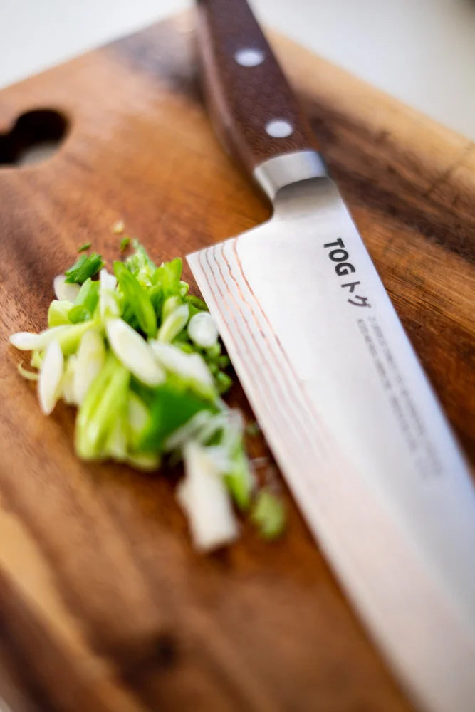

Surely you have to get another TOG.
I don'twantneed to spend that much, and the TOG I got on sale for like £80? Bargain considering it's £240 retail.
