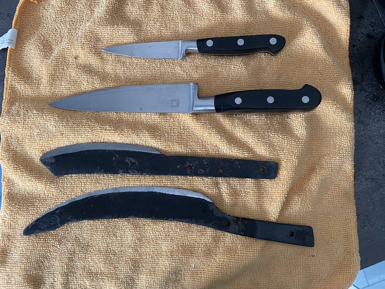

Made a thing.. a carbon steel kitchen knife.
Next steps will to be to do the final cook and cool down to soften the blade, give it a final clean up, fit a wood handle and then sharpen.
Here's the current state of the knives following their oil quench and initial sharpen.
The small one is mine, the long psyco murder-she-wrote kitchen knife is Her knife. Mine is a little combo mini-cleaver (has some weight) but at the same time has an edge to cut veggies, skin and cut meat. Hers is more akin to a large chef slicing/boning knife but not as thin as a boning knife.

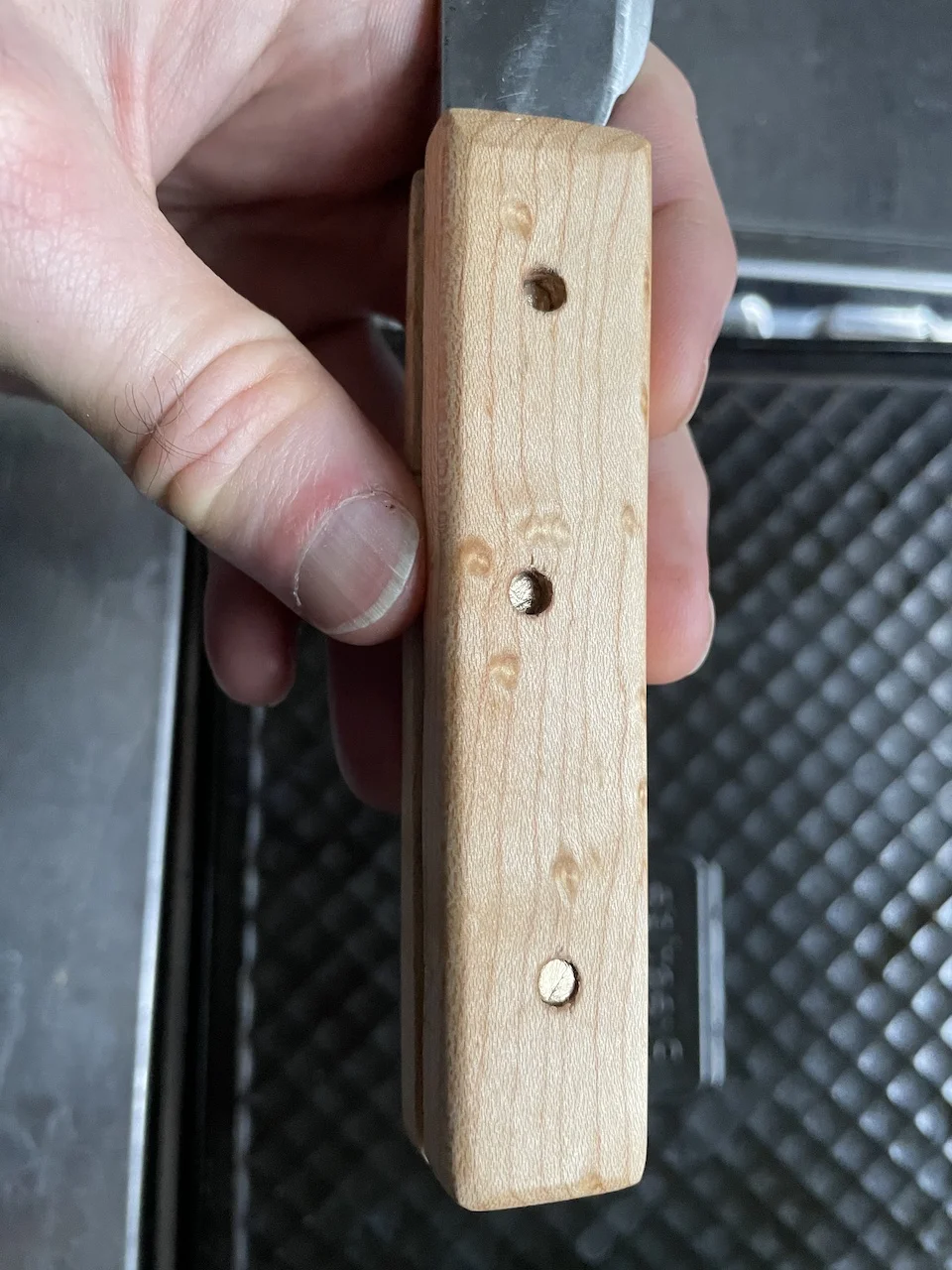

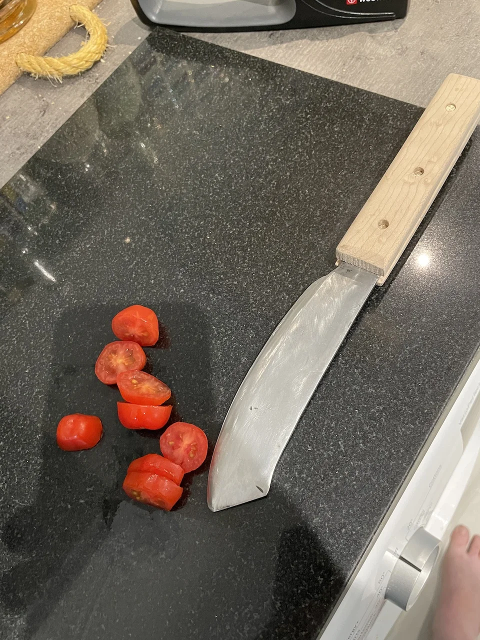

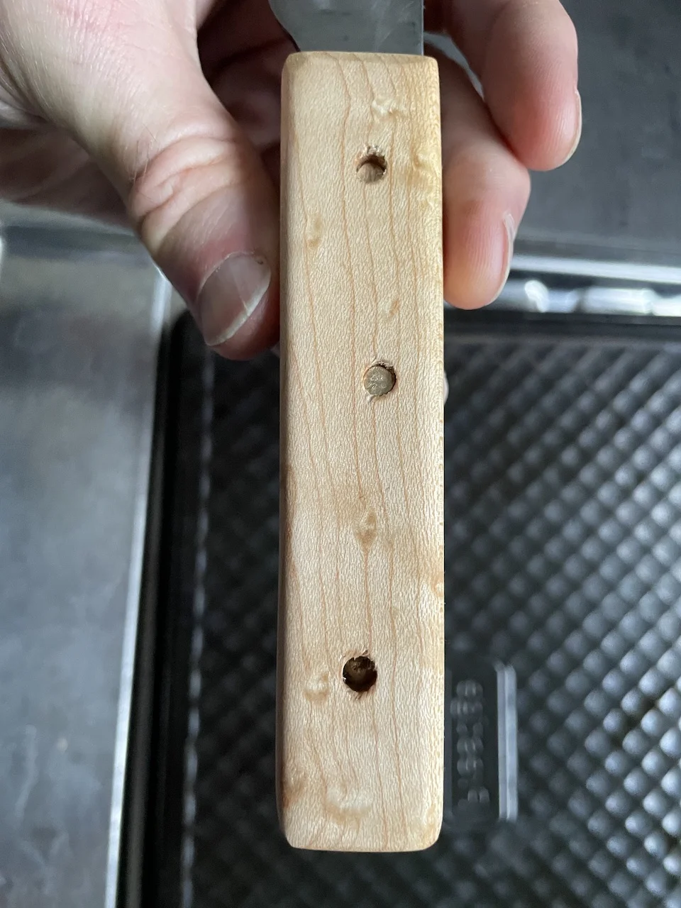

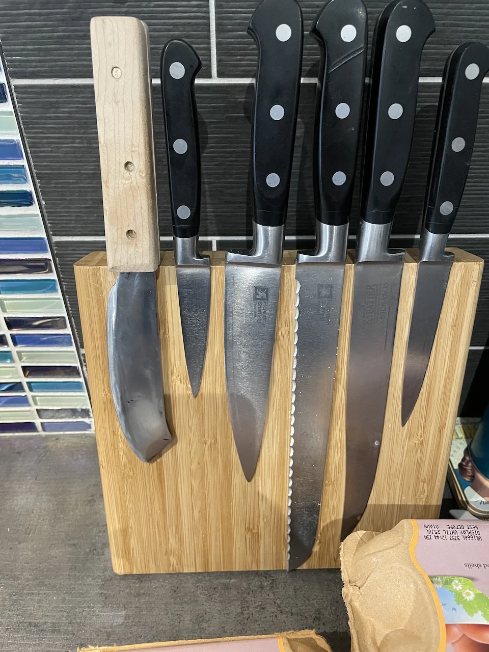

So the chunk of hot metal that you saw me dunking - it was raining today (couldn't do the grouting on the path) so I shaped the handle (Birds Eye maple), cleaned up the blade and sharpened it.
Still got a little work todo but it's useable :D Carbon Steel vs the other knives stainless.
I designed it as a bit of a heavy blade - basically as you can do basically everything with a sharp chopper.. this is is like a mini chopper. Pleasantly weighted which surprised me.
Hmm .. just going to check, I think the mrs has has put back what looks like dirty knives.. :(

So the handle is Birds Eye Maple, which is interesting - it should get a lovely flaming and eye effect once the handle matures a little. It's also odd that when you sand through it, the positions of the birds eyes change, so you can't really say exactly how it will turn out. Some mineral oil will make it pop out (at the moment the blade has some veggie oil on until I can order some. The wood also varies in hardness so you get bits that are hard and then suddenly bits that are softer that you can cut through easier.
The blade has all the quenching oil residue removed, which is an ***** to remove by sanding it off.
P600 grit paper then 1200 grit paper used to get all the original grind marks out which too blinking ages by hand.
I tried to use my old stone to sharpen and hone the blade but that really only got it close, the 1200 paper got it really starting to feel sharp and then I used the ceramic edge of the sharpener to bring it up to cutting - I need to get a proper 8/12000 grit stone. What is nice is you see all the little bits of carbon steel flake when you sharpen (not large chunks but you can see it).
Pins are brass, but currently they're not fully secured (tight but not hammered out).
