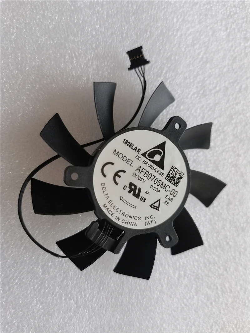

Just purchased second hand 38GL950G-B for 380 €. Otherwise in perfect condition, but the fan makes pitchy noise. As far as I gathered by briefly scrolling the thread, the fan that mostly ever spins is the normal axial flow fan, which is 5V and PWM. The connector looks quite easy to work with from the pictures to connect a standar 4-pin PC PWM fan. Noctua does seem to have several 5V PWM alternatives in nearby sizes relative to the original fan.
So far it seems that the most difficult part would be
removing the back cover nice and clean. Any quides, advices and tips out there how to do it, eg. where to start applying prongs and force, technique etc.? Would very much appreciate it. I could share my results of the project here.
So the plan is to replace the thermal paste of the fan heatsink with higher quality alternative and also do the same for the thermal pads. After that replace the main fan with as wide Noctua model as possible to fit. I also want to disconnet the LED lights and leave them that way, since they do have a lit startup cycle even though they are set off.
There is a Youtube video that shows the location of the back panel clips after opening, but otherwise doesn't offer much practical help of the process.
1. remove the 4 screws in the vesa mount2. start prying at the bottom two notches3. hope you dont break any clips in the process...
