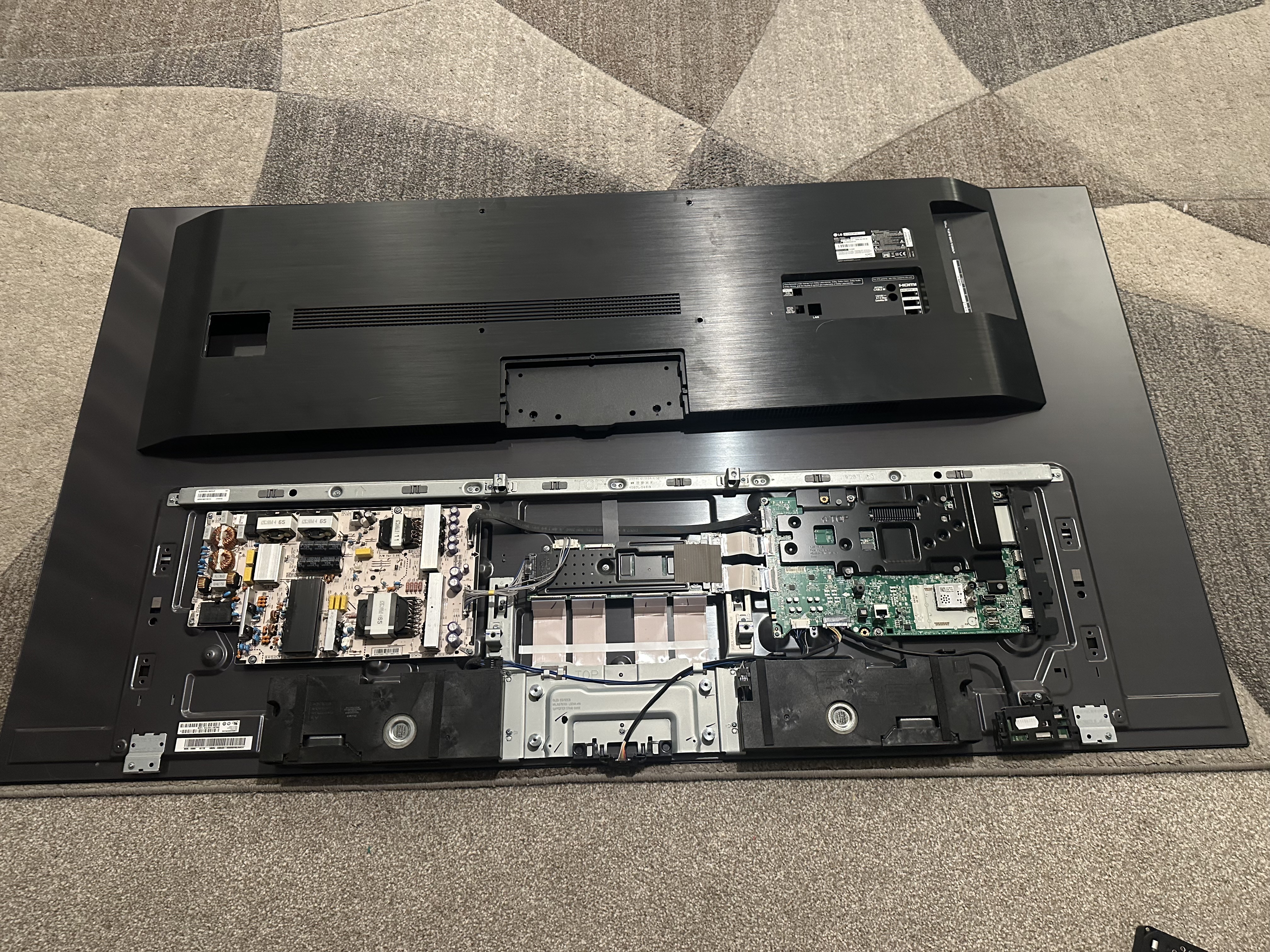

I'm getting what I suspect is a power supply failure on my 65C9. Often when turning on the TV, the red led will flash and the the normal click can be heard several times before it turns on, on worse occasions it wont turn on at all and needs the power turned off at the wall for a minute before it will turn on.
Struggling to find a replacement power board though, and there's basically nothing I can find online about repairing it. I can happily swap out bad capacitors which certainly sounds like the issue. But the lack of information about it seems odd. I can find drabs of information about other models but virtually nothing on the C9. I'll keep an eye out on ebay for a week weeks and see if one turns up. But I may end up having to dismantle it and order some capacitors in if none turn up.
Anyone here repaired or replaced the power supply on their C9?

No but replacing it is easy, watched the LG techs replace them and it looks easy enough.
If you can buy one?
LG probably refuse to sell parts direct would be my guess, only dealing with authorised repair centers (then charging you arm and a leg)
Yep I would imagine so. But even struggling to pick up a second hand part currently.
I was just quite surprised to not find a post somewhere of someone saying they have repaired one.
I'd suggest having a look at the board and searching for the board code. It's often down to search terms, annoyingly. But that said, you might find the issue just looking at the board. I wouldn't assume so as it sounds intermittent but... Worth a check.
Did you buy your TV from richer sounds by any chance
I didn't, PRC Direct.
I found a part number of EAY65170411, but that brings up minimal results.

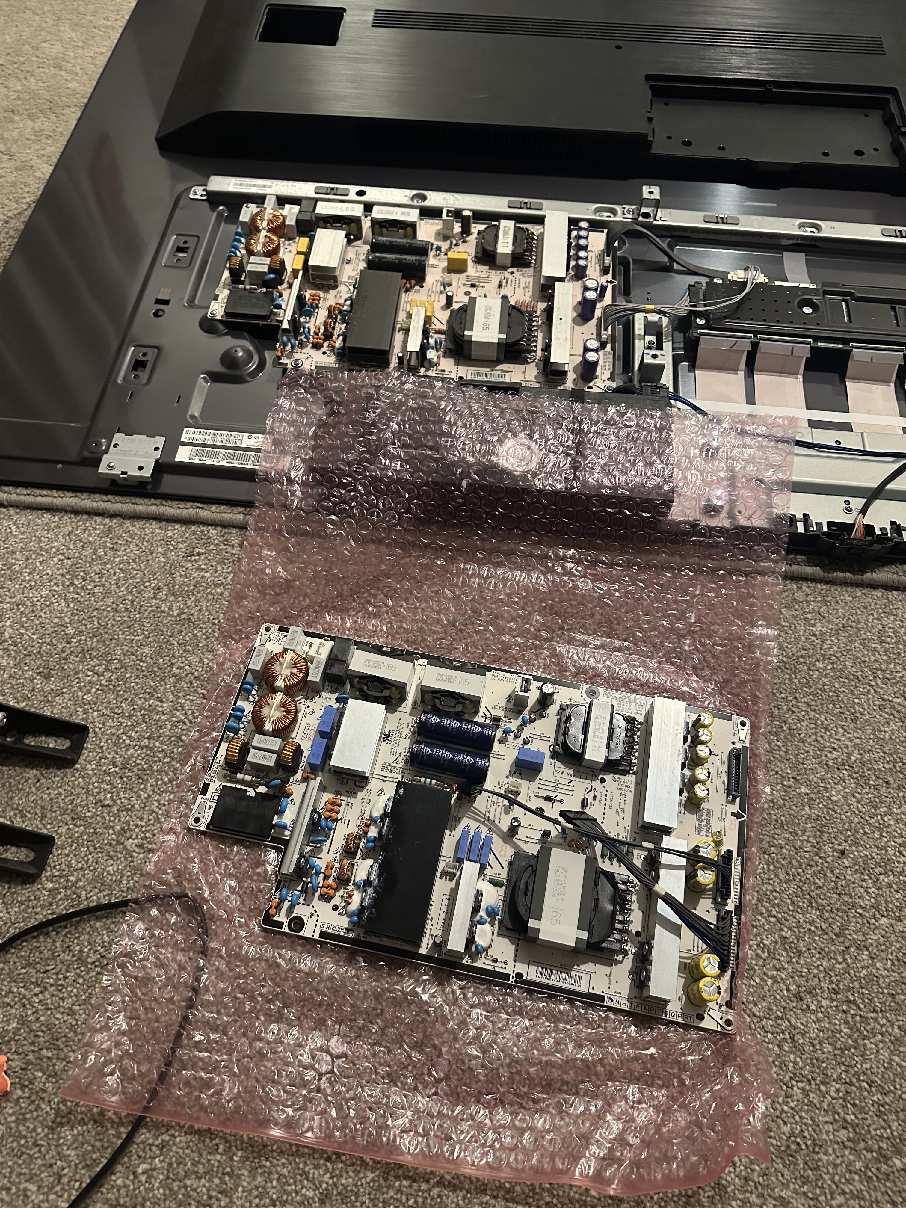

Issue with my TV soon got worse, to the point where it would only turn on after being power cycled at the wall. Ordered a replacement PSU, which two weeks later finally came from France today. Nice easy job to change, looks to be a slightly later PSU than mine was. It has 3 outputs rather than 2 that my old one had, but came with the required cables to make that swap. Couldn't see any evidence of a fault on the old PSU on the sirface, so bulging caps or skid marks from a failure.
So far so good, for preliminiary testing. Time will tell though :)
