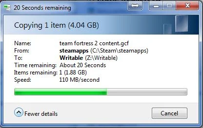

My gigabit network will transfer files at speeds like Zarf's image.
I have a pair of raided 1.5gb drives in my shuttle under the TV and an SSD and two raided 500gb drives in my PC. It's nice having a gigabit network as my bottleneck :D
I've occasionally seen marginally above 120 which is impressive as I would have thought there would be overhead stopping that.
