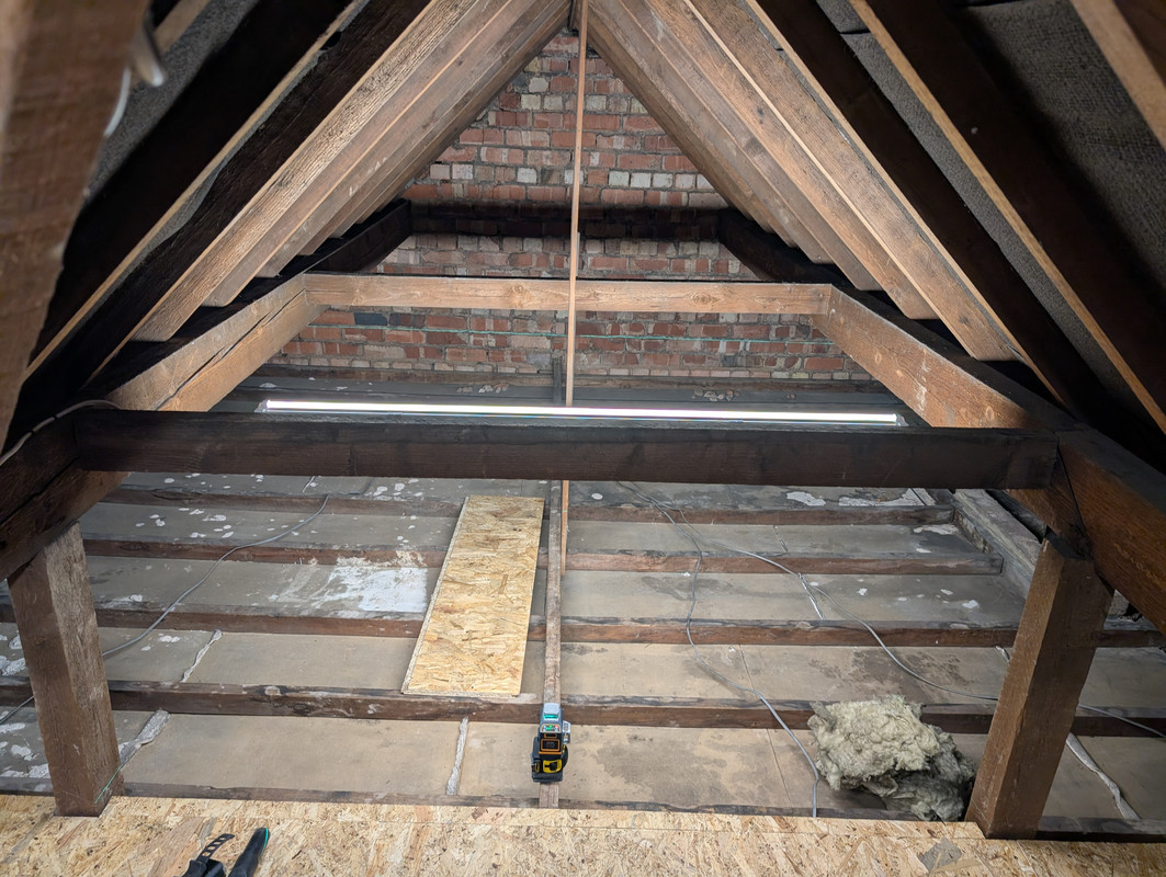

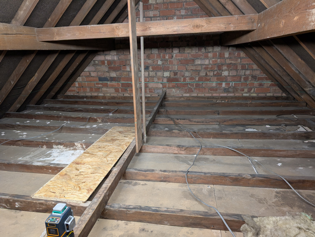

Im having second thoughts about this last section. Ive cleared it all and hoovered out another 4 Henry hoover bags full of soot and debris, found and disposed of another old wasp nest and found another small hole to patch in the roofing felt. The wiring is fine. So its been worthwhile clearing it to clear up and inspect it.
But Im not sure about framing and flooring it. I'd have to attach a ledger beam to that far wall in the picture (the green laser level line marks the position) and then span back to where Im sitting taking the photo.
7x2 attached to the wall with resin fixings (picked that size to ensure I cover 2 full bricks in height to make sure I can get the resin fixings central in the brick).
6x2 spanning back to my position.
And Im a bit concerned about it because that gable end wall isn't very straight or well built. The mortar is like dust. And it sits above a bay window opening that is probably supported by some wooden beams which I can't confirm the dimensions of. It can probably take the load, there must already be 2 ton of brick wall there. Its just whether I disturb things by trying to make the resin fixings and get the ledger in place.
I don't know why but Im more scared/nervous of this section than I was for the whole rest of it. Its a big ledger board (3.6m 7x2) and a big span back to me with 6x2 (also about 3.6m).
Great updates these, and looks like you're doing a proper job as well, hoovering all the old rubbish up (exactly what I'd do). The new loft space looks fantastic, looking forward to future updates
what about,
fully insulate it back to where it should be
add a layer of board to the higher section at the front (ie closest to you)
It looks like its very low anyway once you raise the floor so you need to limbo into it?
You get an area thats easy to use for say smaller items or xmas tree that sort of thing and you keep all the rest of the area you have for the larger and heavier stuff
Can't you just loft legs the last bit? Saves you faffing with the wall/fixings question.
There's nothing to attach another row or two of boards to without spanning all the way to the back with joists.
No chance. The ceiling joists here are already dished over 2" lower in the middle compared to the sides. No way I can load it more and if I did the new floor would be dished too. Can't really see it from the room underneath but it's very noticable looking in the loft.
If you need the loft space then do it now while you're prepared.
If you don't need the loft space then just put insulation over it, you've done a great job already!
