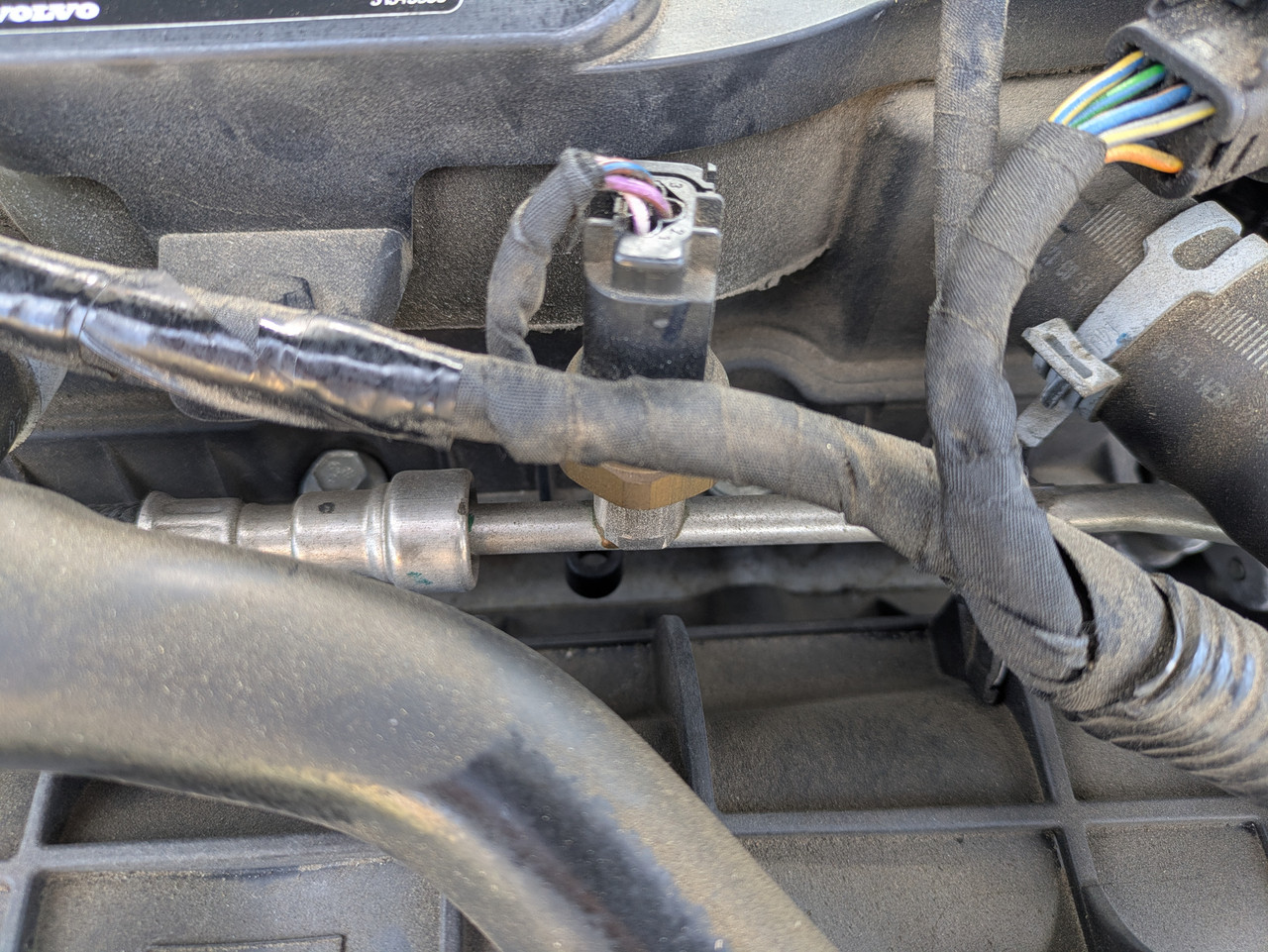

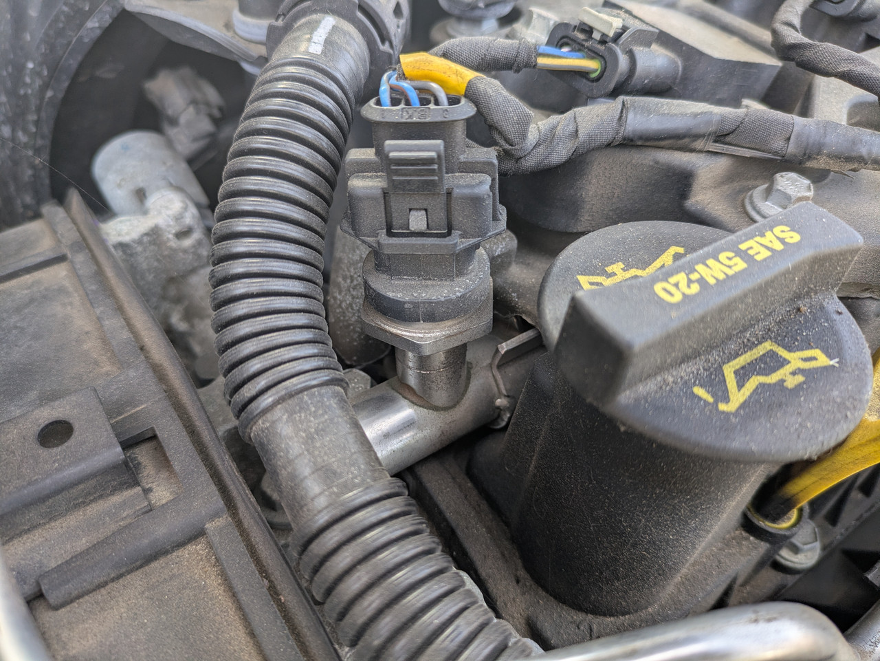

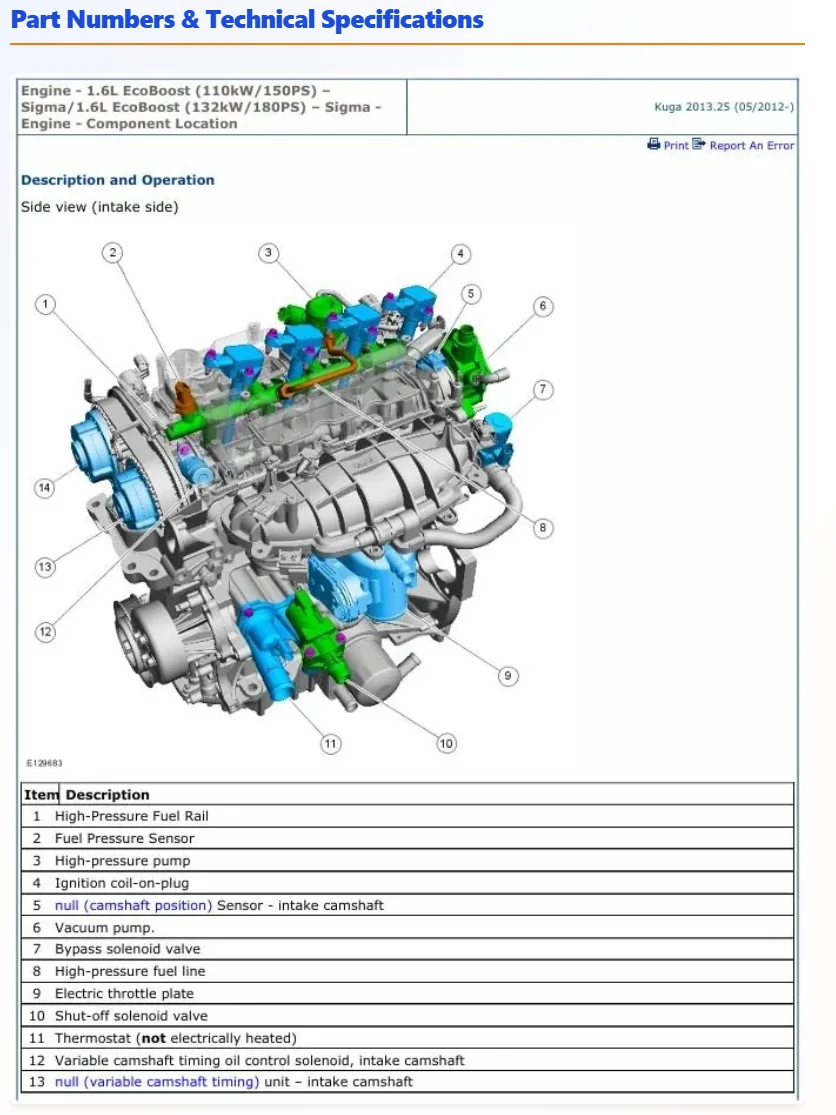

Annoyingly, I cannot find any youtube video or even image showing the low pressure fuel sensor location for my particular engine, its a B4164T3 engine (actually a ford engine) even searching for ford stuff I cant find it, also on any part on any part site the part (even if I put the reg in) it's showing the low pressure fuel sensor is like a T shaped part, with the sensor going in the top and 2 ends either side you plum the fuel line in, there isn't anything that looks like that on my car.
What I think.....is the low pressure sensor is just a single cylinder shaped part the connects in to a hard metal fuel line, but it isn't the one at the end of the fuel rail, which I believe would be the high pressure sensor.

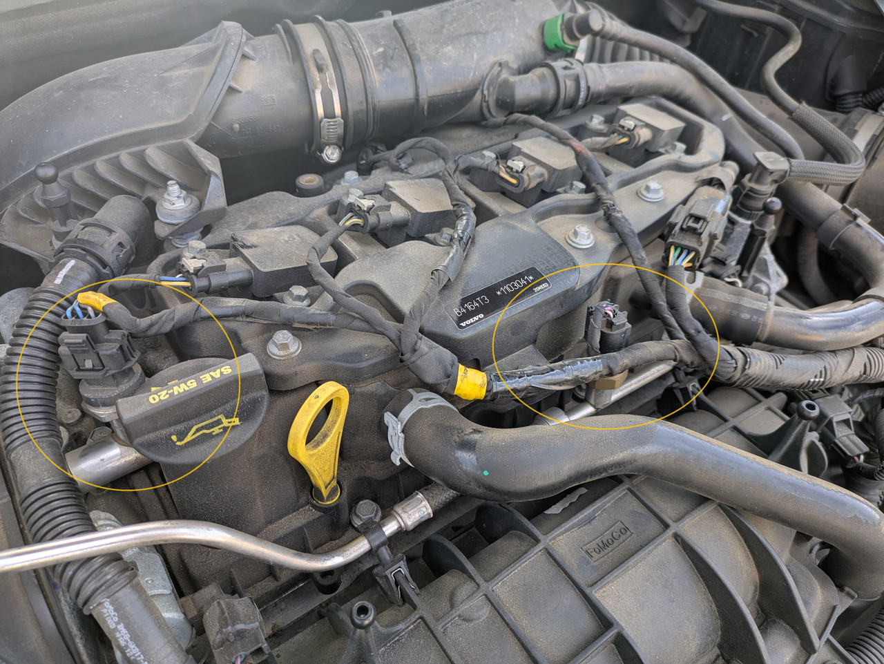

The left side one circled I think is the high pressure sensor and the right side low pressure.
Low pressure sensor
High pressure sensor.
...... I think.
