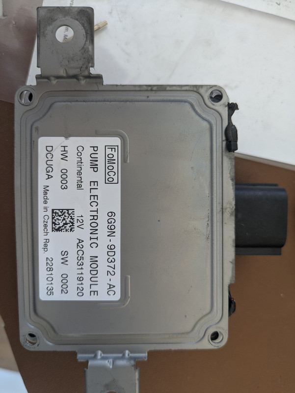

Right update on this spoke to the garage today.
He fired the car up, it did what it was doing, 500rpm baldy chugging for a few seconds before dying.
Moved it inside on to the ramp and then when he started it up later, it fired up, run perfectly fine. He actually showed me in person, fired the car up and it run fine.

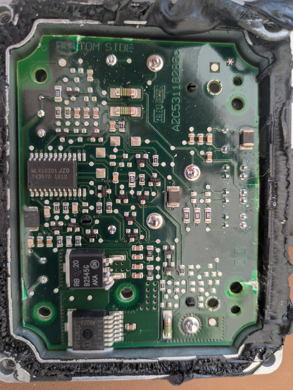

Apparently on the top of the fuel tank not only is the low pressure fuel pump in there, there is also a fuel control module, and he thinks it might be that rather than the fuel pump, and it's failing as it's getting hot, which makes sense.
But if going in to that anyway might as well eliminate the fuel pump and change it anyway.
Good news is fuel pump reasonably cheap, even for a genuine one.
Bad news:
Fuel control module, not cheap.......at all.
Plus it's a drop the fuel tank job.......
He's gonna ring me later when he's looked a bit more.
I can see this easily being north of a grand though.
