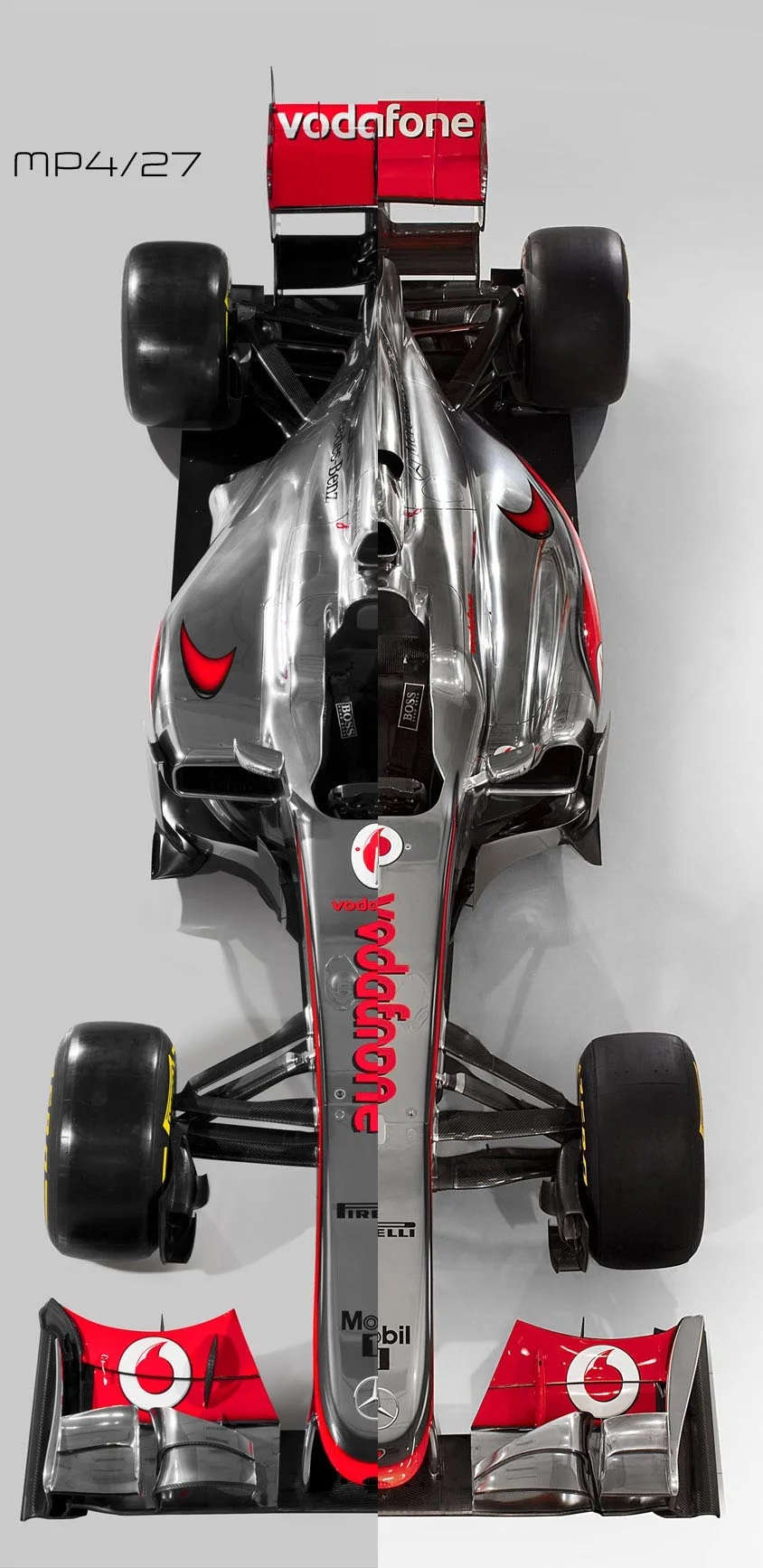

they dont line up properly but you get the idea
even if you line up the front of the cockpit the rear of the cockpit isnt lined up etc so theres no point trying to :P
i dont know if its just the angles of the photo thats changed or if the parts of the car are all slighly moved about
The cockpit opening dimensions are fixed AFAIK. But those shots aren't from directly above so its going to be to do with the angles etc.
Either way, shows that they have a made a not insignificant reduction in wheelbase this year.
Black wheels too. Not sure on them TBH.

Diffuser is a mock up. They always are. It will have zero relevance to the actual one that will be run on the car. At least they haven't completely boxed it off like they did last year
Expect the same of the front wing too.
Alright mate, read this earlier and am just watching an interview with Lewis on the beeb's website in which he says that nothing has been put on the car for the show and that what's on there is part of the car.
Whether he is stating that 100 percent of everything you see is wysiwyg I'm not sure but he makes it sound as much.
Well the front wing is certainly not what we'll see next week.

The main point of those L-shaped sidepods was to funnel air into the diffuser area - which doesn't exist any more, so it would hinder them more than it would help. This is exactly the same reason that definitely isn't the current spec front wing, as that in turn used those inner half-circle wing planes to channel air into the L-shaped sidepod gully.
