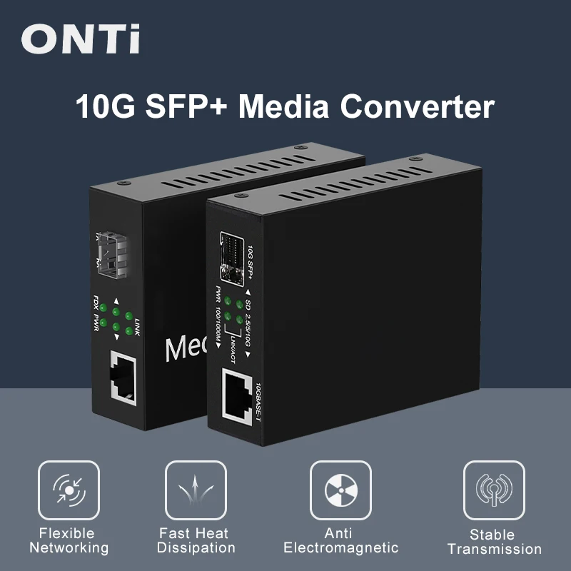

Another option could be going down the fibre route and getting a media converter to sit between the MS-01 and the ISP modem, that's what I'll be doing when we get our 1G+ ISP installed (and when I get a new router)
Hi. That's not a bad shout, thought I would investigate before hacking up the top cover. Uk ones seem mighty expensive yet ones on AE are about £70 for something that looks reasonable with a marvell chip. I am a bit clueless on the cables between the converter and the x710 port on the ms01. Any suggestions welcome. Would I need dac to dac??
Thanks
Thanks
Generally speaking providing the media converter says it supports SFP+ and its not something like HP or Cisco you can use DACs from most brands
There are manufacturers out there that also code the DACs for specific modules e.g. Cisco or HP if needed. Theres loads on certain online marketplaces :)
If you want to use fibre you can get SFP modules for that as well but the X710 can be a bit finnicky depending on the model of X710 :)
Thanks.
I was thinking this and this??
I suppose the only stumbling block could be a suitable psu for the converter. I've asked if they can help with that
Yeah, the converter would be the biggest query, especially ensuring that it doesn't run super hot either.
For that price though its probably worth a shot as if its not right just refund it and buy one from a UK seller or a different model :)
