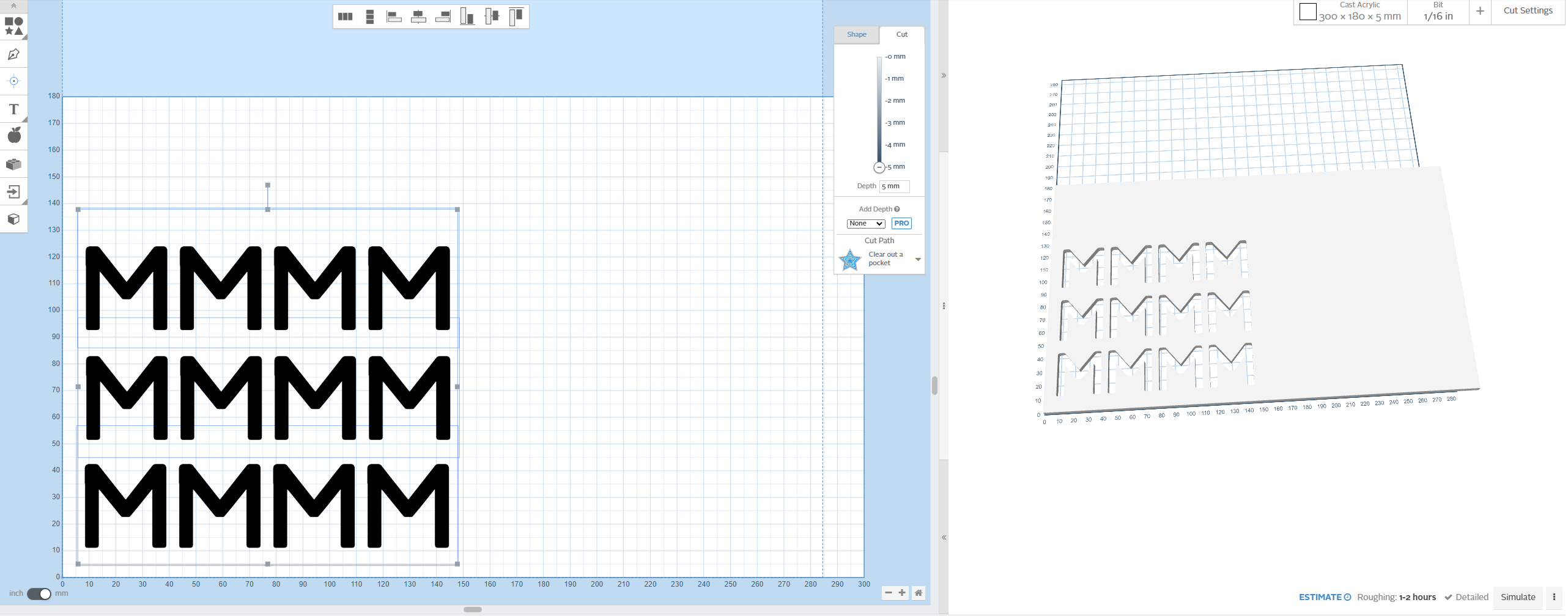

The software I had decided to use is called Easel. So today I installed it and hoped it would just open a PNG I had created in Photoshop. It doesn't. **** !. However, I then realised that it did open SVG files. As such I drew a quick knockup in PS, then opened it in Illustrator (which I really don't know how to use I just know how to convert into vector with it) and...

Starting to get my head around it now after earlier's cluster mess.
As I explained in the Email I could not understand why, when I hit the "simulate" button, that it was going to take nearly two hours to cut out three holes. Then I started reading about tool paths. It seems had I not realised this it would have literally turned every piece of the acrylic inside the holes into dust :D
Once I learned you can cut inside the shape path? about 17 mins it will take.
Some ventilation...
Very useful if you had a thicker piece of acrylic and wanted a pocket (not all the way through) cut though. "MMMM, MMMM, MMMM"...is this going to be a Crash Test Dummies build?! /o ...his acrylic had turned from black into bright white! He said it was from when his endmill crashed so hard o/ ;D

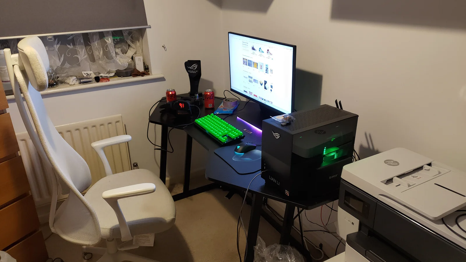

So I got over today. First thing on the agenda was take apart old desk, and replace with new one. Took a few hours, but man so much better.

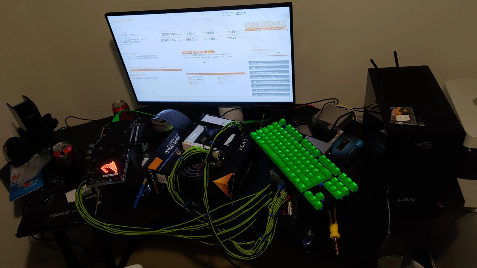

OK so we were off to a flying start. Next up - assemble hardware, plug in my Kepler Quadro and make sure it works. Only, I was on an unknown entity with the PSU I have totally rewired so I figured I would use Gareth's old Asus P67 board and 2600k. Set it all up, plugged in the Displayport cable... Flashing grey screen. Hmm. Now I didn't want to spend hours and hours troubleshooting two unknown entities, and nothing went bang, so I figured the PSU was good.
I then spent four hours trying to get a signal out of the Quadro. First the DP, then DP to HDMI and then after searching the entire house and having to go through this.

Any way after hours of searching I found one. Still flashing grey screen.
Out of sheer desperation, and now in a quagmire of wire and boxes I put the 2080Ti with the water block on.
Which is really sodding annoying because I hoped to spend the evening installing the RAID and getting Windows on. But I can't, because I can't run the GPU for more than a minute or so GRR.

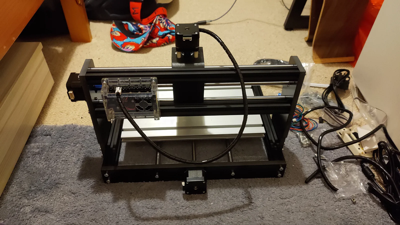

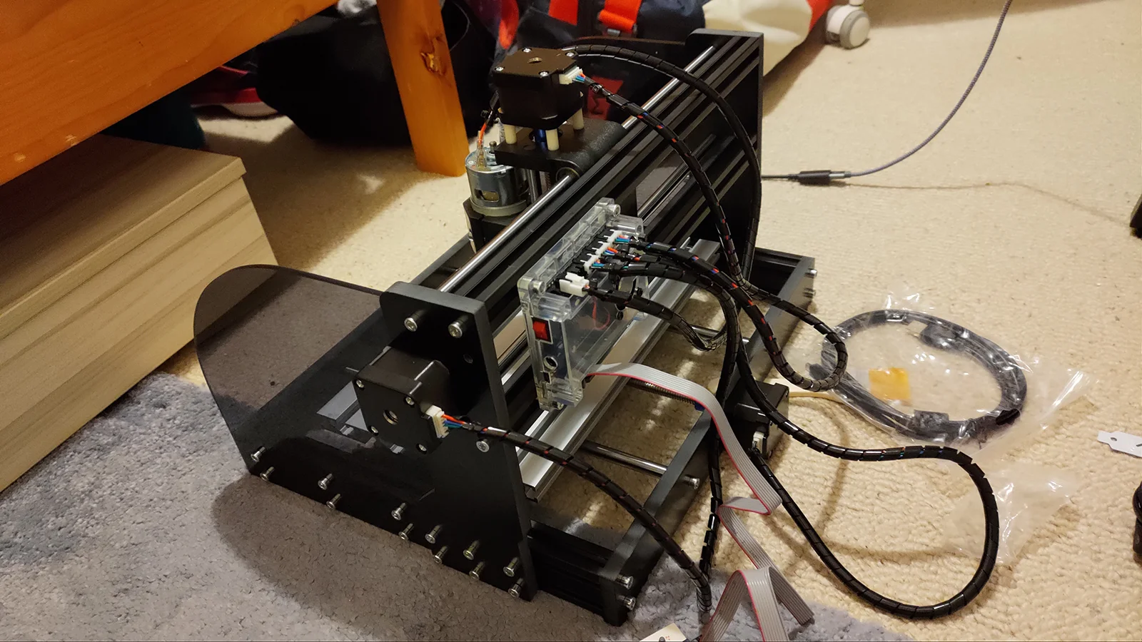

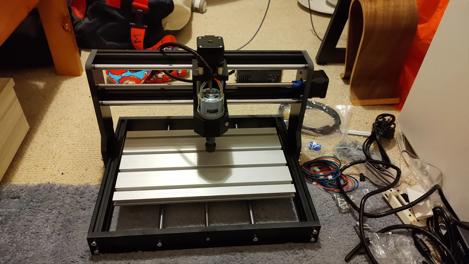

The CNC arrived. Amazon dumped it on the doorstep and ran. Good thing I came over, because whoever said it was light was talking rubbish.

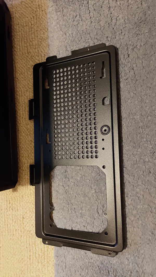

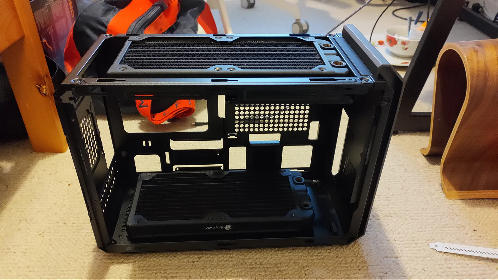

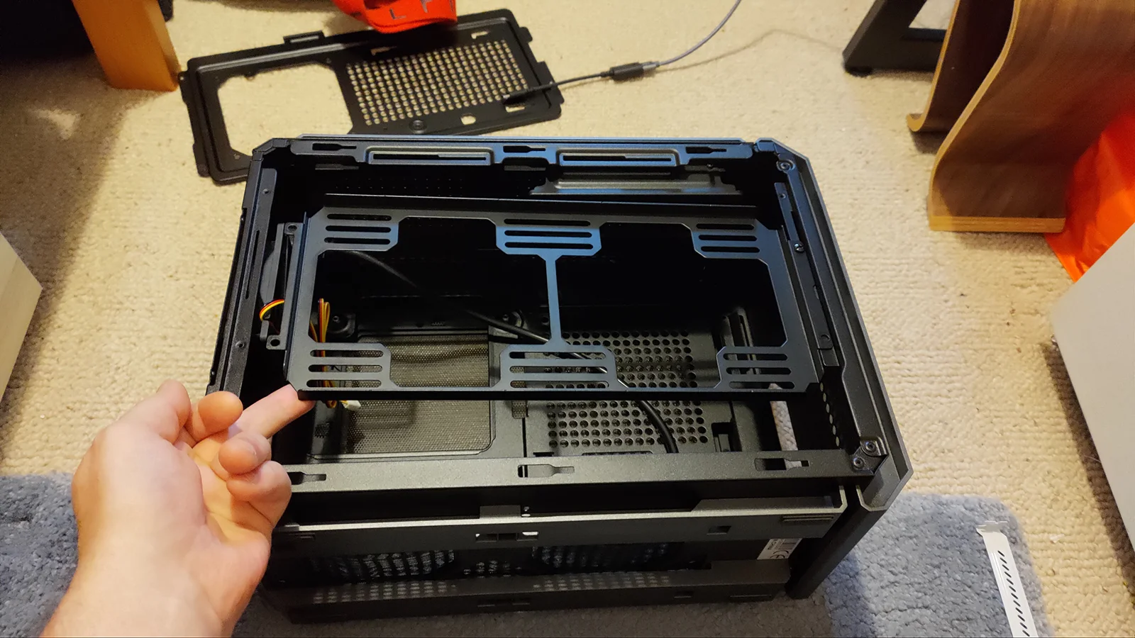

First thing I did was see how the Lian Li panel from another case could go in. I want this as exhaust. Both rads will be on intake.
Goes on one end, needs extending the other. Not an issue, I can make a plate. This was what came out. Not idea to fit two fans to.

Oh and regarding its weight. My mill is tiny and weighs 80kg....and would be considered to be more of a toy by machinery standards. If there's no big chunks if cast iron in it, it's "light"!
