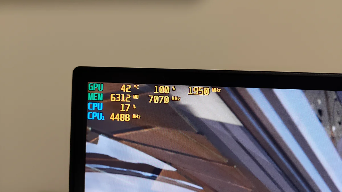

OK so after a 5 hour gaming session I can confirm it all works as it should. Temps are still quite high though, 68c on the GPU in PUBG. Around 52 in Portal RTX. UE really is punishment for a GPU tbh. That said it was over a 3 hour session, and I did have the rad back on in the room.
However, no orbs. And no crashes. And no memory under clock needed. So the FPS were actually really good. I was also surprised to see the 11400F also reach 69c. I guess it has something to do with the GPU temps, but then Rocket Lake is hot AF and it is 6c 12t. I also noted that when I set the XMP to 3000 the FSB is 103mhz, so the CPU also runs slightly overclocked. Overall performance was really damn good in PUBG tbh. I was very surprised. I can actually play Portal RTX too at 1440p and with the settings I used get 55 FPS.

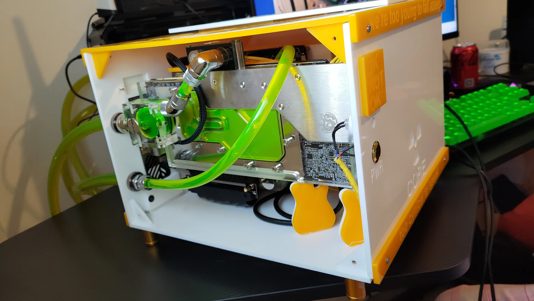

So last night I finished up wiring and finally joined the two boxes together. At which point I filled and burped it. This wasn't as hard as I thought it would be, but god my hands were killing me from squeezing the fill bottle. Took about oo, 30 mins?

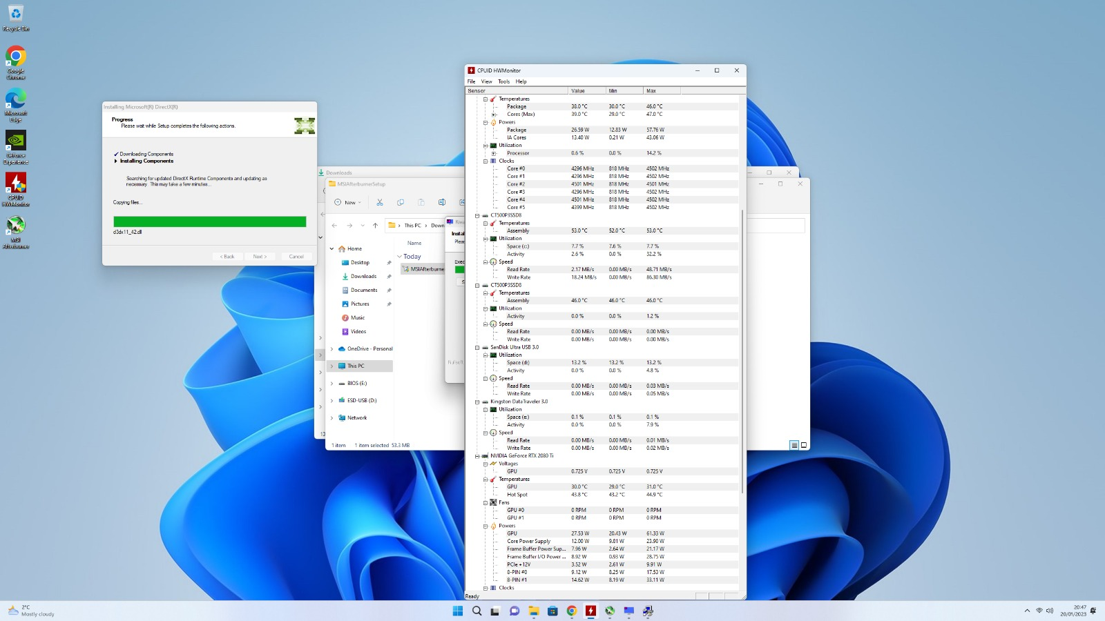

I then installed Windows.
And ran a few tests last night. GPU seems very happy now.

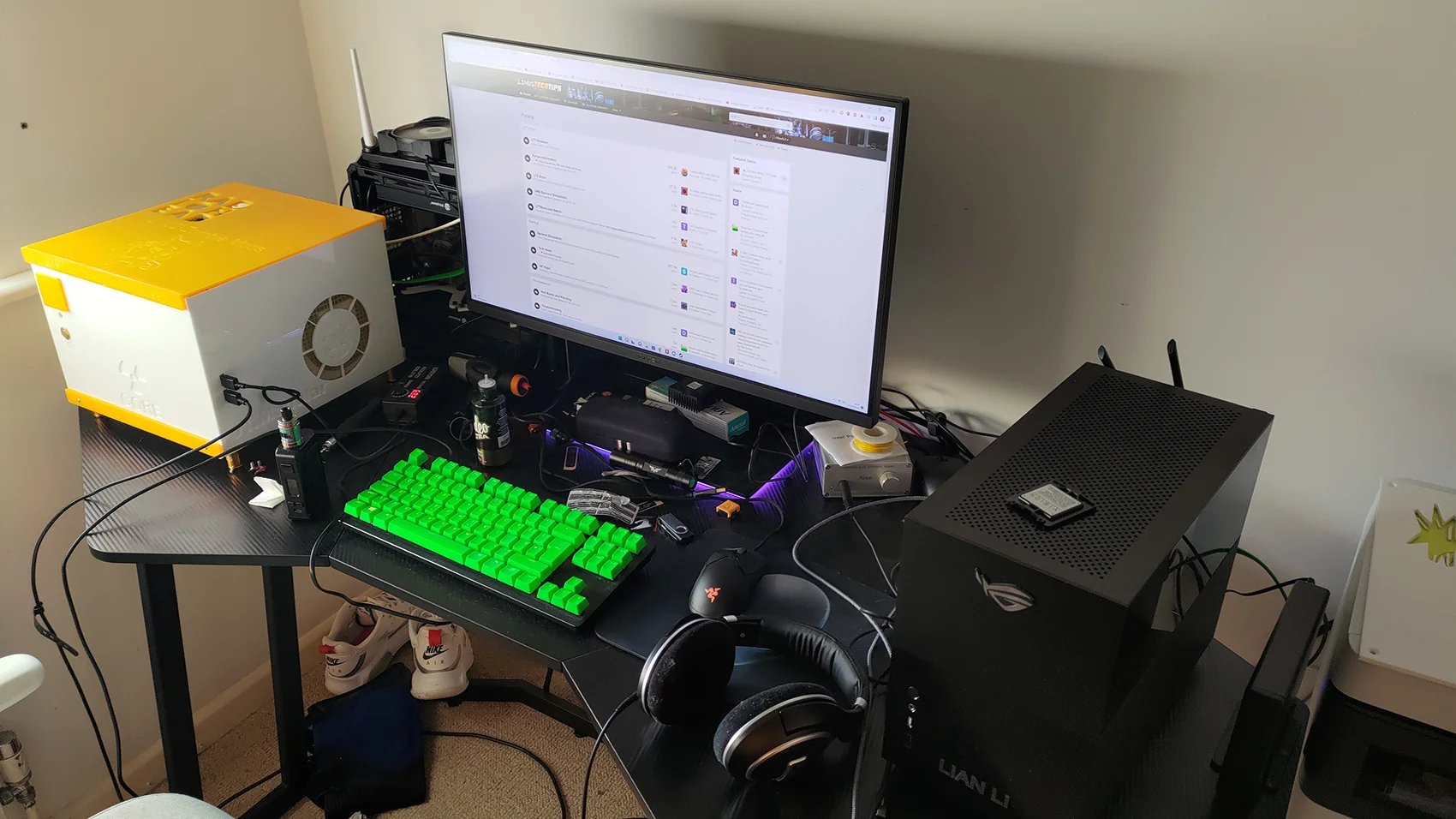

So this is where we are at today.

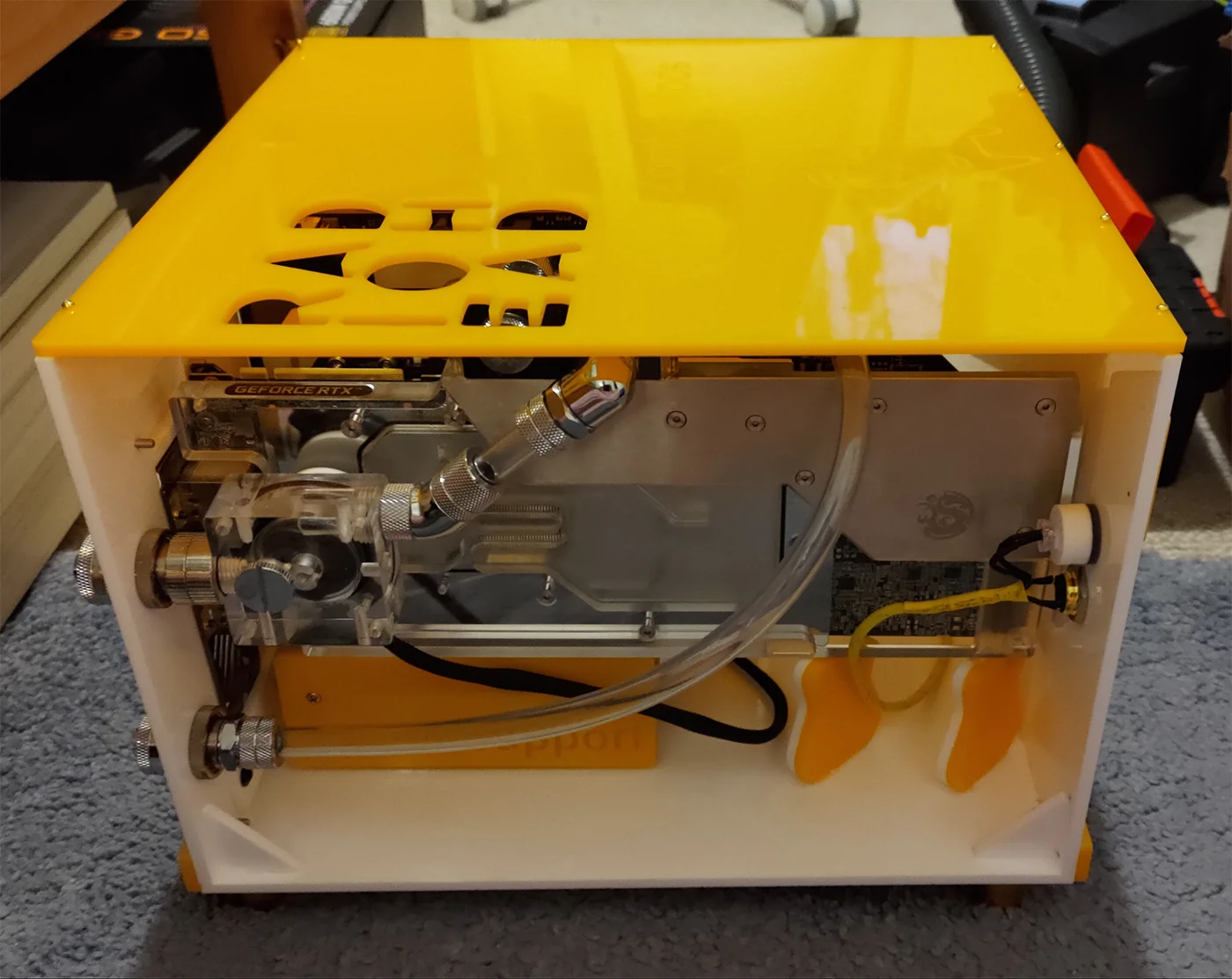

Nothing has been assembled yet.

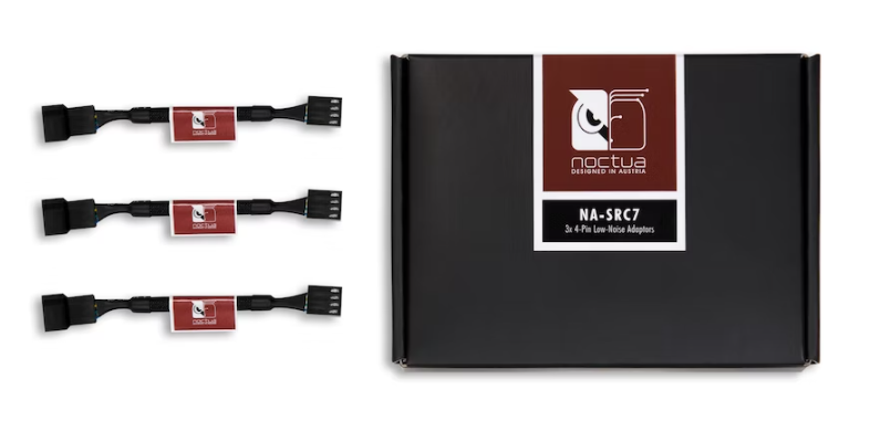

And there is a good reason for that. After a lot of testing I can not get those 6 Bitspower fans to produce anything I consider to be livable noise levels WITHOUT the pump stopping. Which is a big issue. I built this thing because I was tired of the noise, not because I wanted more. So, thinking on my feet last night I bought these.
Which are quite expensive. So I did not want to buy 6 of them, so I got these with them.
X2. So I will use the noise reducers (two) into those, and then connect the fans to those. I should then be able to crank up the pump without worrying about the fans sending me crazy.

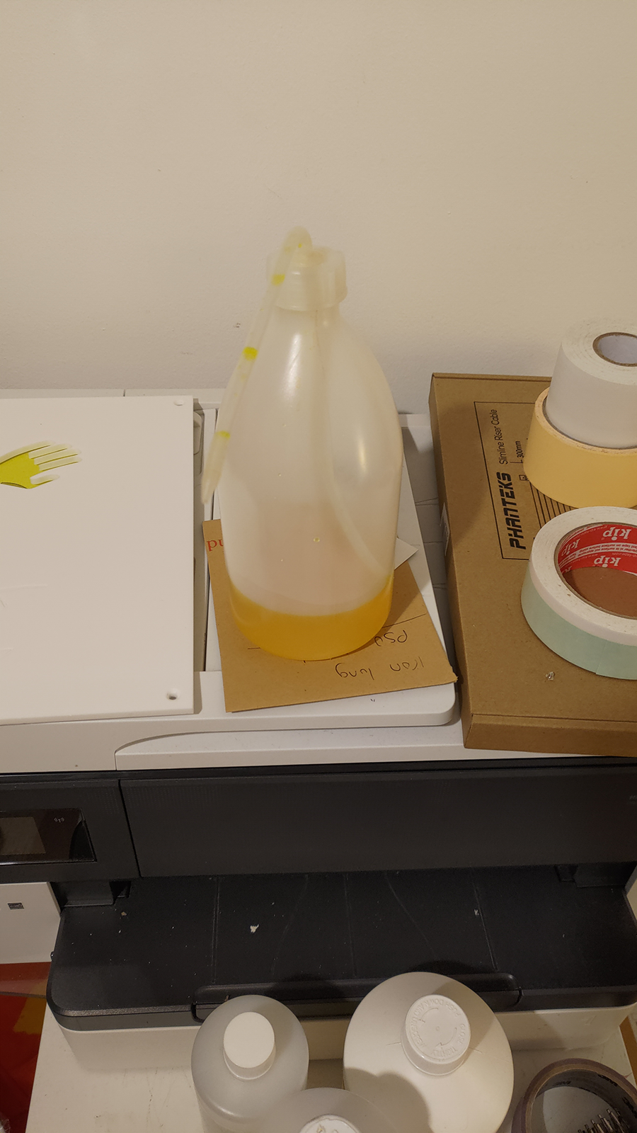

Must say the coolant looks really suss in the filling bottle.

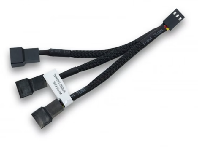

Ah they're 4pin/PWM - can you just run a splitter from fans to a motherboard header?

What colour is the carpet in the vicinity of the florescent yellow coolant? Asking because experience :D

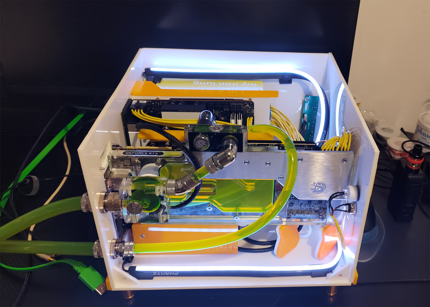

Update 55 - "Everything In Its Right Place"

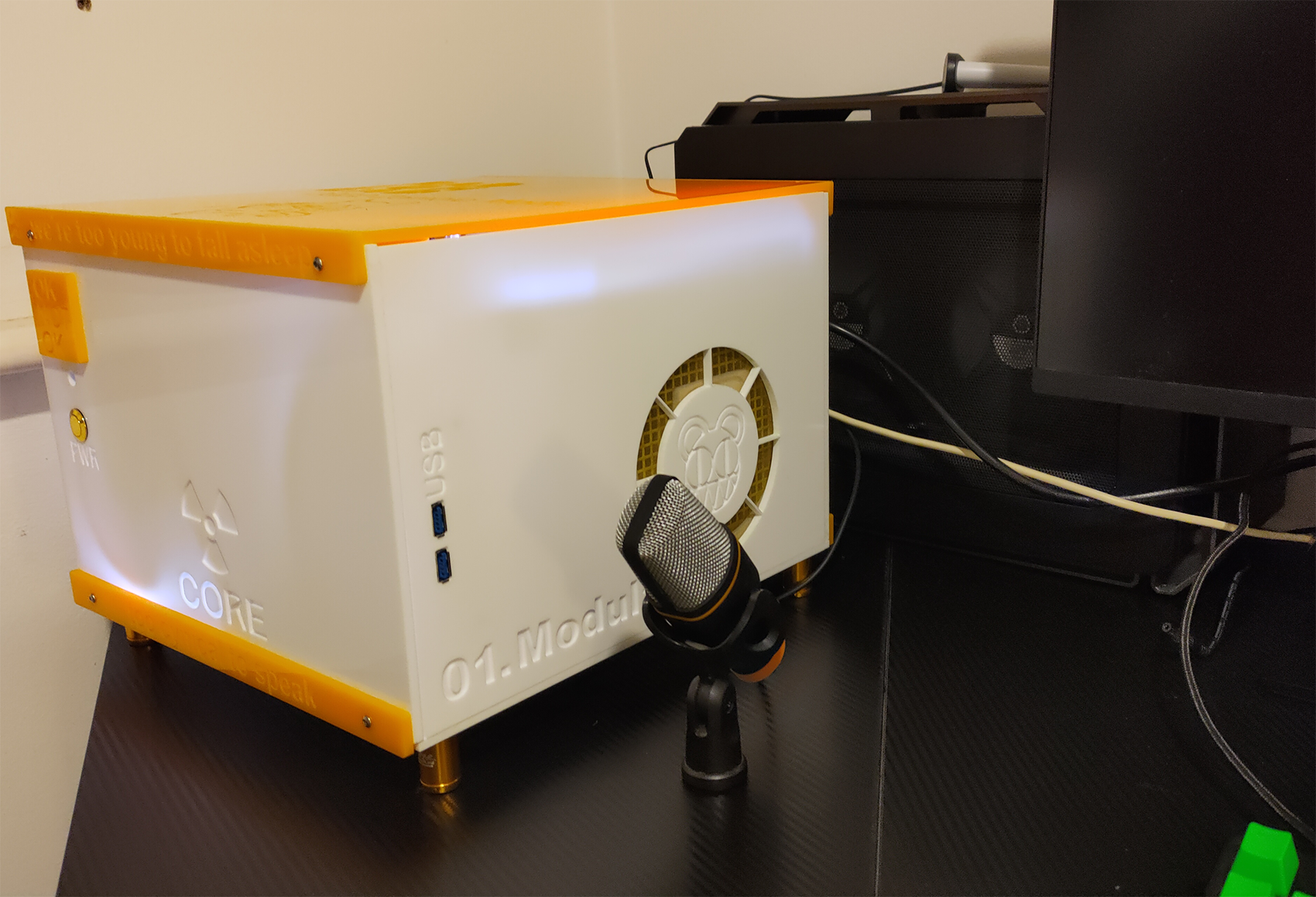

So today I finished the cooling box.

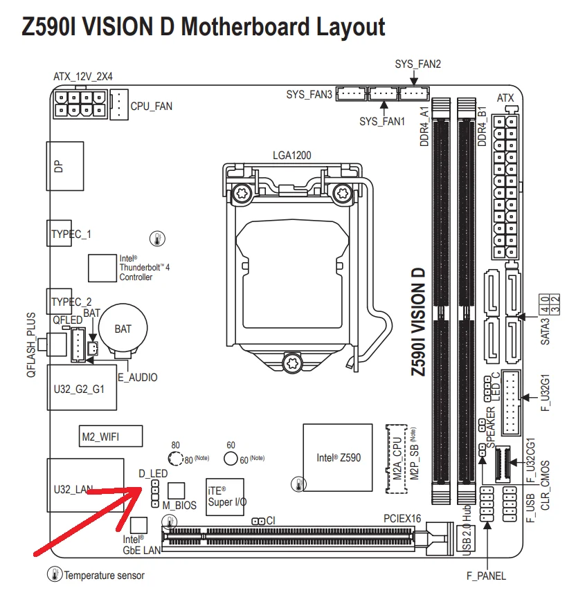

I then remembered I bought some RGB strips. Which turned into an absolute nightmare.
I figured the connector would either be ATX 24 pin side or like most boards, across the top. No no no. This is where it lives.
Um. Um. F*ck? um, f*ck f*ck and double f*ck?
It is close to impossible given this is your view.
And of course nothing can come out now because it is all conjoined with hoses.
After saying f*ck a few more times I decided to investigate. First I removed the GPU's PCIE connector cover and then removed said connector. At this point I could see it. Problem was it was about 20cm away and of course hands don't fit and as soon as you put your German Bands in there you block the view.
As such after saying f*ck yet a few more times I realised I would have to cable tie it to a screwdriver. I then pushed it home, and then after saying f*ck a few more times I got the cable ties off. By this time it was loose, so I gave it a firm shove.
From that point on it was all plain sailing.

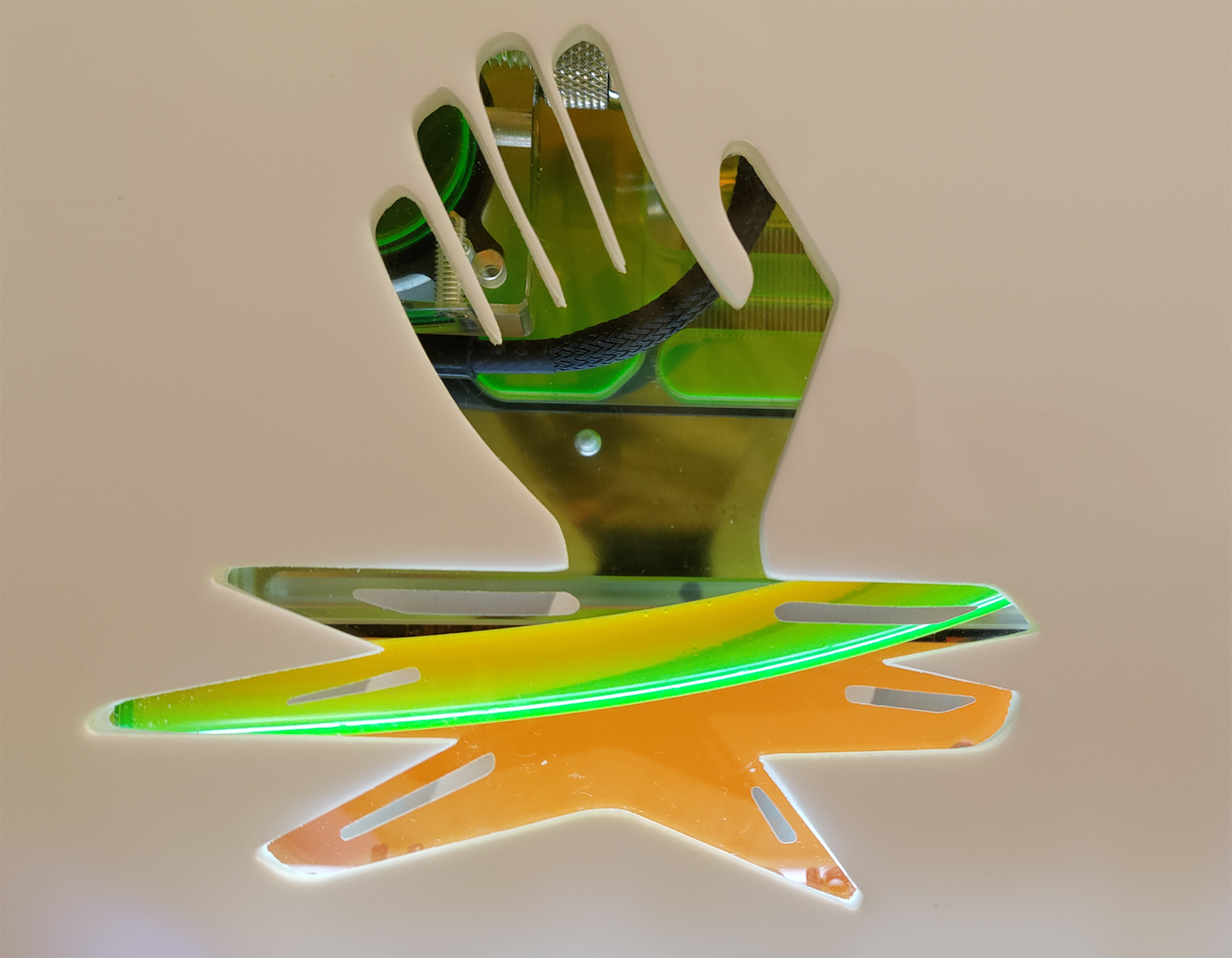

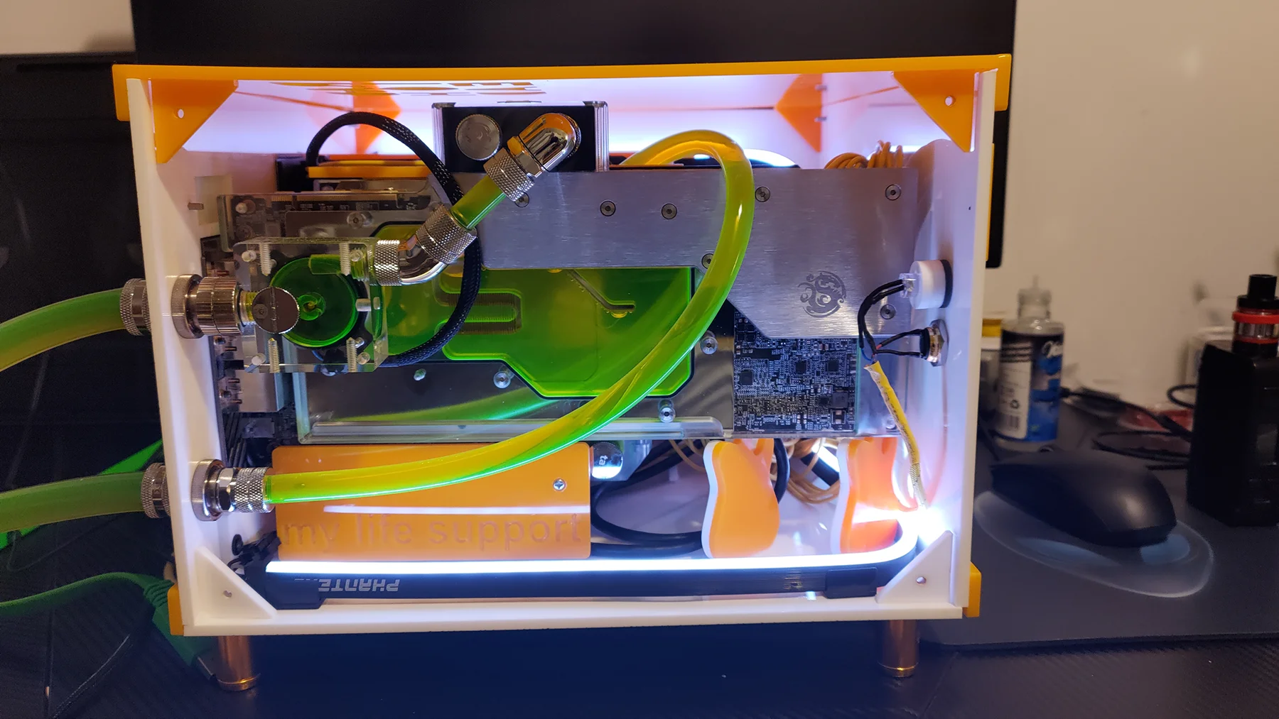

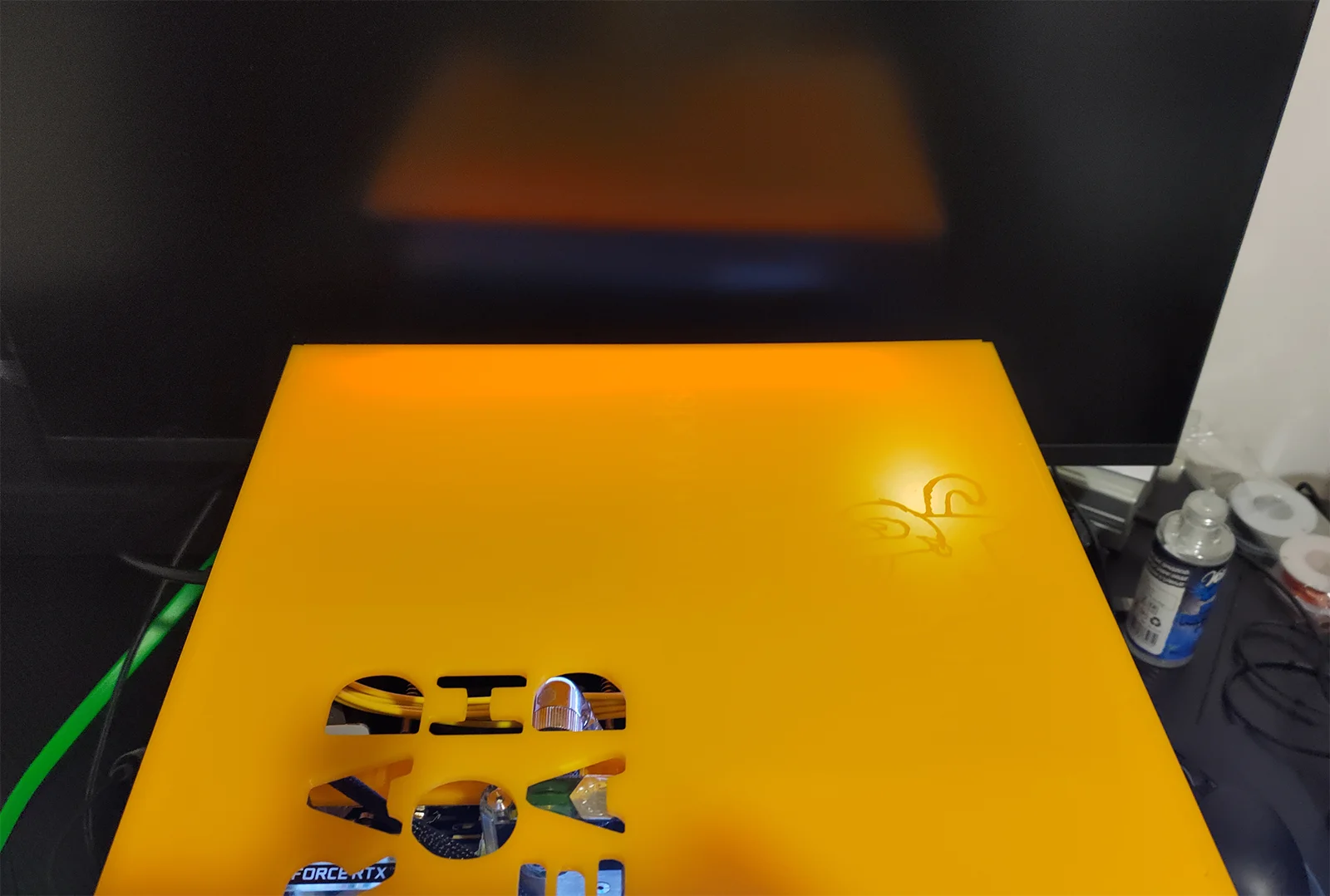

After replacing the top I noticed it had this wicked glow across the right side.
Which was why I bought them. Top back on.
I could then fit the side panel back on.
Wicked.
After a lot of rewiring and reworking I had it connected once more. Sadly the audio cable and the power cable need replacing with longer ones, but that I can do.
My mic's tripod imploded about two days before I began the project. However, given it has the right look and right colour on it I am going to make a holder that is integrated into the front corner of the case.

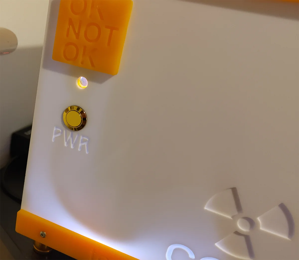

I also sorted the power LED yesterday, as it was on backward and thus did not work.

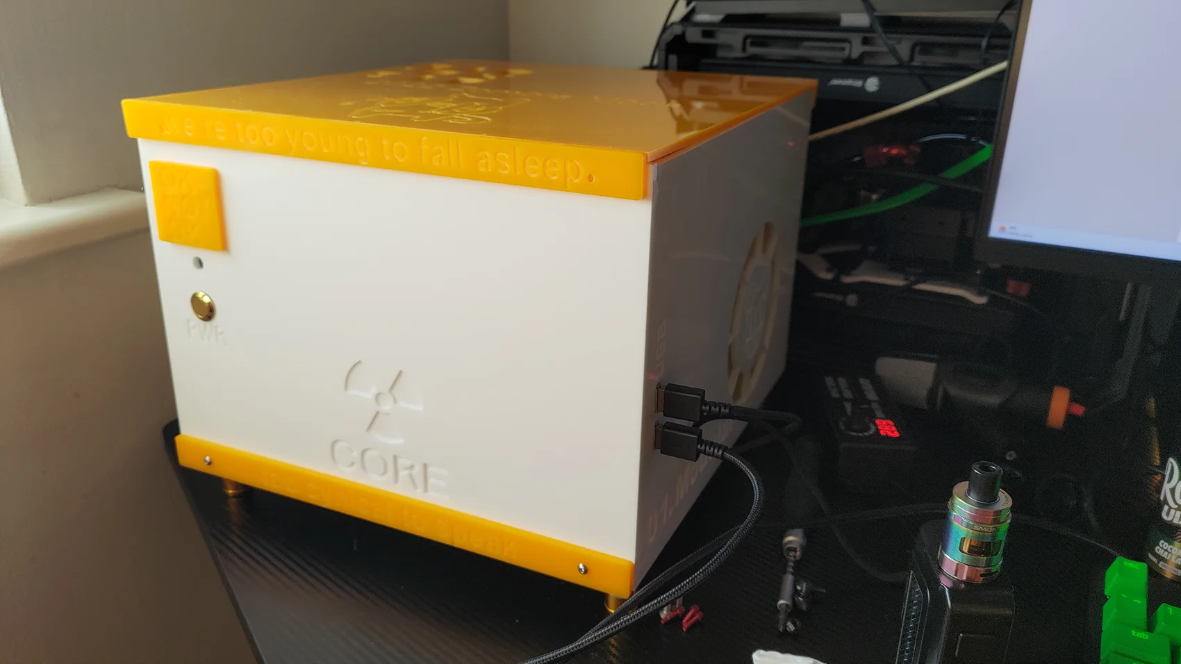

BTW few things to mention, and somewhat closing thoughts because I still need to cover the screw holes and make the mic holder (though that will not happen for a few weeks).
In the end I realised it would be a huge hassle to remove the pump braiding and etc. So, I cut the sensor wire (I was worried it may be shorted and would thus blow up the board), and just connected it to the board. This happened for a reason. I had one spare connector from the PSU left (a molex 4 pin). I was in the middle of making a custom pump power cable in yellow and yet again was distracted by my mother. Only this time? I totally got it wrong and the PSU was cutting out. With no real reference to fall back on yeah, that is why the pump is connected to the board like that.
I found out why I was keen to replace said power supply all those years ago. As soon as you put a load on it it screams. IIRC I put three Titan Blacks on it and was benching when it started. Given it was so long ago I had forgot, so now my friends ask me why I have a helter skelter running in the background. Obviously this is not something I can easily fix, nor would I want to remove all of that work. As such at some point I will look at the service code on the case and find out what model it is. If I can get that correct? I will buy a replacement unit the same and switch out the guts, given it was very easy to take apart. That way I won't lose all my work.
Come spring time? I will start on 02. So I can live with it until then, given at idle and normal use it doesn't make a sound. Closed back headphones maybe?
I have a lot coming up now. Lots of family and personal stuff to endure, so yes, I may leave it for a month or so before I totally complete it. But, as the last update said, everything is now in the right place. And it all does what it should. It still runs very warm in PUBG. It is not uncommon for the heavier maps to make the GPU reach 70c. Especially the new Vikendi, with its tornadoes and all. However, I have not seen one orb, one artefact and it has not crashed once. Given the core is still running pretty close to where it was before? well I can pretty much assume that the water jacket has now stopped the VRAM reaching ridiculous temps. I have not underclocked it at all, and have over 10 hours on it in PUBG now. I would like to think that the devs maybe fixed something, but it was only ever happening to me (we all get crashes but not like that) and it only happened on one of my rigs out of 3 that I use. So it is fair to say? that definitely fixed something.
Overall I am very happy with it. I spent the absolute minimum on hardware, recycled a lot of old gear and have put it to use. I also am very happy indeed with the CPU performance in games. It decimates my 3950x. In fact, it is pretty much as good as my 12700K. Go figure.
