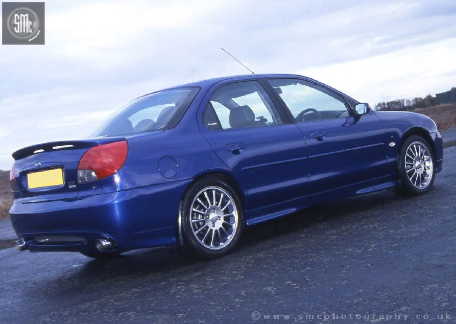

had you had the wheels refinished? they look a lot shinier where as mine and every st200 i've seen have a matt finish.
Tom.
that is an ST200 LTD they only made 300 of them but the wheels should be the same as the normal st200 IIRC :)

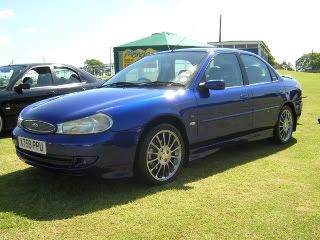

I currently have a ST200 estate possibly even rarer that the limited edition saloon model that Jamous had.
I've had it over a year now and the first couple of things I had done was changing the waterpump for one with metal impellors (the stock one's have plastic impellors which are commonly knows to break off and cause the engine to overheat) and secondly I had a full service on it, at 44K with FFSH it was about time for one and I wanted to make sure it was all ok.
Since then it's had a new set of Goodyear Eagle F1's, some clear side repeators, I've replaced all the standard door speakers with some Pioneer's (which sound so much better!) changed the headlight bulbs for some pure white ones, changed the standard paper panel air filter for a K&N panel filter, and had a interim service last week which was due after 12 months, fluid changes etc...and a new rear engine mount (torque restrictor) which was worn, a common trait of the V6's due to the torque going through the front wheels.
Apart from that I am VERY happy with the car, it looks good, its very comfortable to drive even with the harder suspension, it goes like stink (although I think my IMRC needs changing which are £120 at most Ford dealerships) and best of all is the sound when you give it some :D
I don't intend on selling her yet due to me loving the car, I've also never seen another one in all the time I've owned it and before as a matter of fact.
