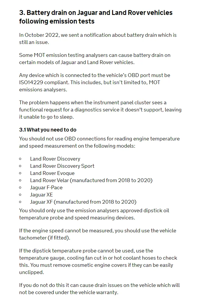

Something to bear in mind for you JLR owners when getting an MOT..
That's a special notice from the DVSA that testers have to acknowledge before they can continue testing, although I guess most don't even bother reading them :rolleyes:
Does that mean the battery drain continues after the device has been disconnected?
EDIT: Oof Googling someone had it happening intermittently, which seems to be when they've taken it into the dealer for the regular service/MOT, took it back to the dealer to try and diagnose it which made it worse because the dealer was plugging stuff in and eventually ended up with a large bill because of what became a circular problem of the dealer trying to diagnose the fault their diagnoses was causing/exacerbating...

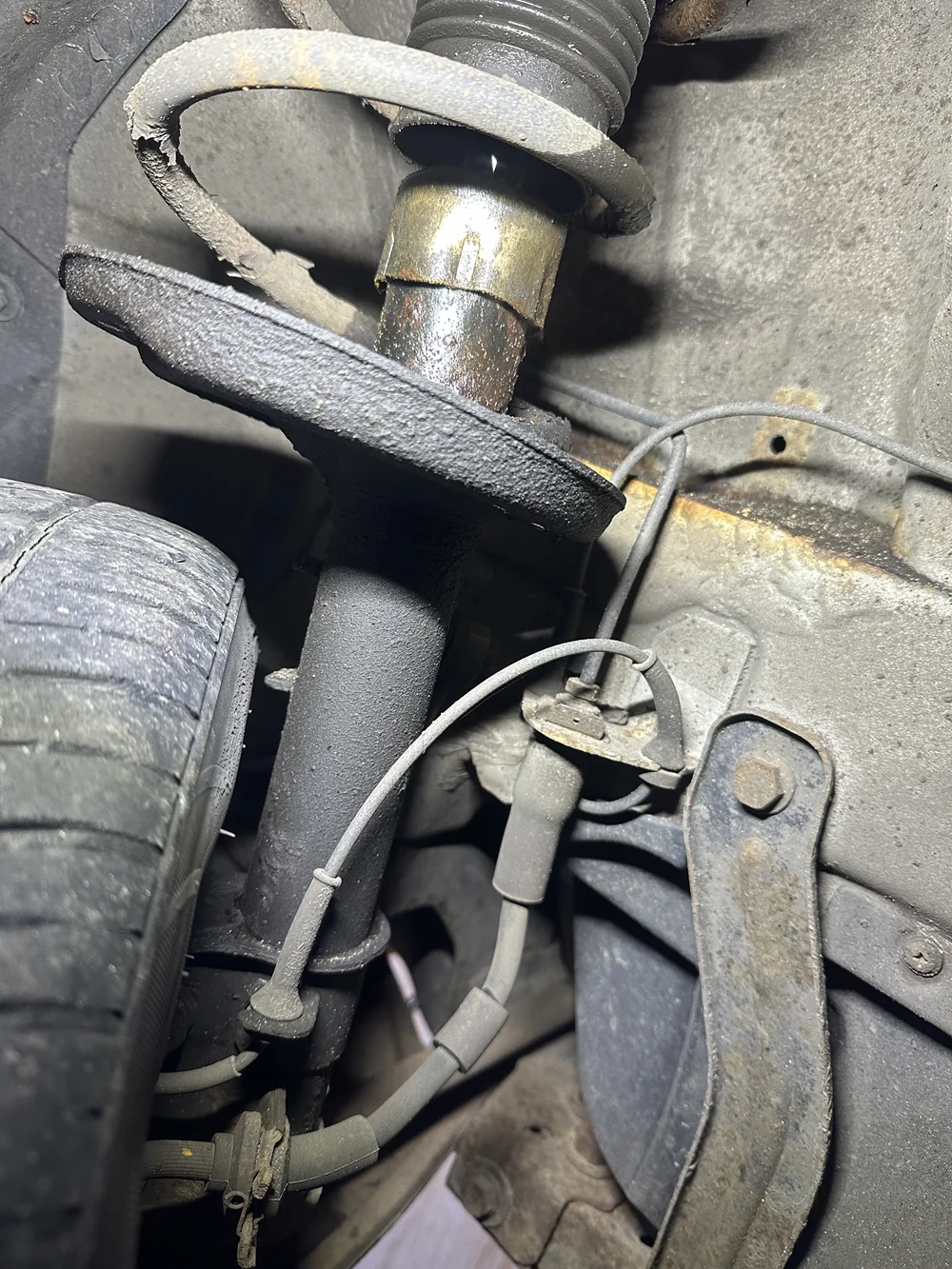

Saw this in a car park the other day. Looked like the car was in use. I was in a rush so didn't get more pics, but suffice to say that this gives an indication of the condition of the rest of the car (VW Eos):

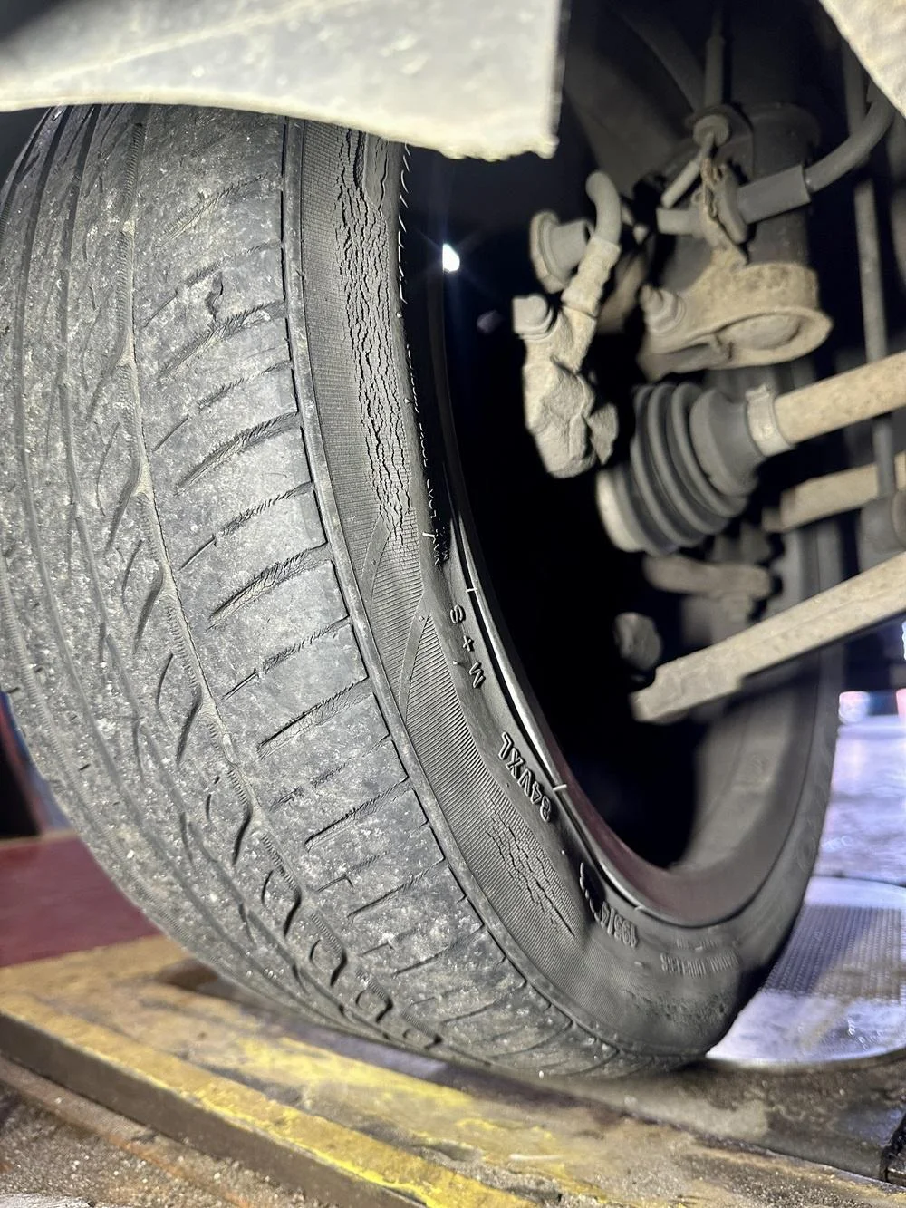

Shock not doing much with it's oil on the outside, and slightly bulged tyre (the other side was the same)..

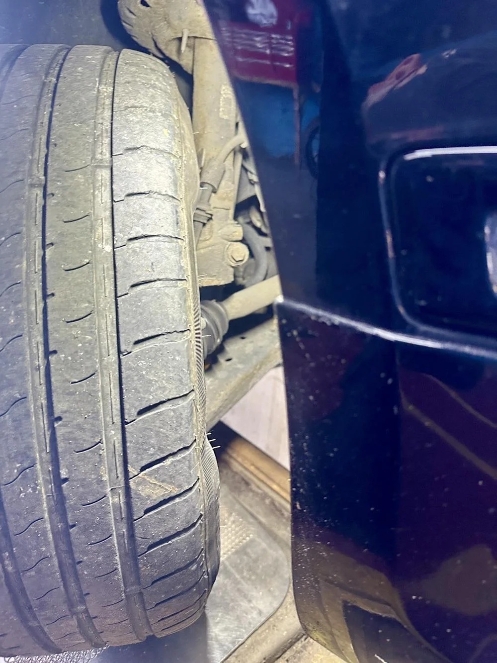

Different car

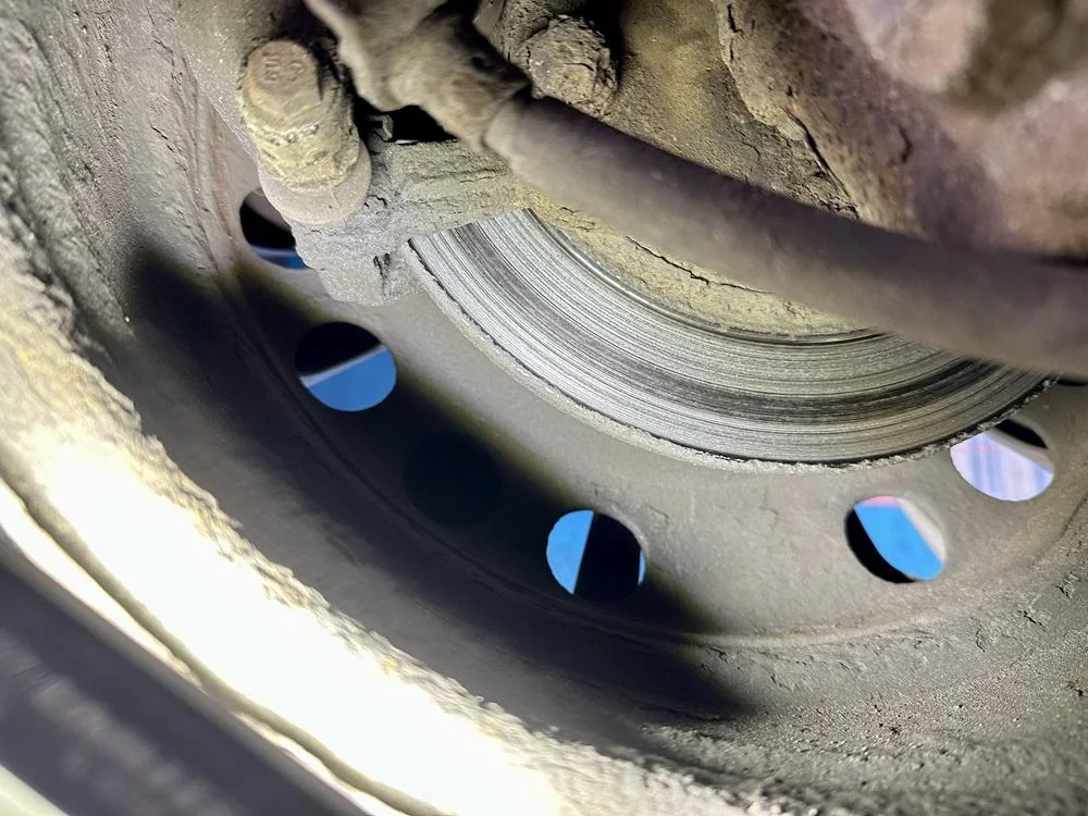

Slightly worn tyre and pads down to the metal..

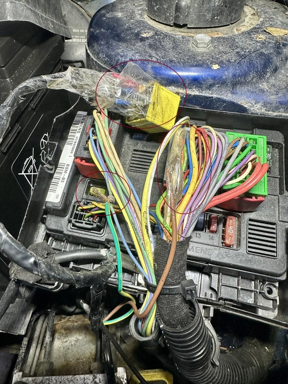

The customer had just bought this 306 without an MOT and I couldn't get it stop stalling while trying to test it.
So I had a quick look to see what the problem was..
No way I was touching that, but advised him to go look at some YouTube vid's of how to properly join the wires, and he came back in and it passed.

Whelp - I know it is mostly on the inside but still - one look at those tyres and I'd refuse to drive it until changed. I know most people aren't that mechanically minded or take much interest in their tyres, etc. but I just don't understand taking that little responsibility for it - they plainly don't look right even from the bits you can see from the front/side.
I ditched a set of not that old Turanza t005 because they had less cracking and perishing than that.

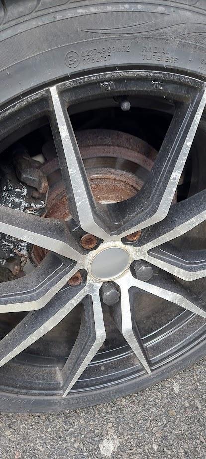

Not necessarily - the rear discs and hub are a bit more corroded than I'd like on the Qashqai but the rest is fine, not sure why both rears are that bad though while the rest isn't bad at all (2017 car on 40K miles).
(Discs are being changed when I have it in for MOT in July)

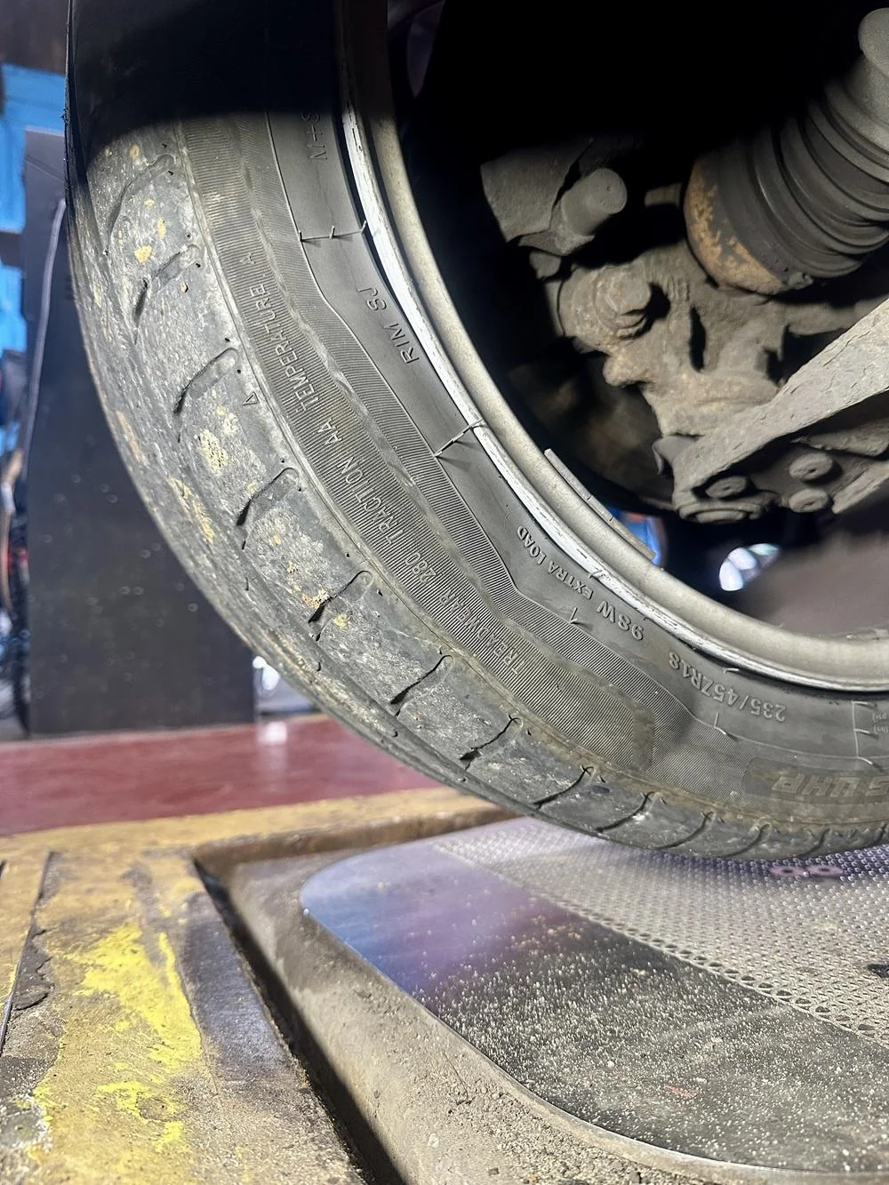

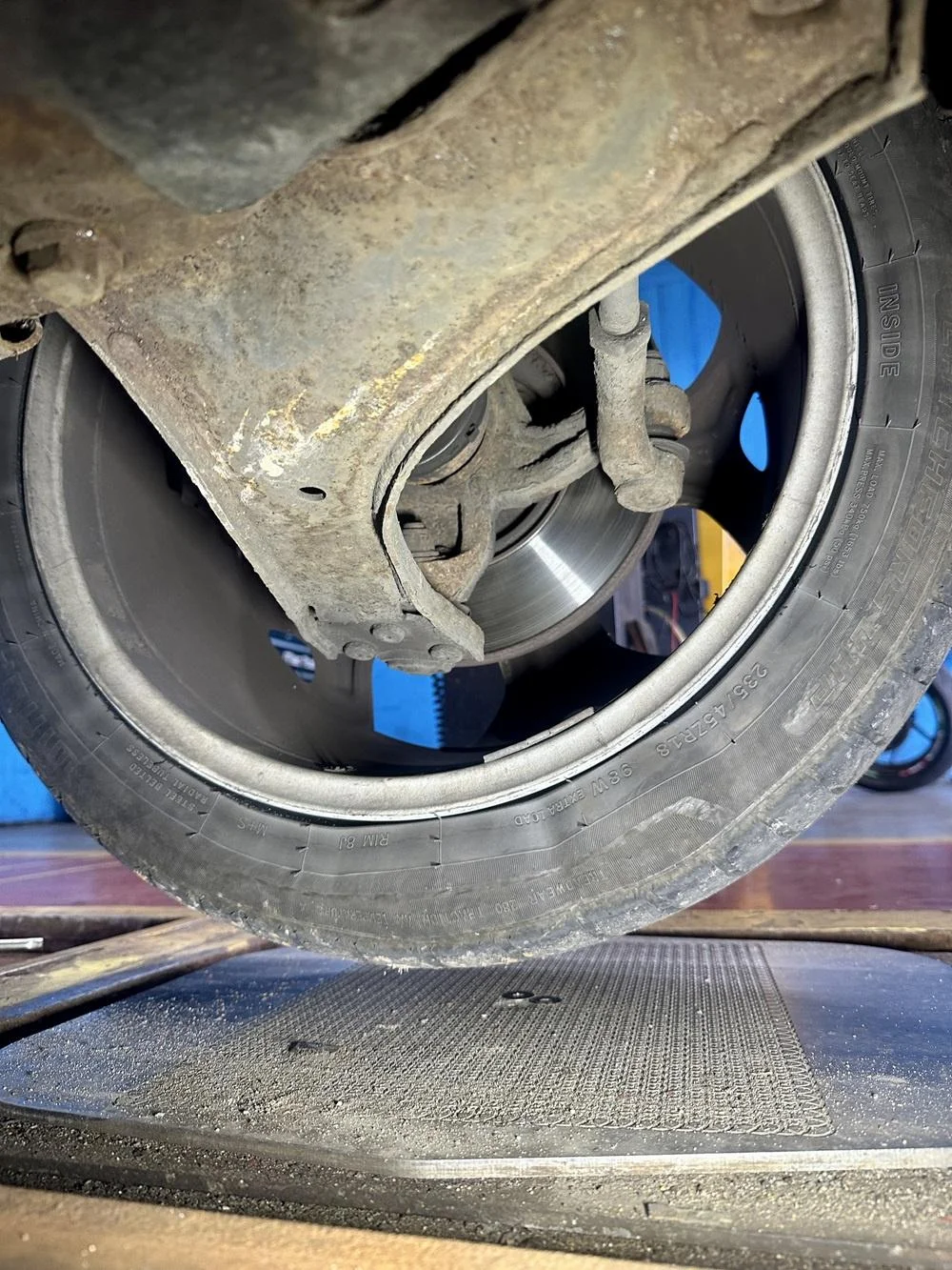

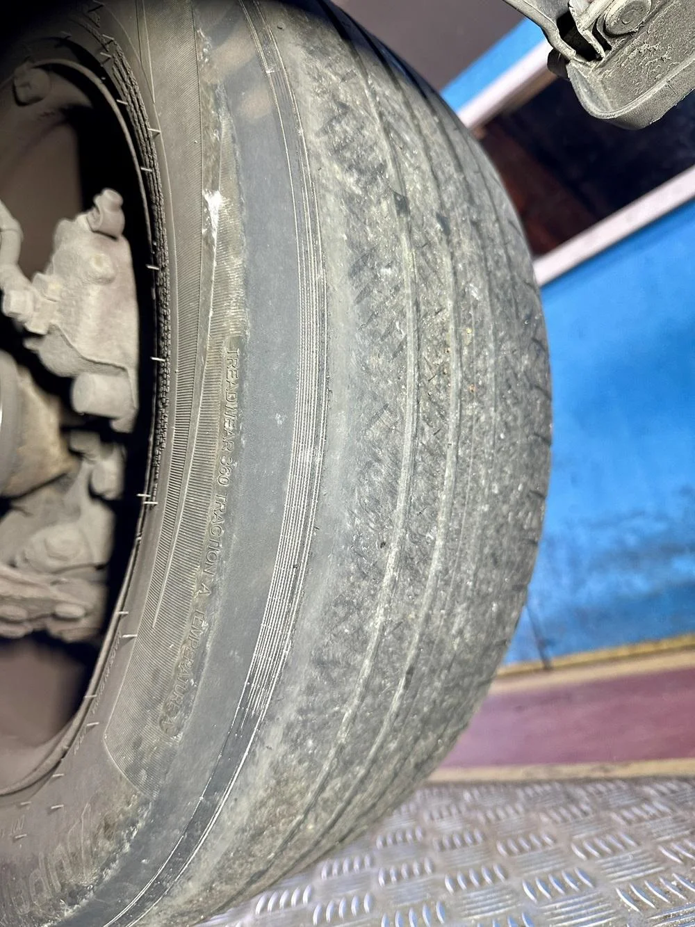

Some more bulgy tyres (same car, and both front)..
and the other side..
I had a look at the inside of the tyres when they were removed and there's signs of them being run under inflated, which I assume has caused them to go the way they have.
