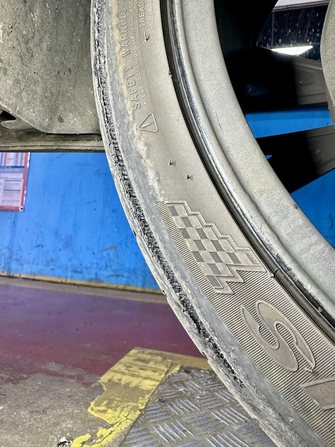

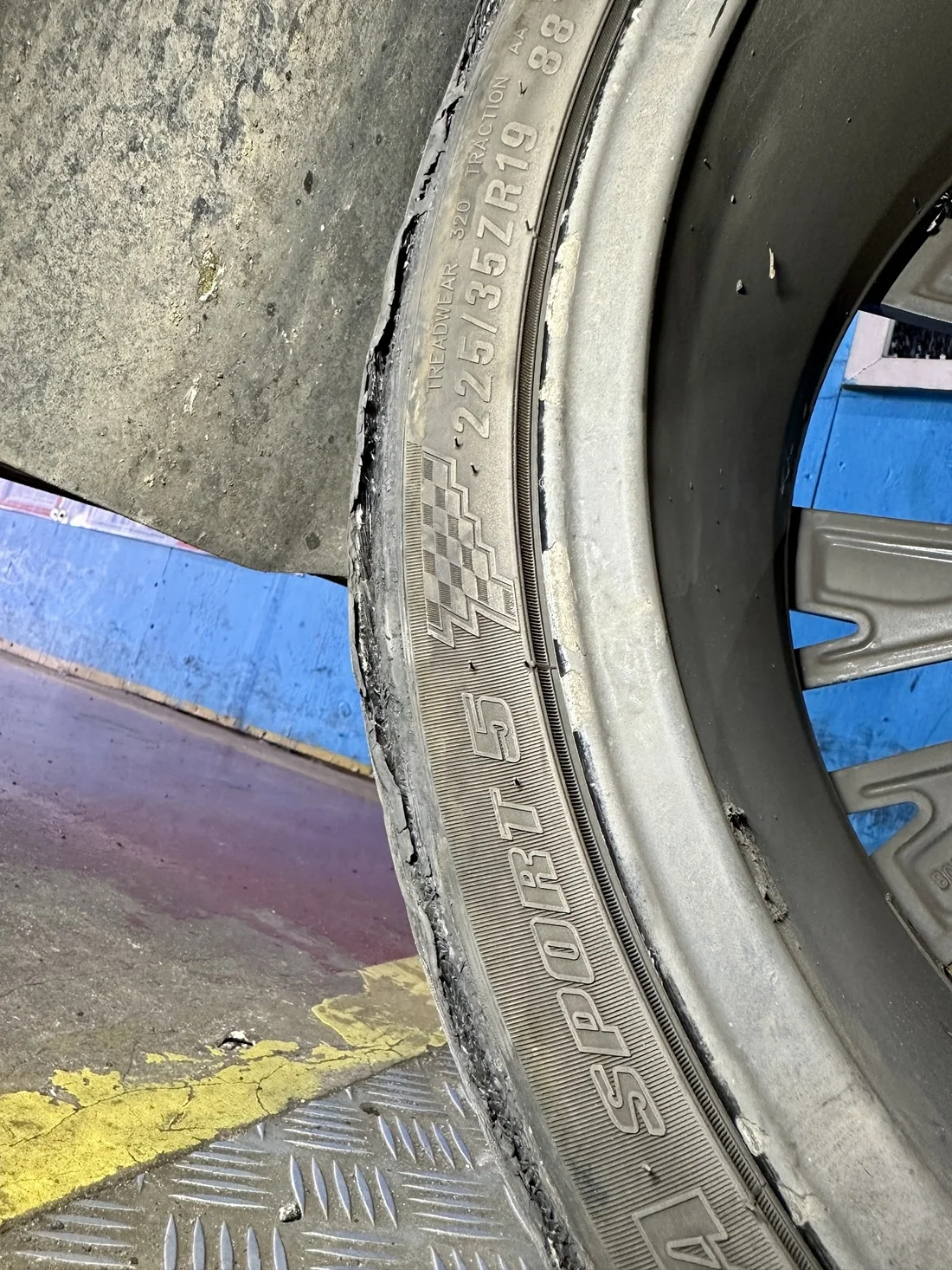

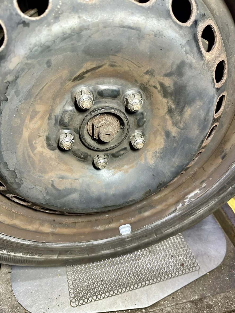

Do not drive until repaired (dangerous defects):
  • Nearside Front Tyre has ply or cords exposed (5.2.3 (d) (ii))
Repair immediately (major defects):
  • Windscreen washer provides insufficient washer liquid (3.5 (a))
  • Windscreen damaged and affecting the driver's view of the road (3.2 (a) (ii))
  • Anti-lock braking system warning lamp indicates an ABS fault (1.6 (b))
  • Boot lid cannot be secured in the closed position (6.2.1 (e))
  • Horn not working (7.7 (a))
  • Nearside Stop lamp(s) not working (4.3.1 (a) (ii))
  • Offside Stop lamp(s) not working (4.3.1 (a) (ii))
  • Nearside Front Service brake lagging in operation (1.2.1 (d))
  • Nearside Front Service brake excessively binding (1.2.1 (f))
  • Registration plate lamp inoperative in the case of a single lamp or all lamps (4.7.1 (b) (ii))

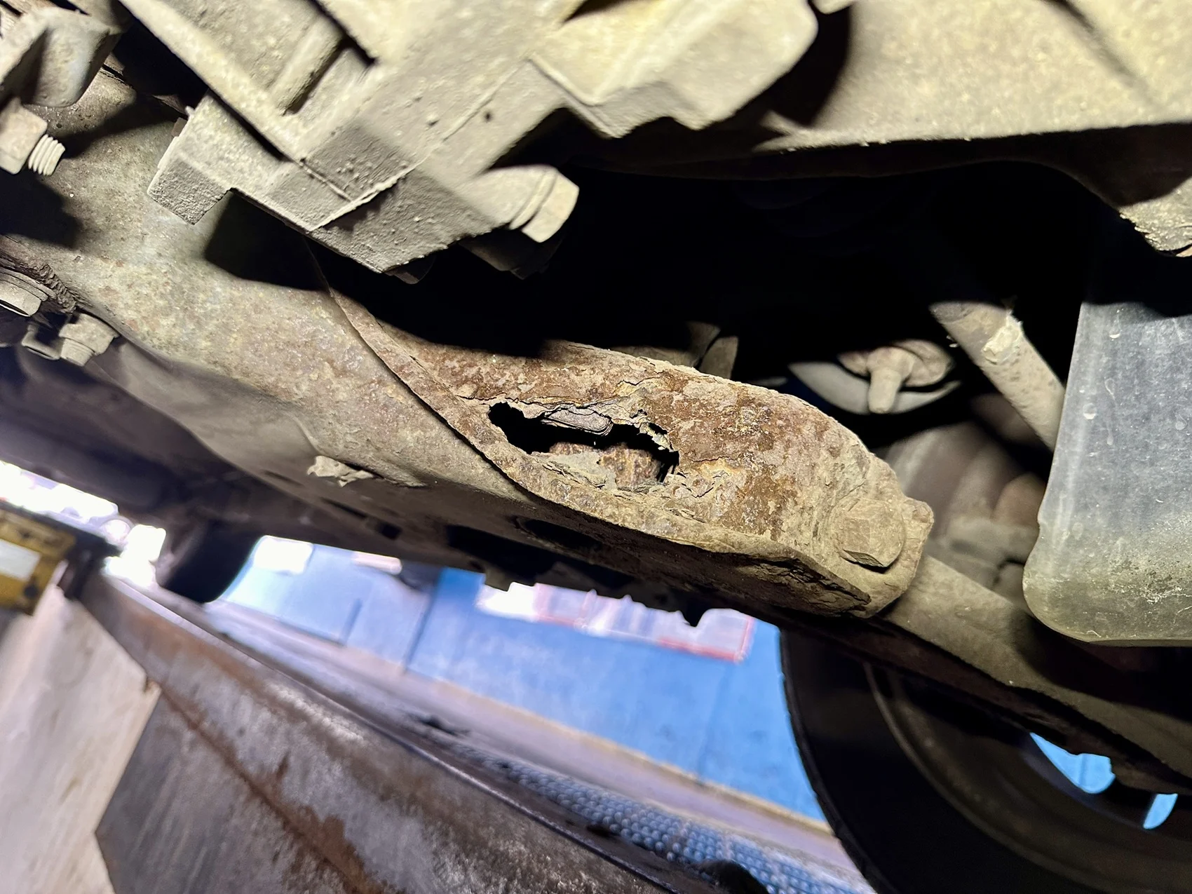

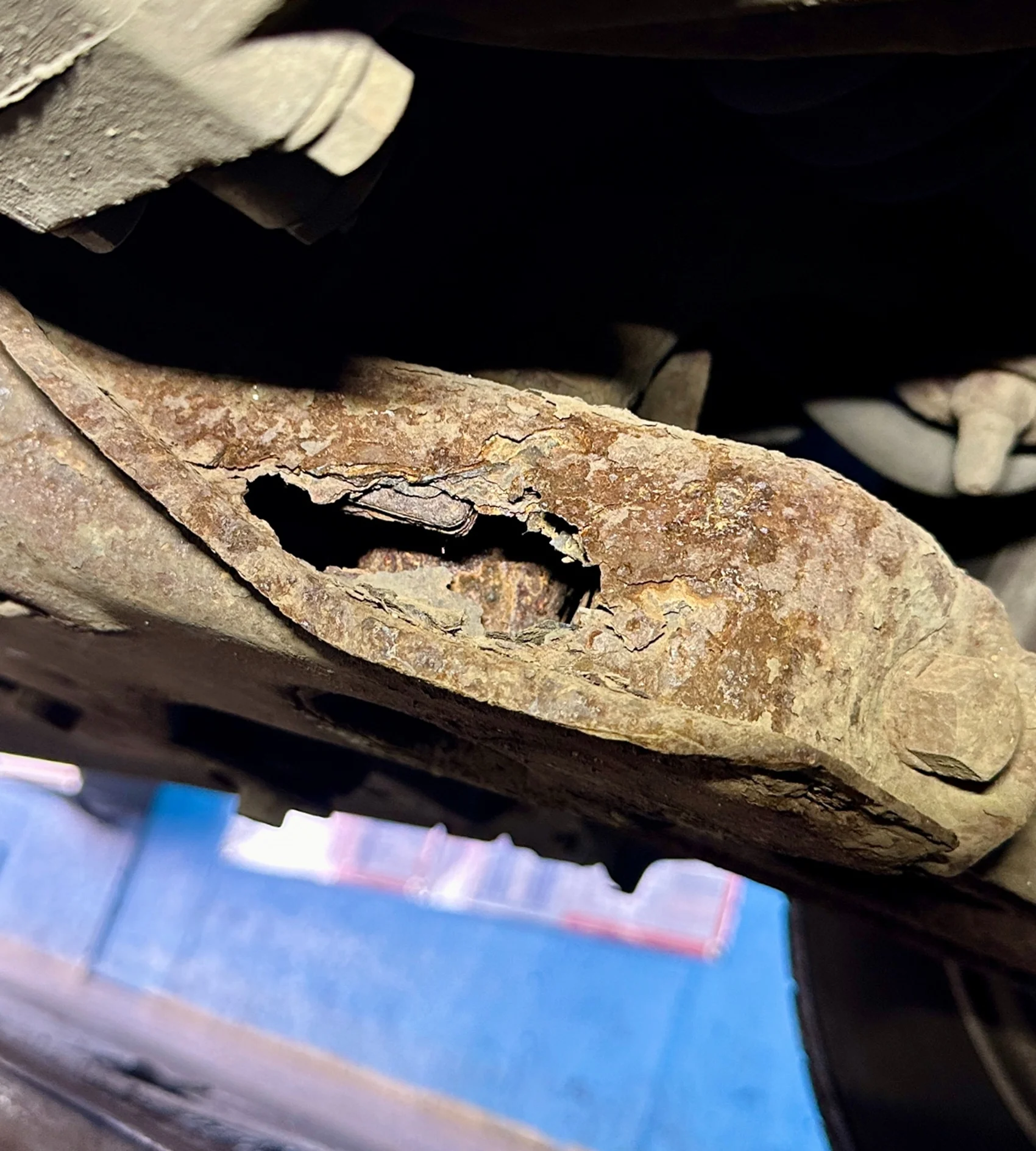

  • Nearside Rear Suspension arm corroded and seriously weakened (5.3.3 (b) (i))
  • Offside Rear Suspension arm corroded and seriously weakened (5.3.3 (b) (i))
  • Nearside Front Suspension arm pin or bush excessively worn (5.3.4 (a) (i))

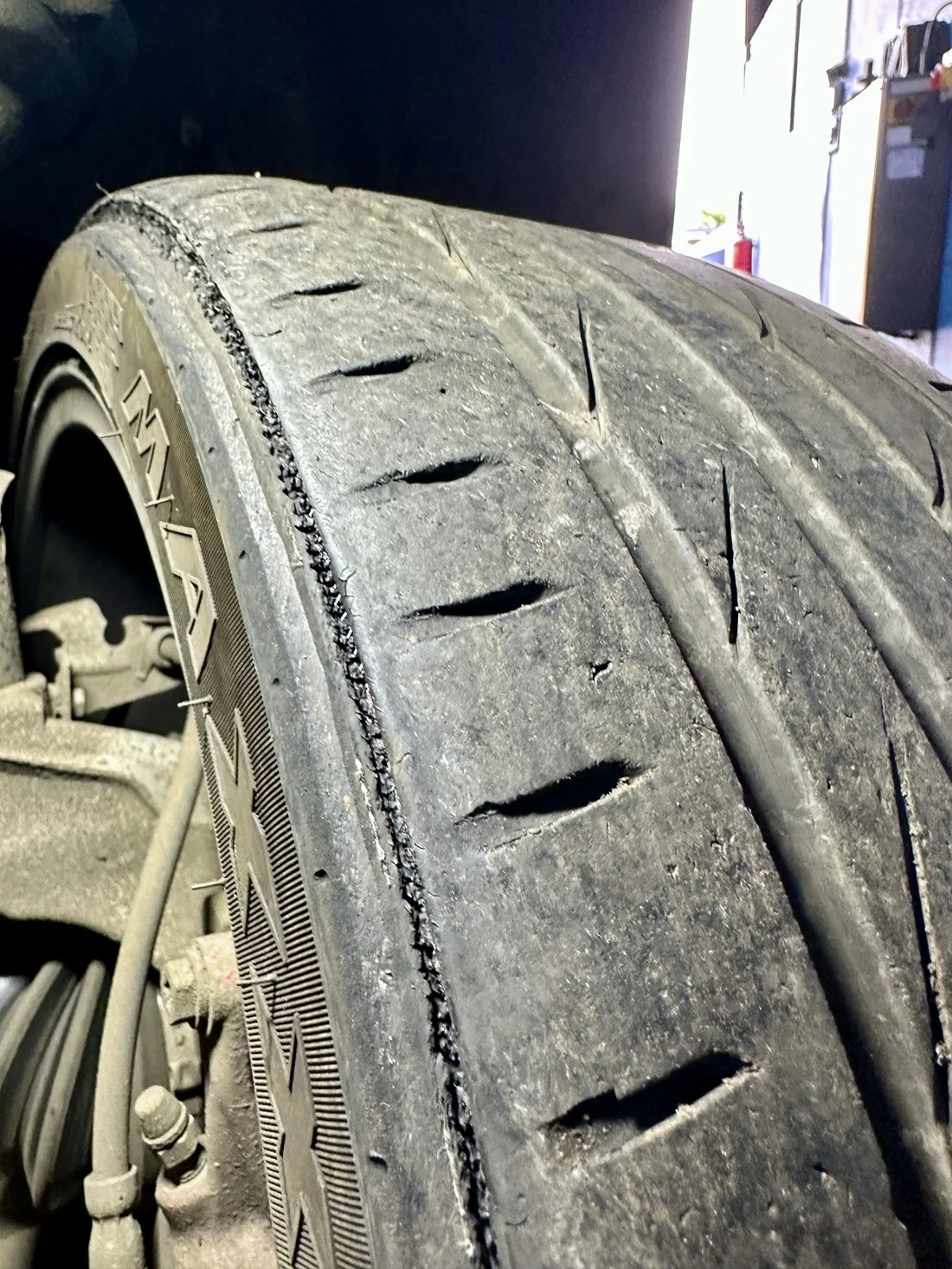

  • Offside Front Tyre has a cut in excess of the requirements deep enough to reach the ply or cords (5.2.3 (d) (i))
  • Offside Front Wheel bearing has excessive play (5.1.3 (a) (i))
  • Nearside Rear Road wheel fixing missing (5.2.1 (a) (i))
  • Front Exhaust has a major leak of exhaust gases flexi (6.1.2 (a))
  • Parking brake efficiency below requirements (1.4.2 (a) (i))

Advisories do wind me up a bit because I can advise a tyre with 1.8mm on it which by the time the customer has done a short journey will be illegal, but people just look at the pass certificate and don’t worry until next years test.
Same with tyres that are completely bald on the edges and the cords are about to come through, I have to pass and advise.

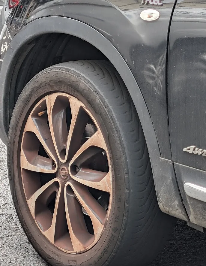

Bet this is fun in the wet. This was in traffic, being used. Not a care in the world.
It's ok, it's 4wd :cry: .
I've seen blown out tyres on the side of the road that were in only marginally worse condition.

Not the sort of condition one wants their front subframe to be in, considering what's bolted on to it..
The car was owned by a young girl who came in with her grandparents and had just recently passed her test.
I stopped the MOT at this point (no point in charging the MOT fee and continuing) due to how serious it was and the costs involved and explained the problem to them, only to be met with floods (and I mean a tsunami) of tears from the owner :(
We priced it up with parts from our suppliers, and it's unsurprisingly an uneconomical repair.
I can't comment on the owners private life, but after speaking to the grandparents. that car is her life and she'd found her independence owning it.
I've had a nose around and found the subframe a lot cheaper, and will speak to my boss (long time friend) and see if there's anything we can do to get it through the MOT a lot lot cheaper for her.
I usually couldn't give a rats ass about failing a car, but that one hurt a bit as she was so upset.
