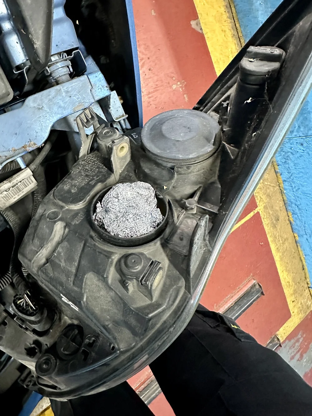

Badly fitted headlamp bulbs are a constant failure for incorrect beam pattern where people (or Halfords, mainly Halfords) just somehow ram them in there causing all kinds of damage to the holder. lamp or retaining clip.
I usually just refit them in situ or pop the lamp out to do it if it means the car will pass, however..
This customer managed to not only destroy the retaining clip, wiring and melt the lamp internals, but then rammed some tin foil in there to hold the bulb in place..
It didn't pass, and a new head lamp was required.

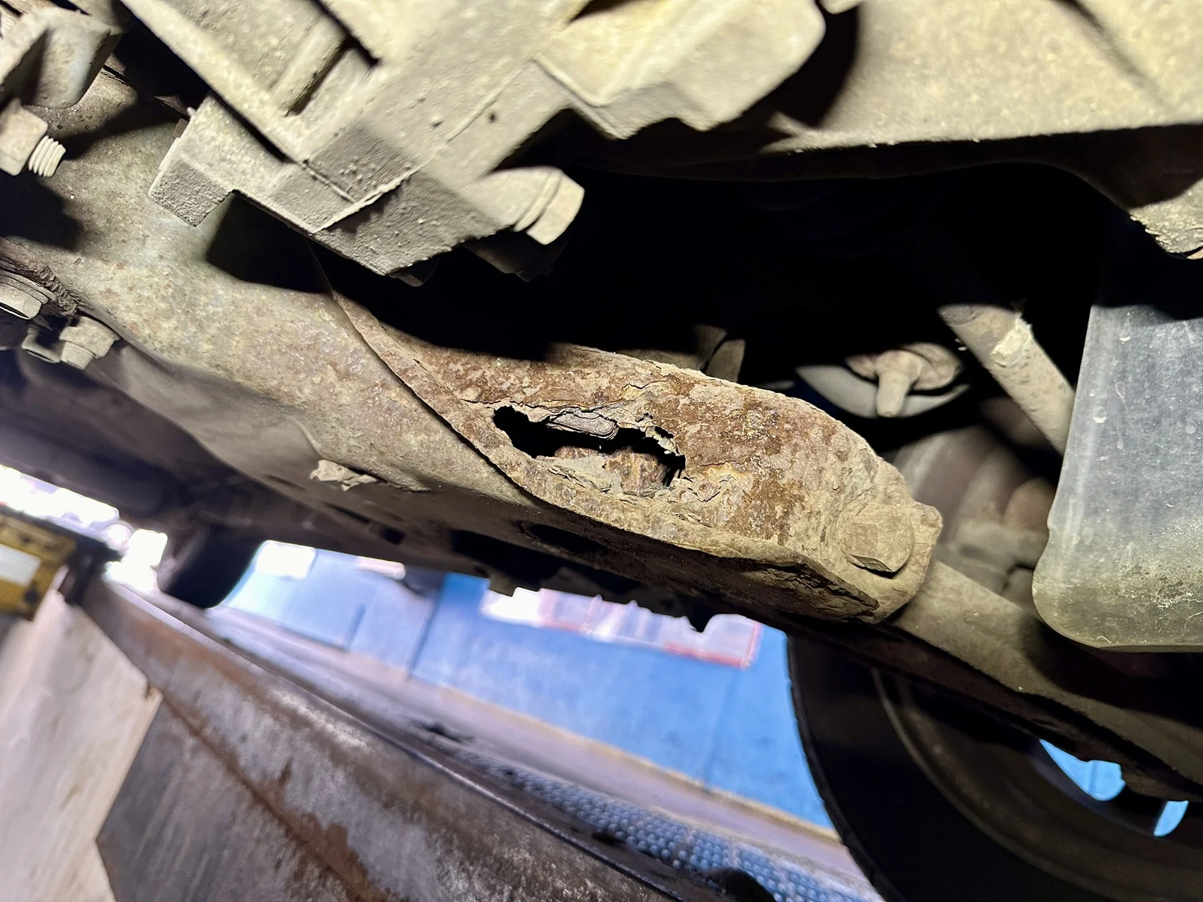

Not the sort of condition one wants their front subframe to be in, considering what's bolted on to it..

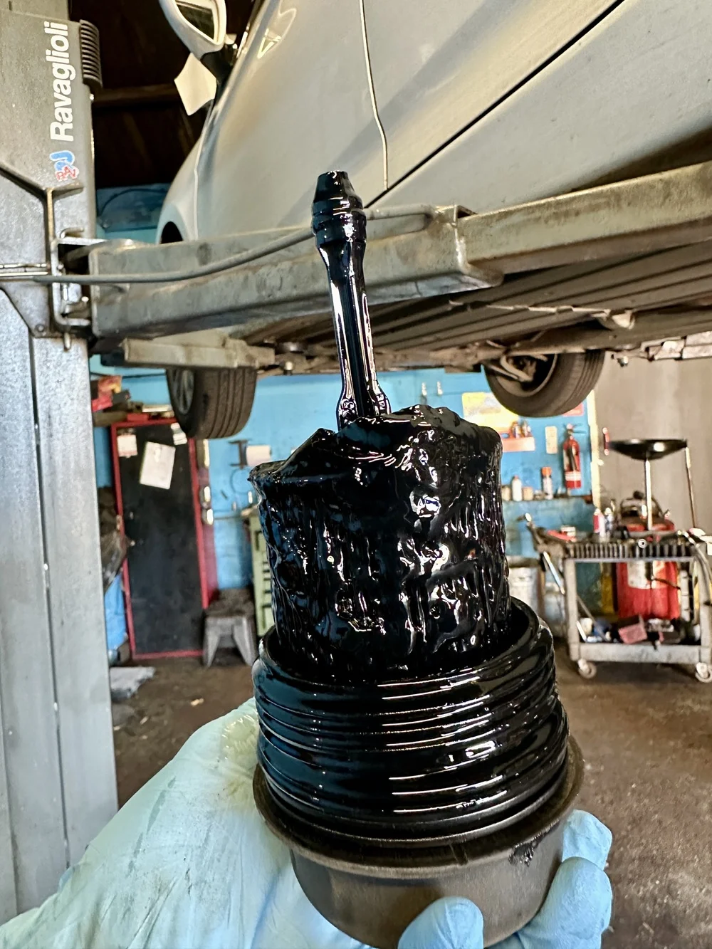

And not MOT related, but don't run a diesel engine for 40K miles without a service or topping up the oil..
That filter and what used to be oil is completely solid!
Eek, what car was that on?

The car was owned by a young girl who came in with her grandparents and had just recently passed her test.
I stopped the MOT at this point (no point in charging the MOT fee and continuing) due to how serious it was and the costs involved and explained the problem to them, only to be met with floods (and I mean a tsunami) of tears from the owner :(
We priced it up with parts from our suppliers, and it's unsurprisingly an uneconomical repair.
I can't comment on the owners private life, but after speaking to the grandparents. that car is her life and she'd found her independence owning it.
I've had a nose around and found the subframe a lot cheaper, and will speak to my boss (long time friend) and see if there's anything we can do to get it through the MOT a lot lot cheaper for her.
I usually couldn't give a rats ass about failing a car, but that one hurt a bit as she was so upset.
To be honest, for a lot of people this is horrendous. But for those with a little bit of knowledge of cars, this is just a bit of an inconvenience. A rear subframe can be obtained second hand for most cars for very little (£50-100?). Then a couple of hours labour to fit it and you're away
2016 Hyundai i40
To be honest, for a lot of people this is horrendous. But for those with a little bit of knowledge of cars, this is just a bit of an inconvenience. A rear subframe can be obtained second hand for most cars for very little (£50-100?). Then a couple of hours labour to fit it and you're away.
It was the front subframe, so a little more labour intensive, but certainly not overly difficult.

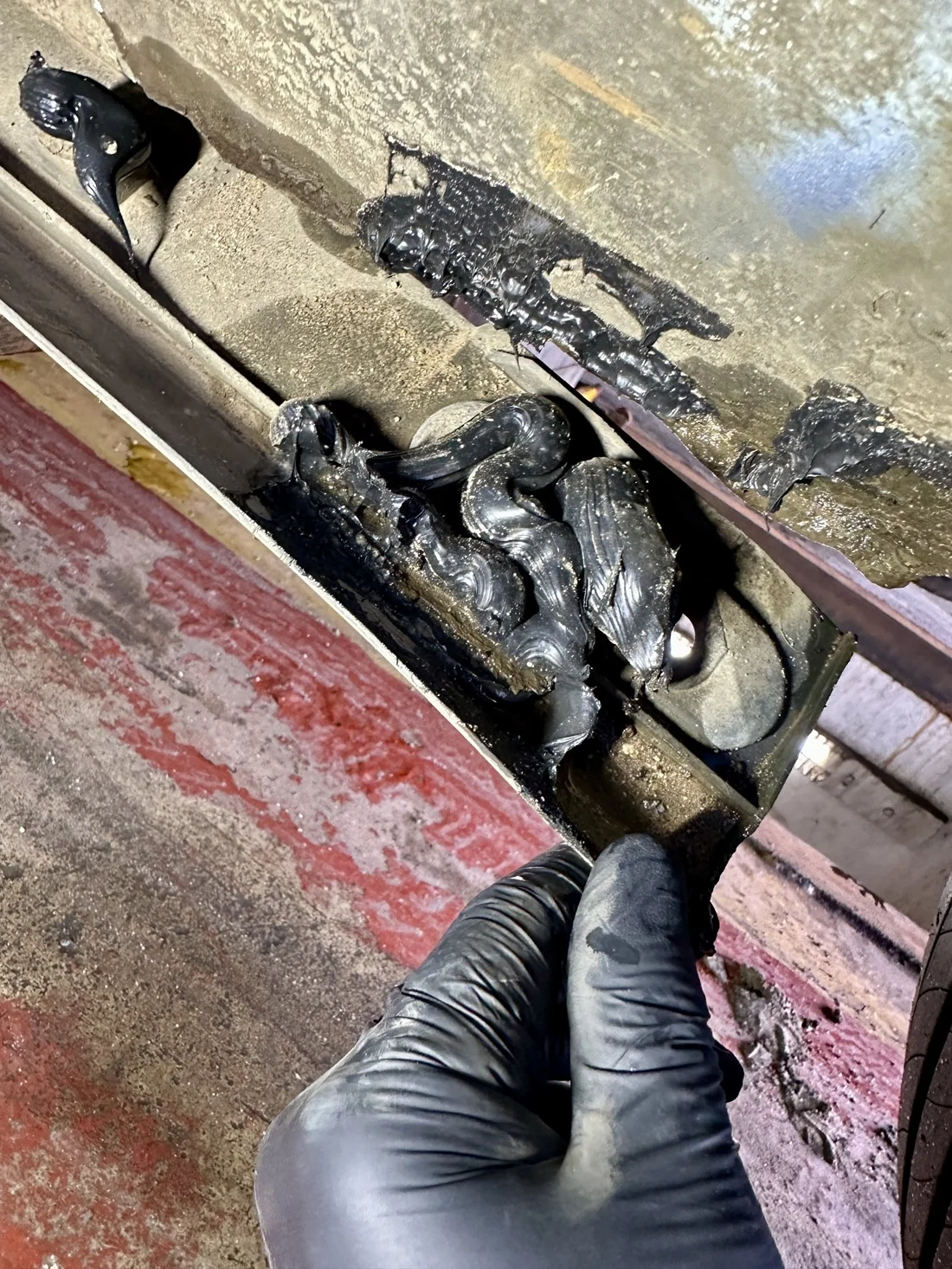

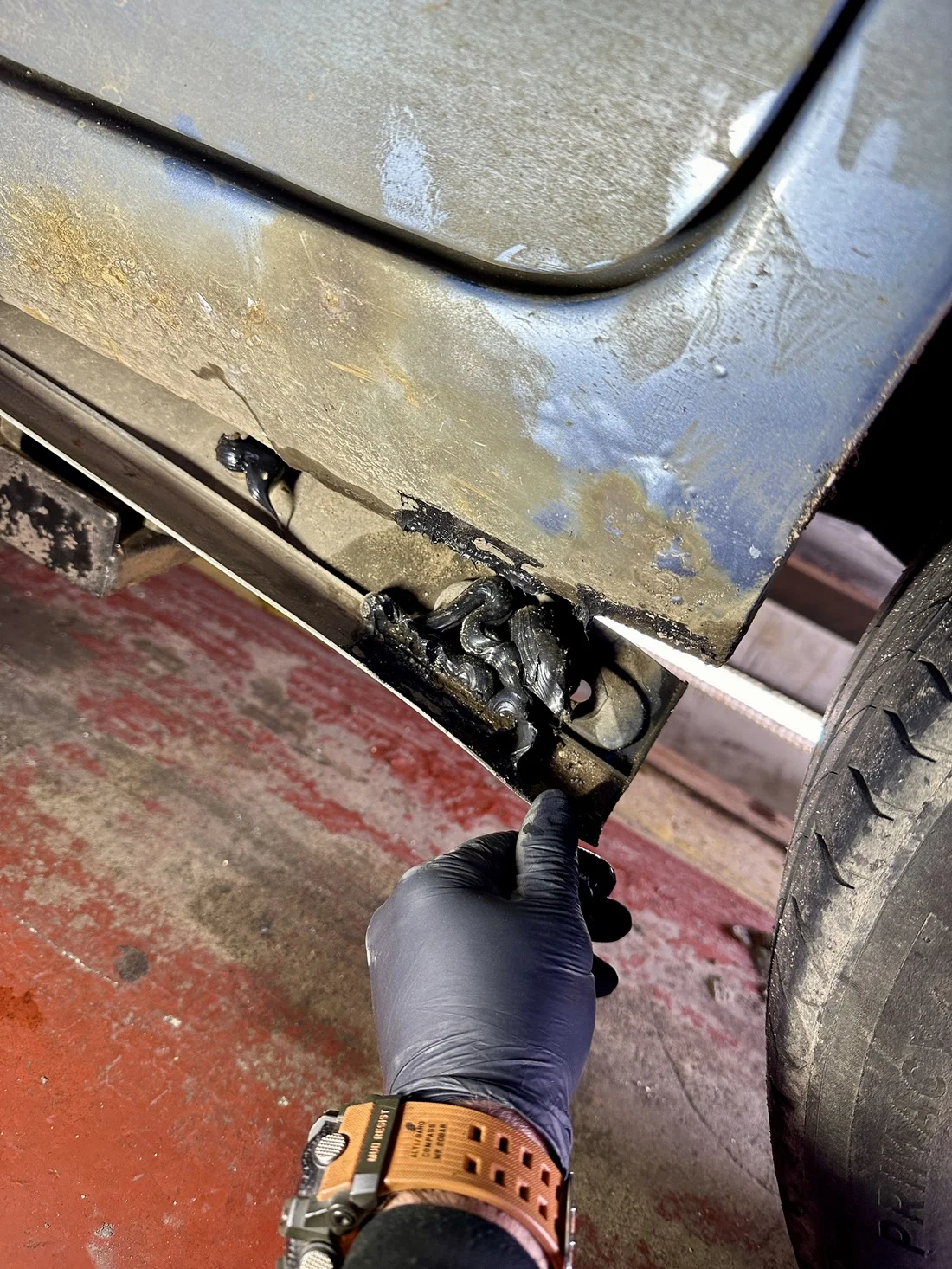

A bit of silliness from today.
The best thing to do if you've got a 12 inch part of your sill completely missing through corrosion is to try and hide it behind the plastic sill cover using Tiger seal (or whatnot), but do remember to put the said sealant where it'll actually adhere to the sill and not where the 12 inch hole is..
It came in with the sill cover hanging down.
These people walk amongst us :eek:
