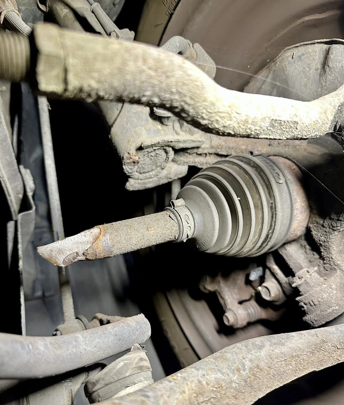

Anyone spot the problem here? (it happened pulling out of the roller brake tester)..
I'm guessing that's supposed to be connected to something? :D

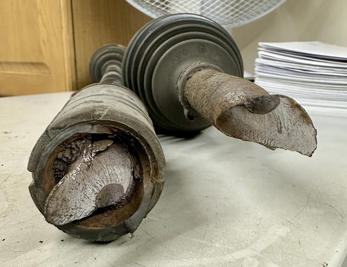

And the reason it happened (it wasn't the vast amount of torque the little Honda Jazz was producing)..
Water has got into the driveshaft damper, and it's corroded from the outside in.
The shaft is way thinner/weaker than it should be, and the customer is lucky it happened during MOT and not out on the road.
Gave me a bit of a shock though :eek: :D
It's the same as why coil springs snap, water gets under the paint/powder coat and it just rusts away.
I was always thinking about this on my FN2, they suffer the same issue of corrosion under the vibration damper and the shaft snaps clean in two. Happened on my mum's Civic too and that was in about 2000 when it was five years old.
This was a massive problem with Nissan Primera's too. I still have a brand new driveshaft in my attic and the car was scrapped 10 years ago! I bought it as preventive maintenance but never had to use it/got round to fitting it.

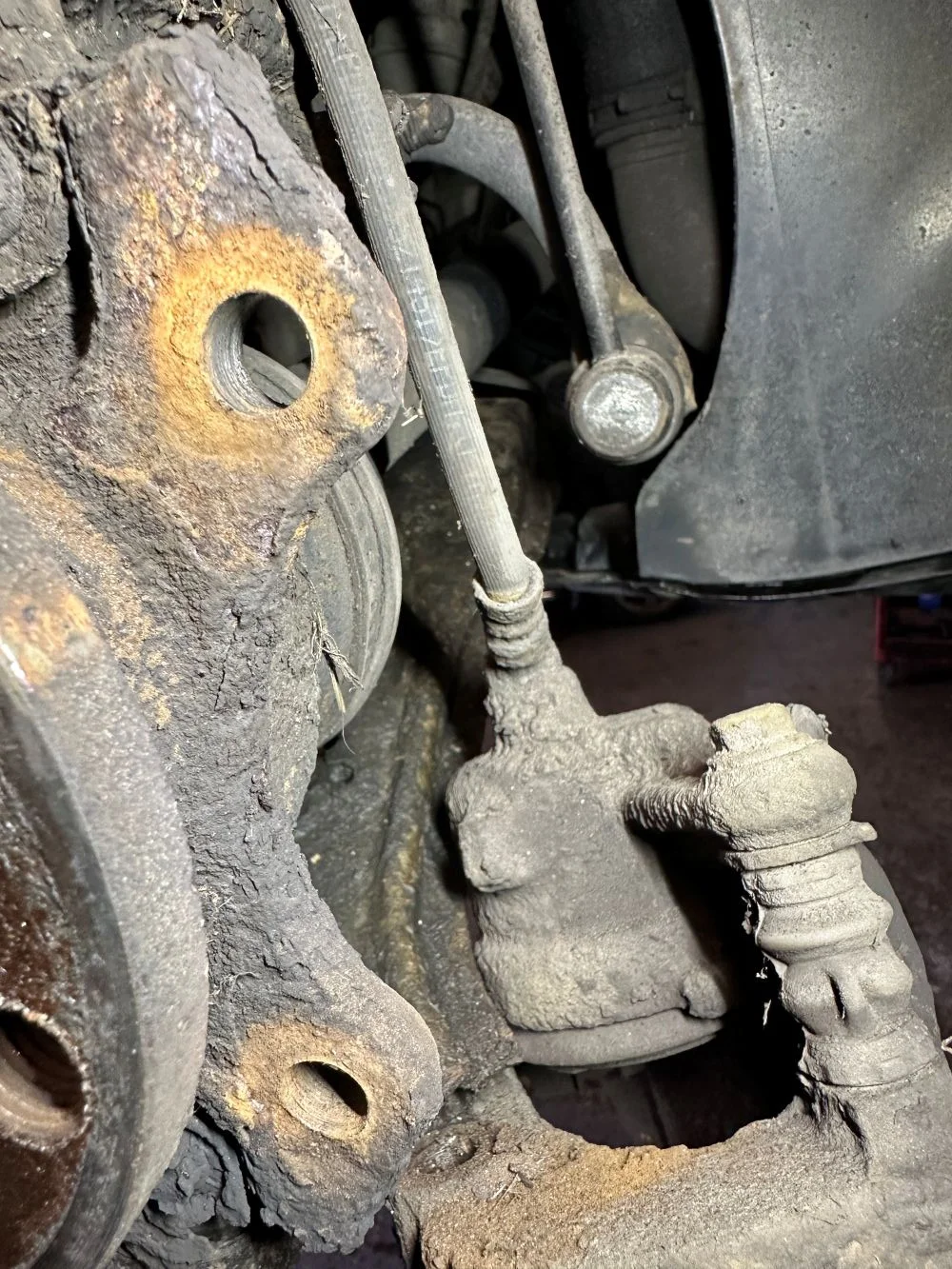

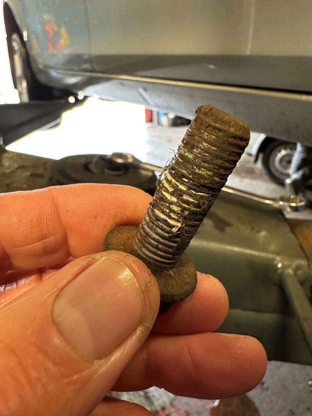

I MOT'd this Skoda and it failed on excess fluctuation on the OSF brake during the roller brake test.
So my colleague stripped it down and had a look.
As you can see when the home "mechanic" removed the caliper & carrier and then fudged it back together again there was a slight issue..
Those two holes in the steering knuckle are supposed to have thread in them!
So instead of replacing the knuckle he'd presumably cross threaded one bolt in so it just about held the caliper carrier on, and the other he'd used some sort of (I kid you not) what appears to be bathroom silicone sealant to retain it..
So under braking load during the test and whilst driving, the caliper was trying to make a break for freedom and detach itself, hence the fluctuation.
The only way to sort it was a new knuckle, hub and bearing, so he hardly saved any money by trying to do the job on the cheap!
And god only knows how this wasn't picked up as an advisory/failure on the previous MOT (different car)..

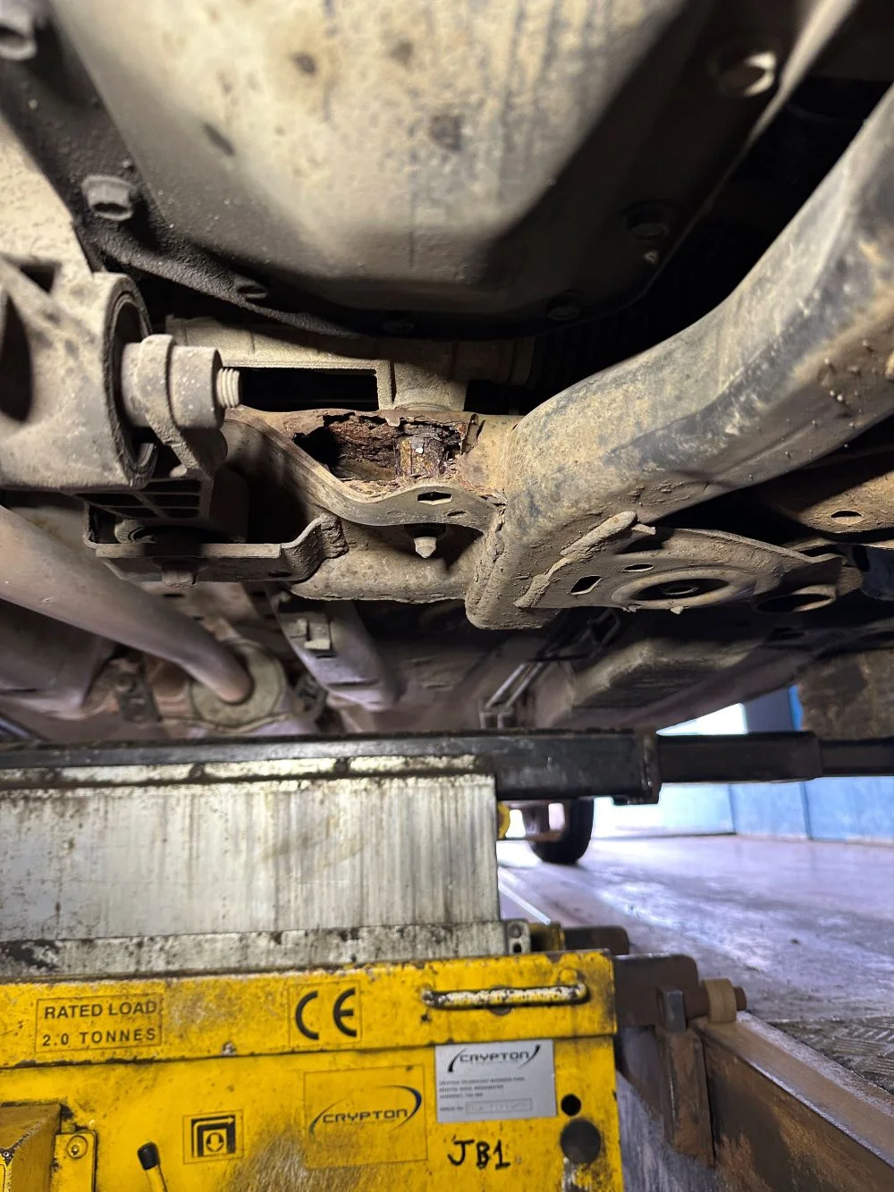

Quite rare to see a subframe in this condition (that's directly where the steering rack is bolted on to).
It's a Corsa in case anyone was wondering.
  • Haha
Reactions: IC3
And god only knows how this wasn't picked up as an advisory on the previous MOT (different car)..
As per your recent post about the snapped driveshaft and coil springs you can't always see what is going on internally with metal - it might have been corroding away behind/inside until it finally came apart.
One of the problems sadly with the D40 Navaras and Pathfinder on the same platform, the rails rot and weaken without always outwards signs before they snap or holes start appearing.
@JonRGV250
With that brake job, how?????????
I'm NO mechanic but I've done brakes plenty of times, baring excess copper grease maybe (I still think it's fine) but jesus how do you not realise you need to replace the bolts on the same place they came from?
Anyway, we all know it wasn't his "mechanic mate".....
