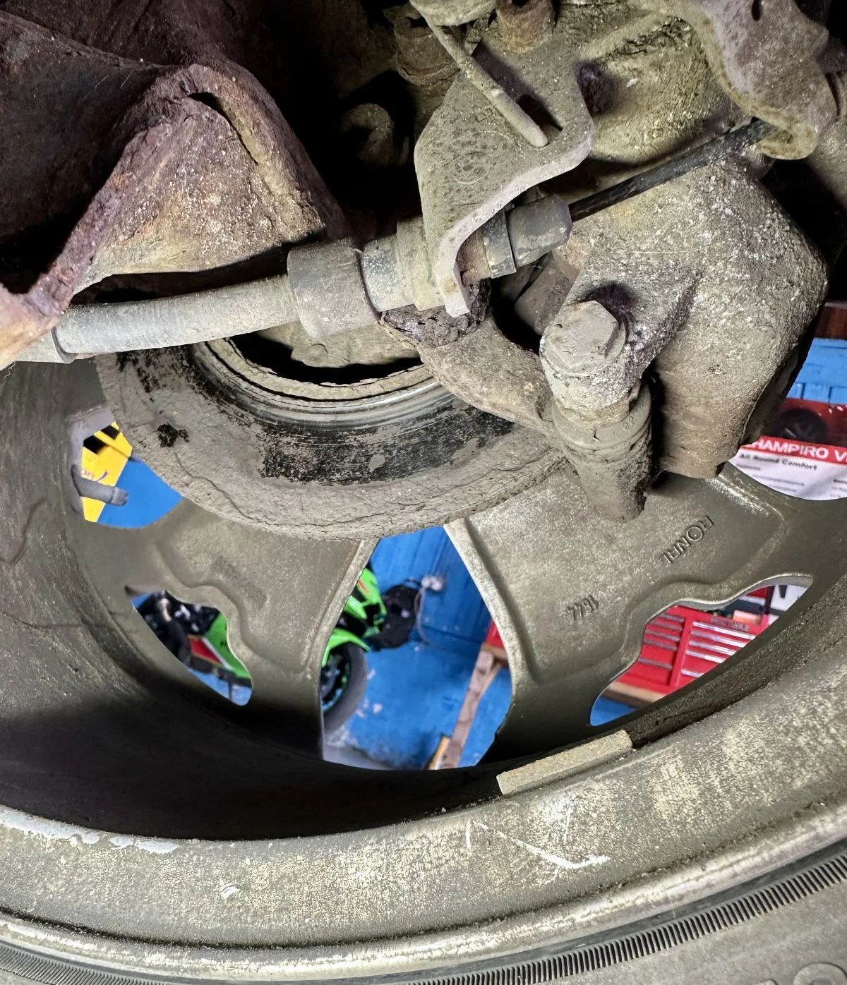

As per your recent post about the snapped driveshaft and coil springs you can't always see what is going on internally with metal - it might have been corroding away behind/inside until it finally came apart.
I agree, It 100% was, and that hole wasn't there before I put my finger through it, but it was so obvious (or should be) to any tester the previous year that it was, or was about to be a problem.
Anyway, we all know it wasn't his "mechanic mate".....
Ha, I should imagine you're right!
There's always an excuse.

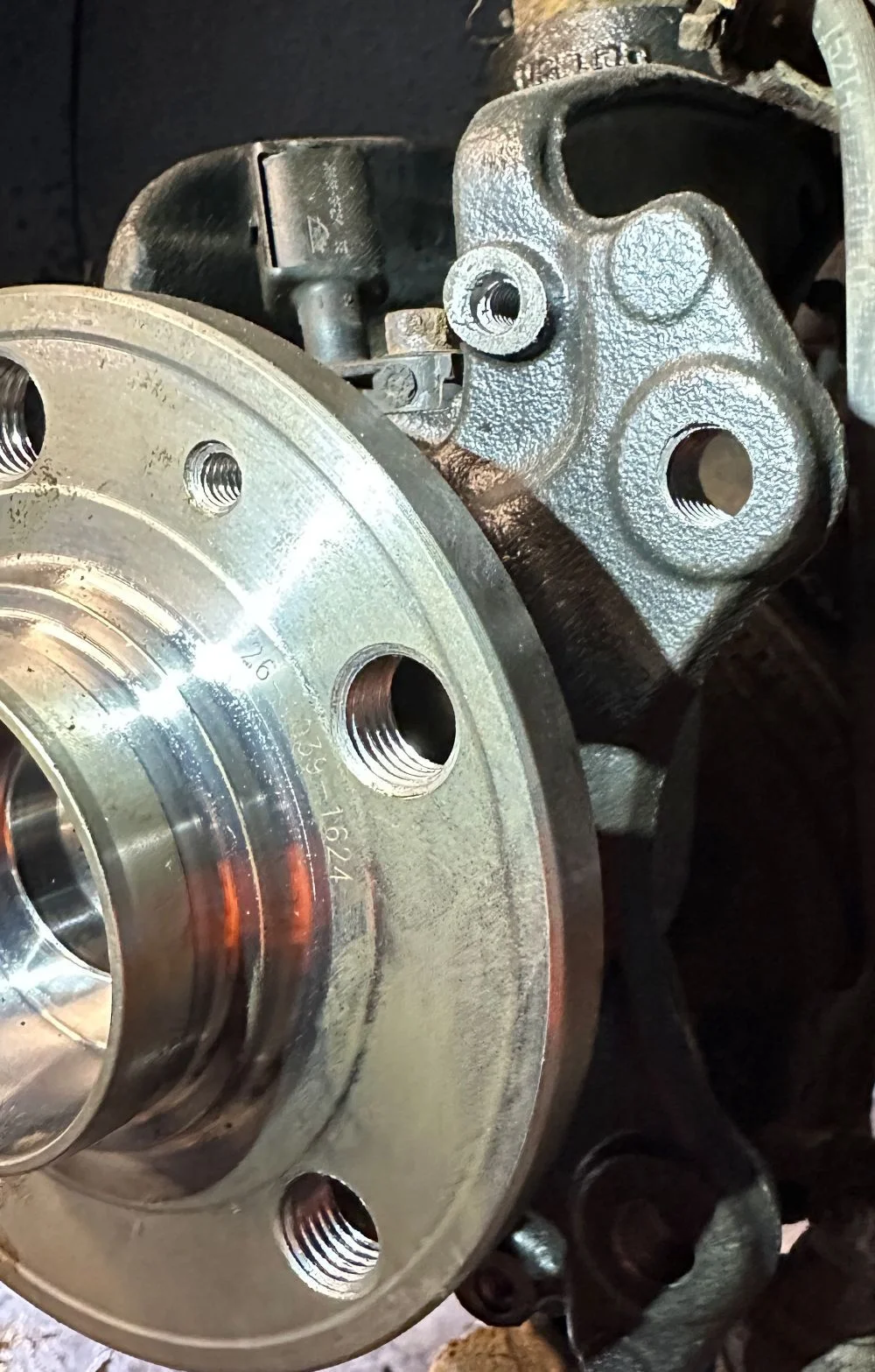

This is the new knuckle/hub with actual threads that we fitted to hold on the caliper & carrier, not cheap!

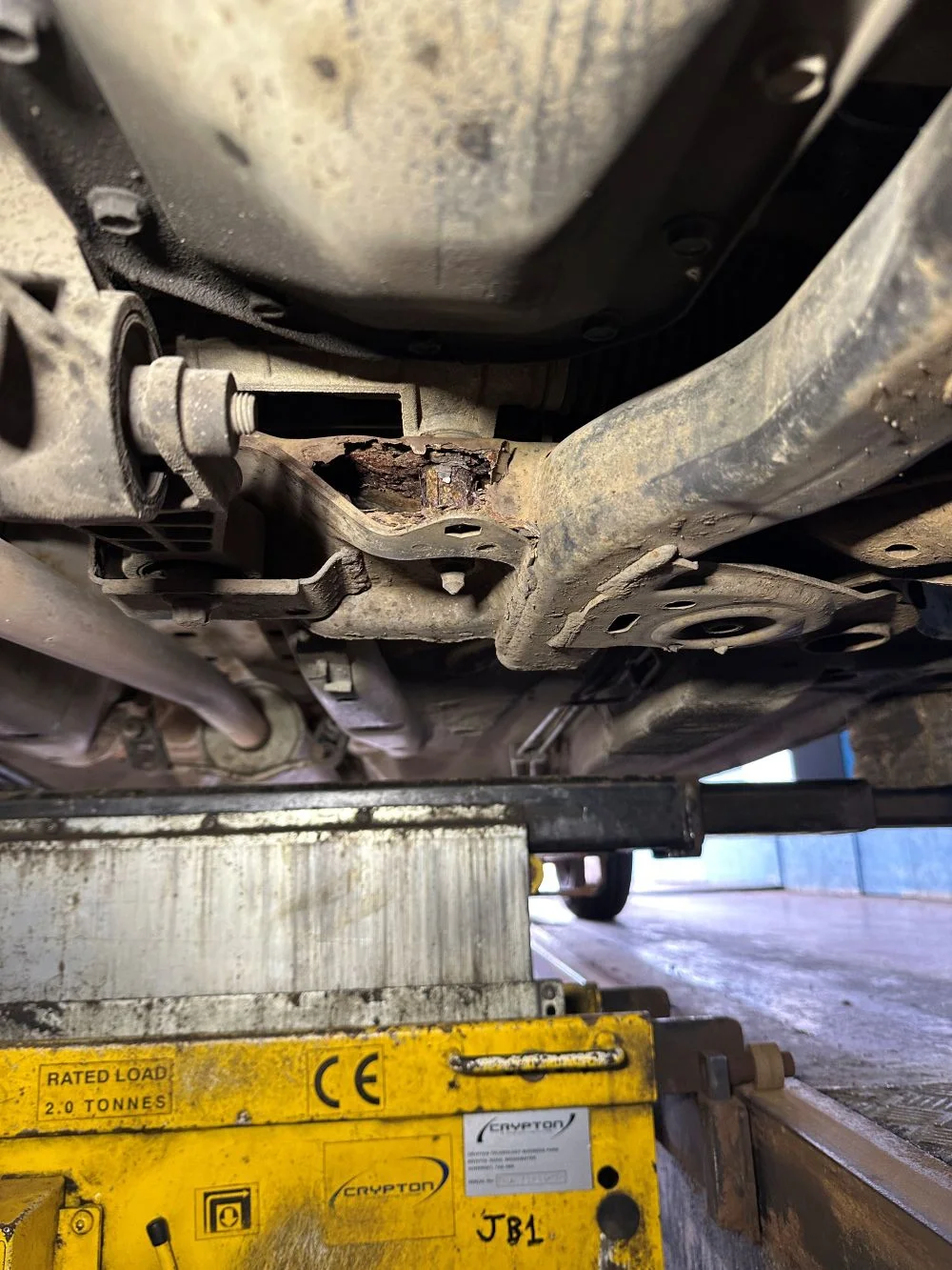

And god only knows how this wasn't picked up as an advisory/failure on the previous MOT (different car)..
Quite rare to see a subframe in this condition (that's directly where the steering rack is bolted on to).
It's a Corsa in case anyone was wondering.
