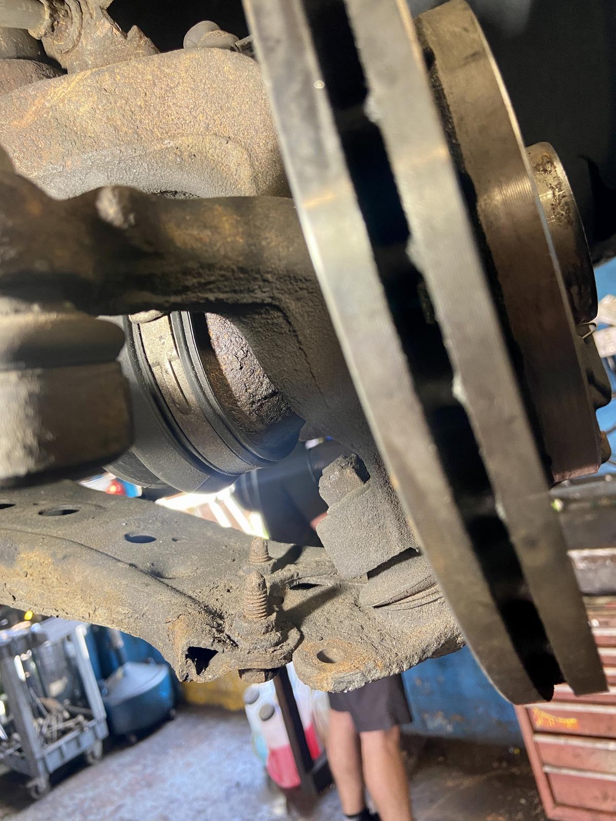

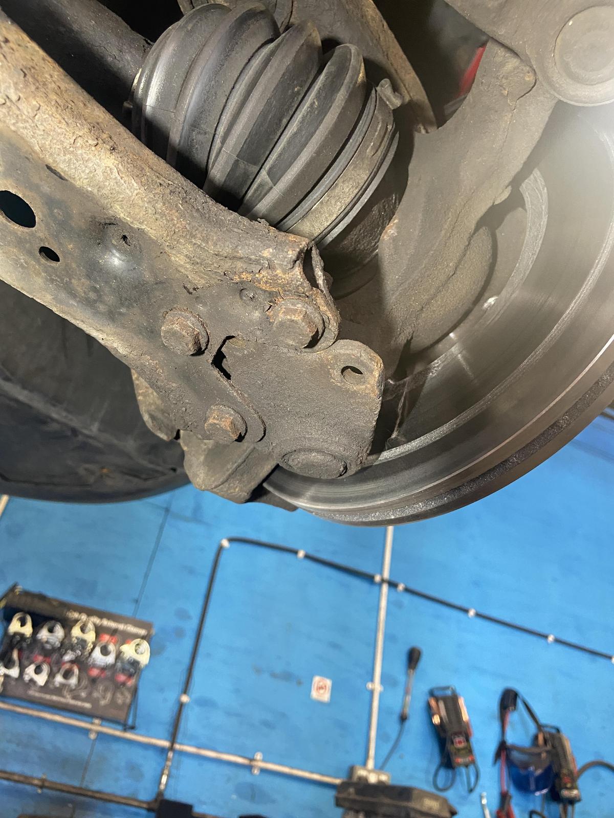

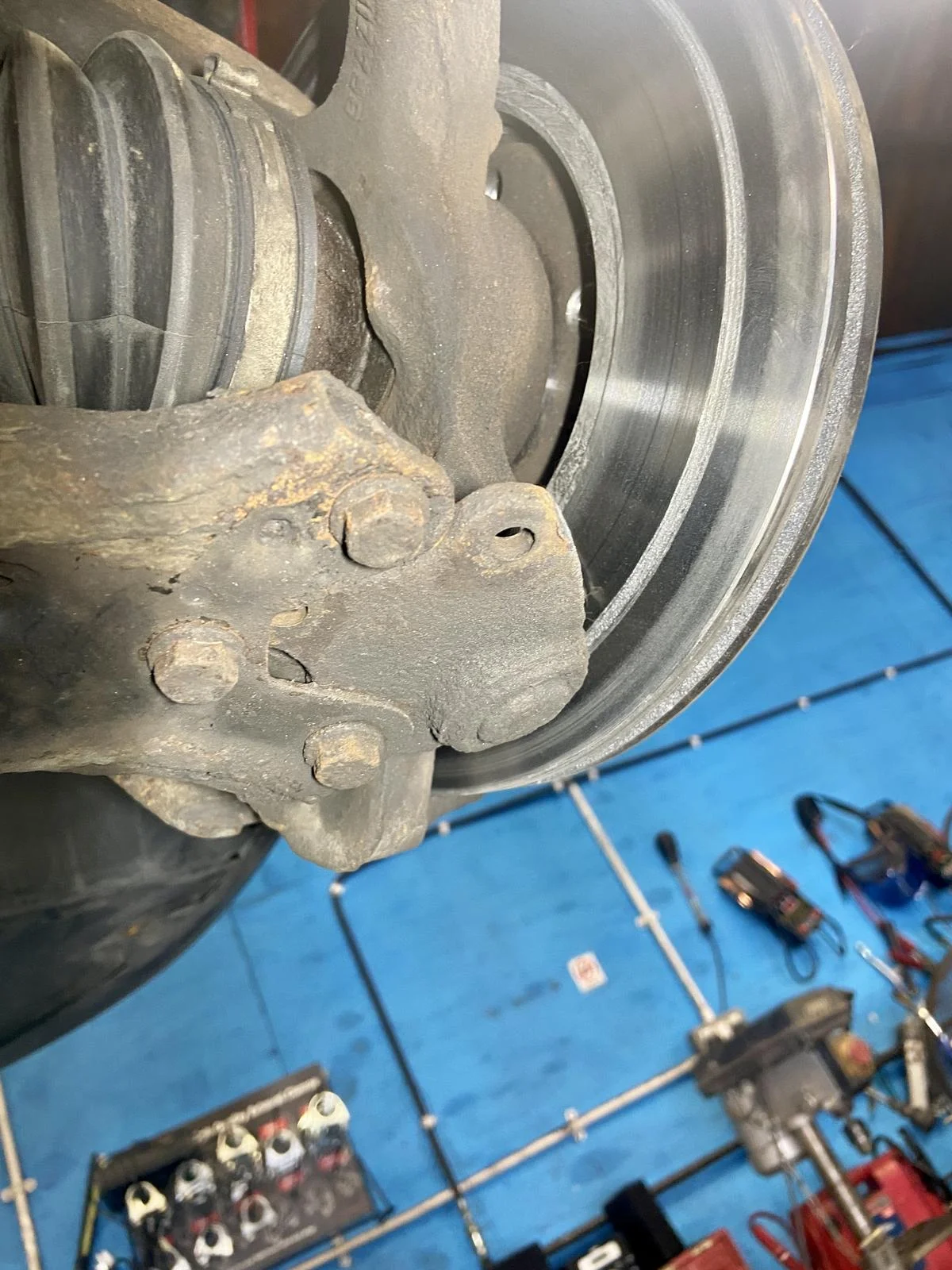

A customer brought a car in today that they'd just bought from auction and was complaining of it pulling to one side and also grinding when on right hand lock.
It had brand new pads and discs fitted and it's almost unbelievable that who fitted them didn't notice a certain problem.
I'll let you guys figure it out..
Some people really shouldn't be allowed near a tool kit!

Either completely the wrong discs, or venteds when it should have solids.
Don't worry, the wishbone will machine it away ;)
The disc is correct as are the suspension arm and bottom ball joint.
The problem is that someone has removed at some point the BBJ and has only used one of the 3 bolts to connect it again.
2 of the bolts are fitted to the arm but not to the ball joint, so its gone well out of alignment and is rubbing on the disc when on right hand lock.
Not all dangerous then.
Sadly I see stuff like this all too often.
It wasn't even pivoting as that single bolt was done up so tight.
There was no movement, even when the disc was grinding on it :rolleyes:
I meant with one bolt in theres a chance to pivot when doing it up and misalign the other holes. If two bolts were bolted correctly, the 3rd hole would have no choice but to be in the right place. If you get what I mean.
I do, but I'm still amazed that anyone could be that stupid, despite seeing such poor workmanship more times than I care to remember.
Don't most people learn to do stuff right when Building Lego or Meccano? Surely common sense comes into play at some point?
