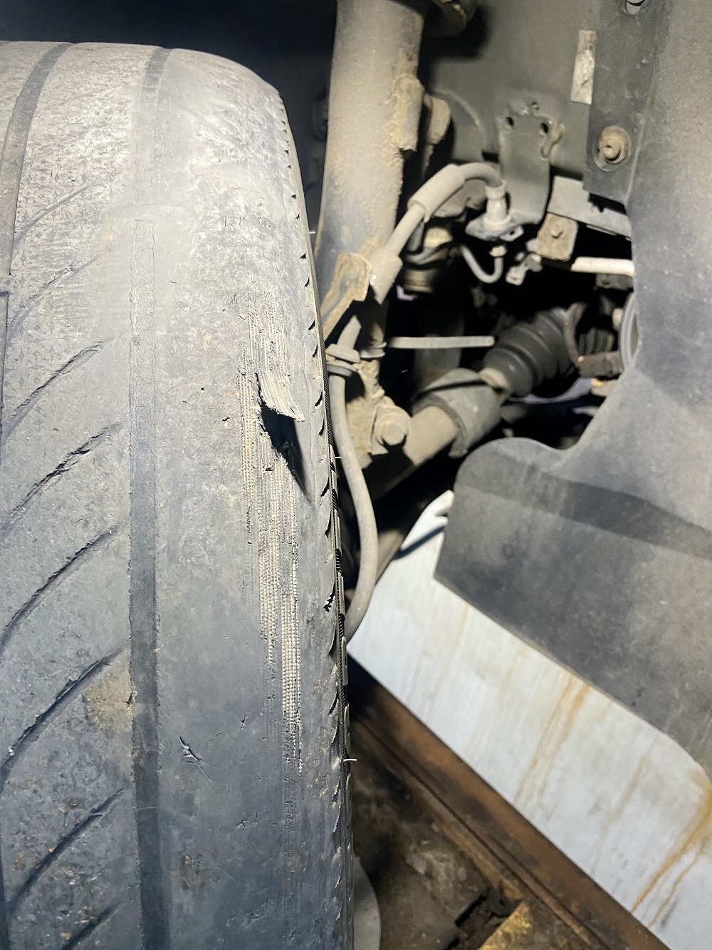

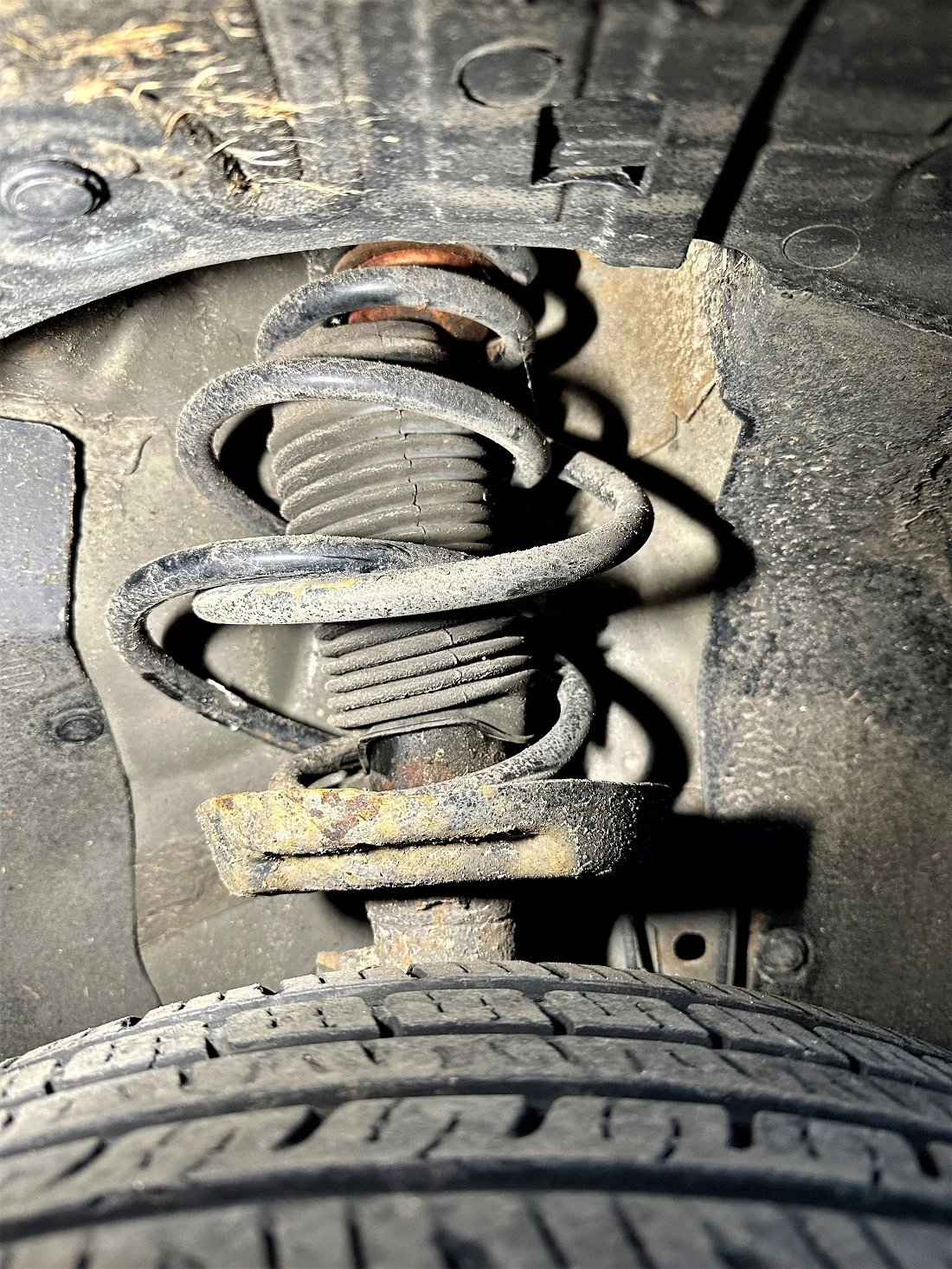

I'm trying to work out what's wrong with the suspension from that pic? Also I find most workmen I've dealt with tend to have mucky vehicles (I guess plastering probably being one of the worst as that dust gets everyehere).
The garage that fitted the new shocks had somehow managed to fit the bracket that holds the speed sensor, pad warning wire and brake hose incorrectly, which has caused the anti roll bar drop link to bend as its fouling on it.
Also the speed sensor wire is pretty much crushed, but still not faulting.
It takes a special kind of stupid to do something like that!
It's almost a piece of art, albeit a very dangerous one..

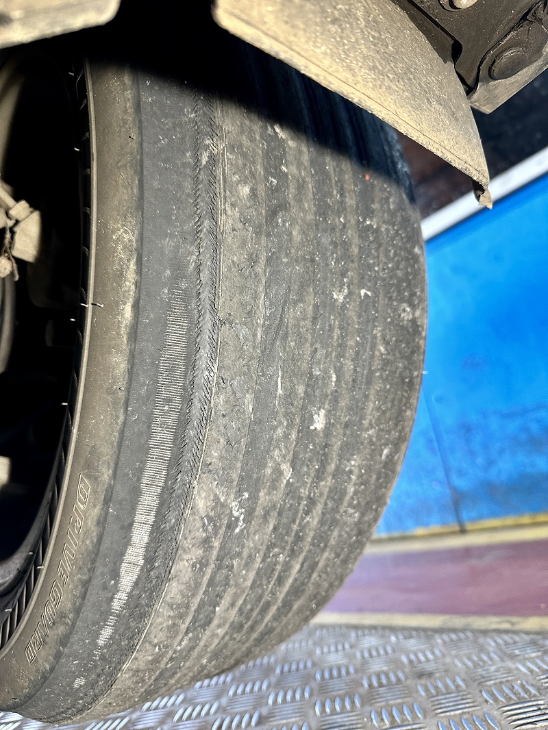

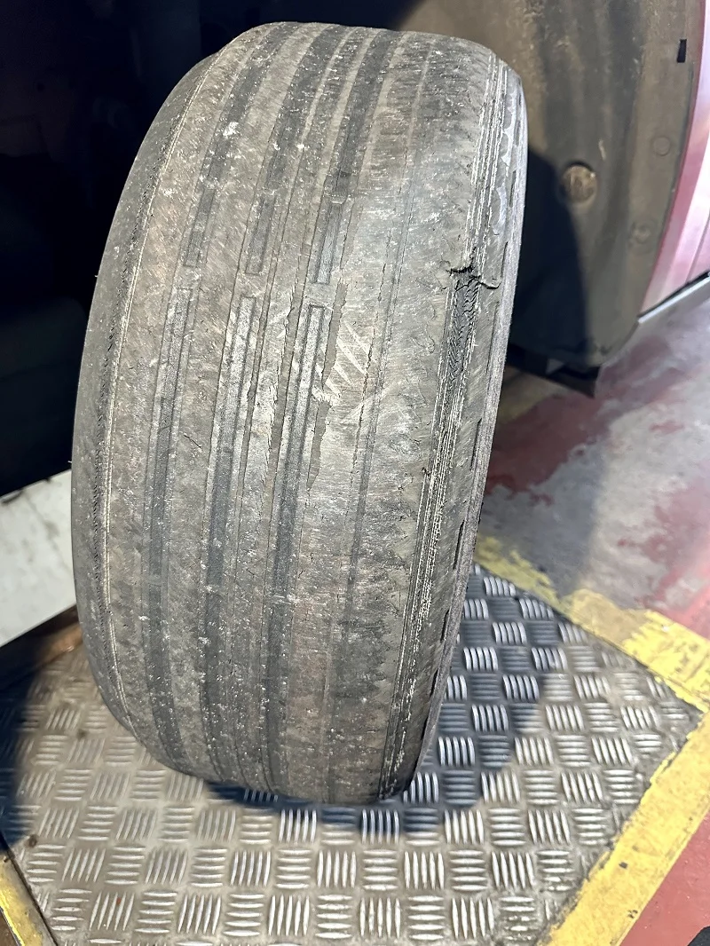

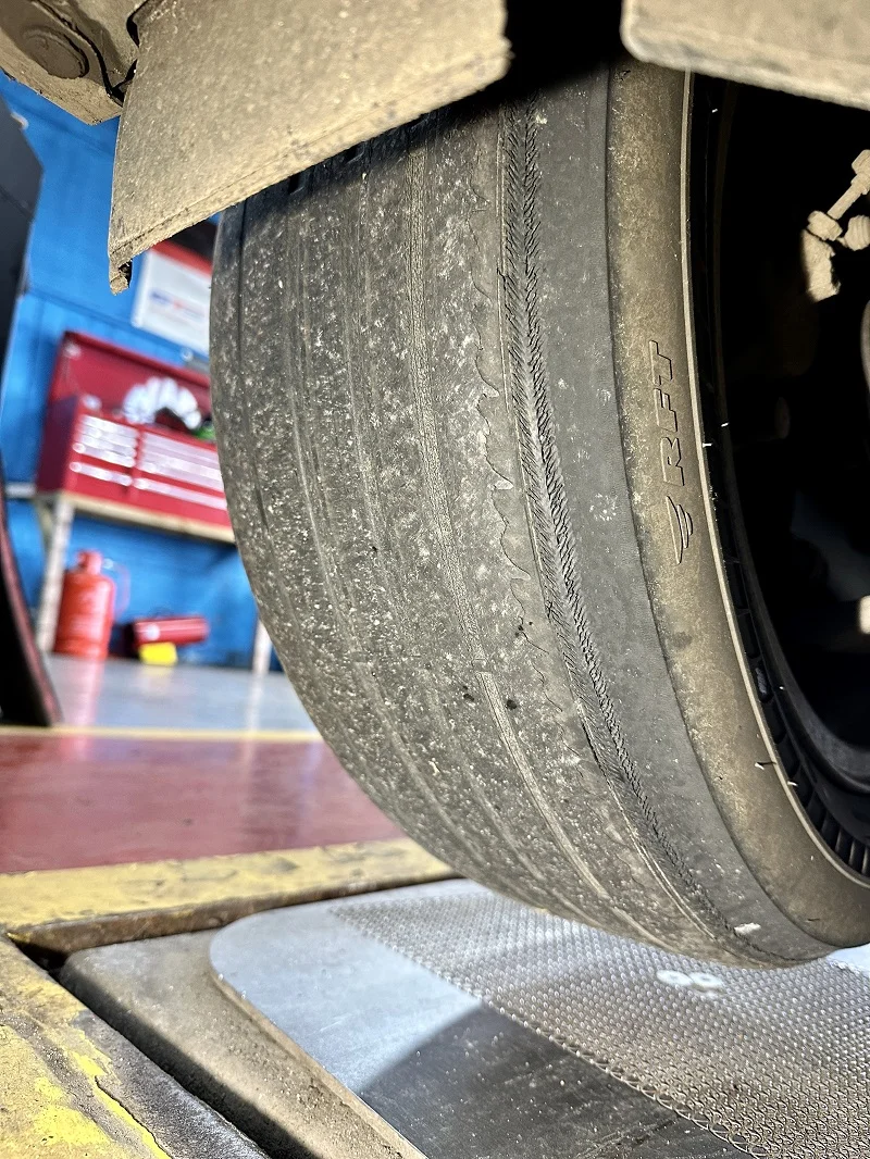

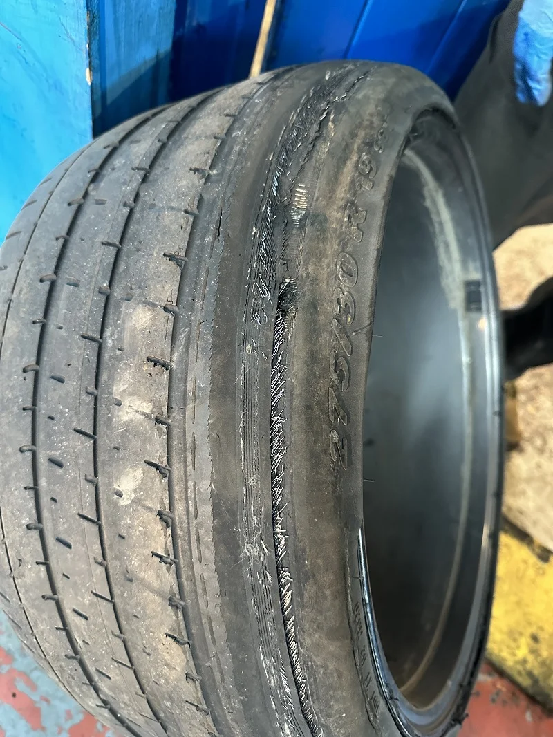

These 3 tyre's were from the same vehicle, and that vehicle had 2 child seats in the rear..

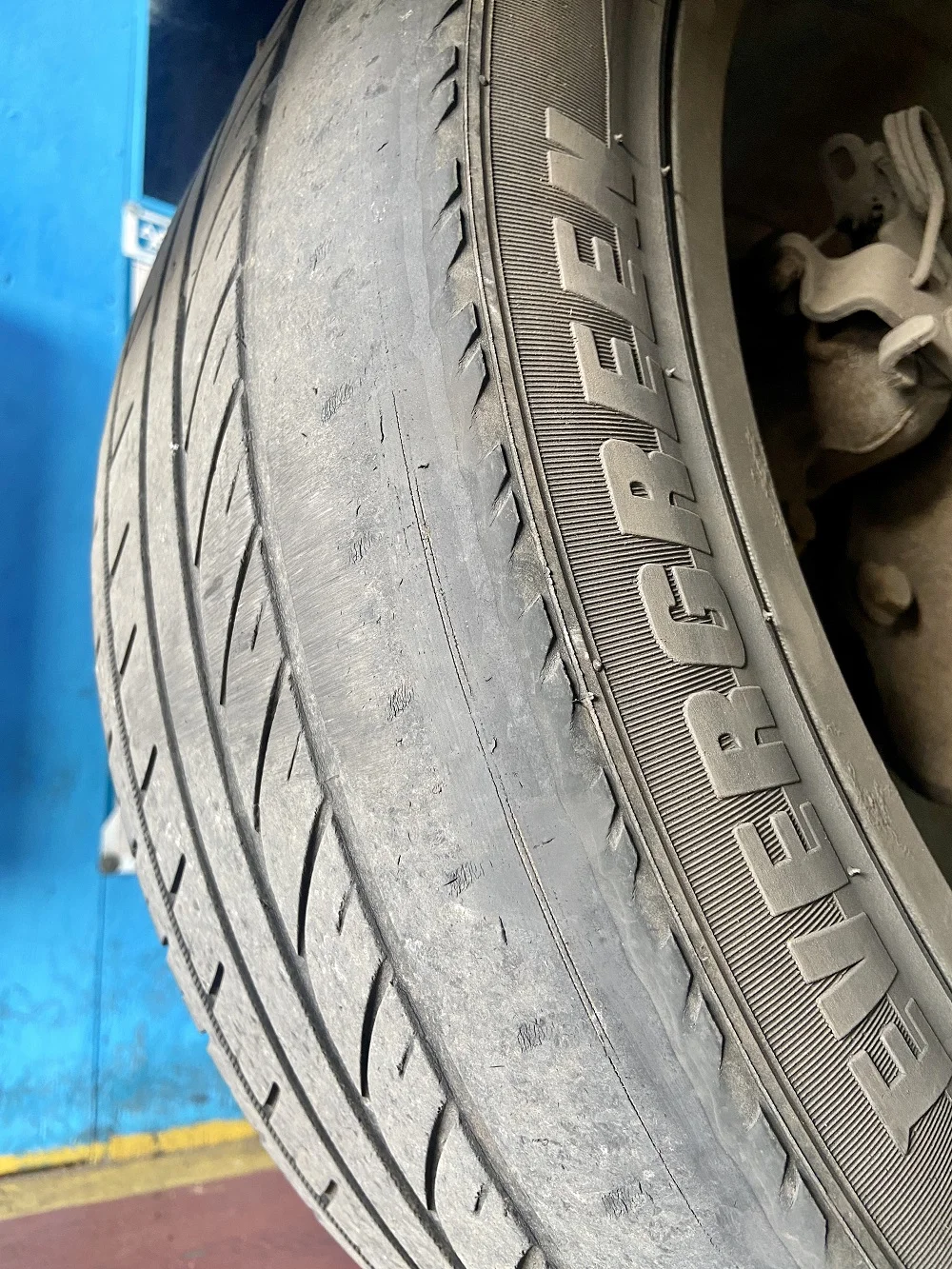

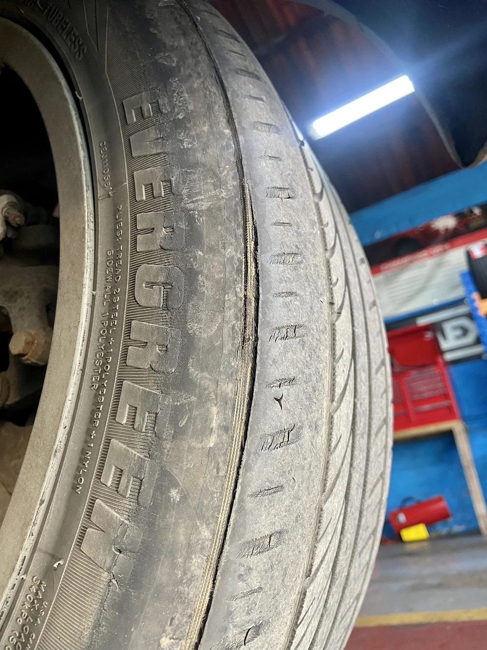

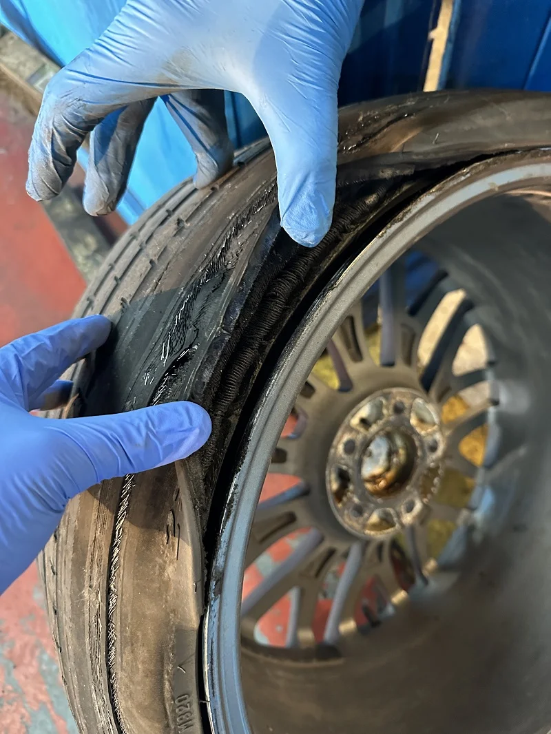

More utter madness from today..
OSF tyre..
NSF..
and different shot of NSF tyre..
Never checking your tyre pressures have that effect!

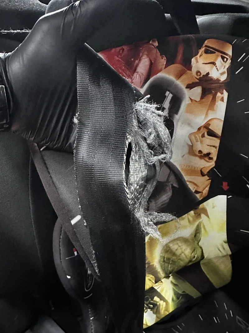

Next up.
There are 3 things in this pic, my hand, a child seat and a seat belt..
And just when I thought today couldn't get any more ridiculous...
