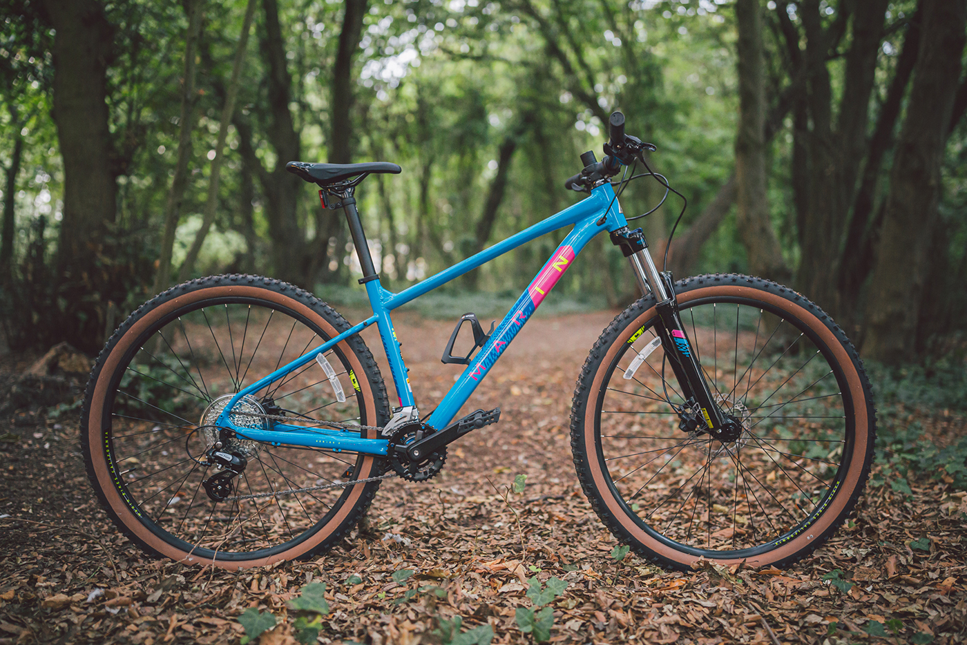

Here's a pic of the bike now which I think honestly looks much cooler with these tyres than the ones with the stock tanned sidewalls.
Compared to how it was when I got it:
I'm gonna take the rear mudguard off because whilst it helps with keeping spray off the midframe, it's not that great for my seat and backside as I discovered today. I've also ordered a new saddle (Prime TI Endurance) as this one does get uncomfortable after a 2 hour ride of cross country. And new grips as cringe every time I bang the aluminium ends on these RaceFace ones so ordered the blue Half-Nelsons which have plastic capped silicone ends instead.
Other than that there's nothing else I need to do to the bike, it is now perfect for my kind of riding :cool:
