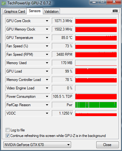

I then returned everything to stock values, to see how high the temps would go....
I was runnig fur mark, to generate some gpu activity. After 2 secs the temps hit 51 degrees :(
I left it running for 10mins and it hit 80 degress, screenshot:

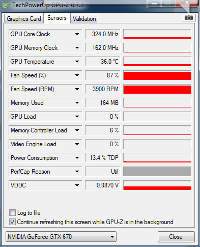

I then left the fan running at 87% to get the temps down, and at idle with a fan running at 87% the temps only went down to 36 degrees!
I then set the fan back to auto to see how high the temps would go when idling and it got as high as 40 degrees before coming back and settling at 37-38.

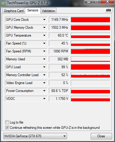

Anyhow. While typing this i think the render things reached its peak at heat at about 61c.

Thanks for the advice, I opened the case and it made no difference, still temps >75 degrees within 1 minute of running fur mark.
