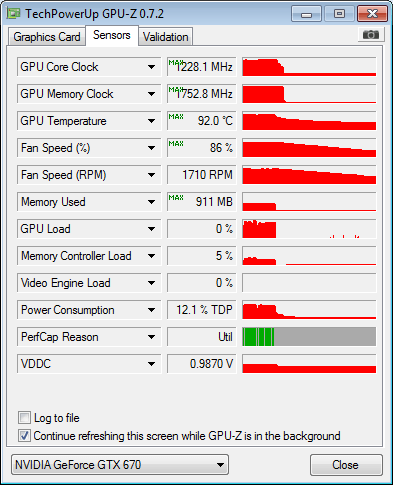

Just got around to testing one of my new cards:
Not bad, although it is loud, much louder than my ref 670 card.
And that was with +83 clock and +499 memory, everything else stock.
Mine is very quite. I cannot hear it when gaming. Your temp is showing 92.c which is a bit hot especially with the fan at %86. Tbh something is not quite right there...

92 degrees!!
Too hot. These should run just under or around 70 with the fan only going up to 50%

Also, just for reference. I just got a new case (NXZT 630 Phantom) and even with the fan controller on the case on silent mode/low my 670 only got up to 62 degrees max after an entire run of heaven 4.0. This is with the stock fan profile but with core offset at +68 and memory offset at +350.
Far too hot. Tho what were u actually doing to make it that hot? Heaven benchmark gets it up to about 70 at the very end of the benchmark and thats "just". Was still pretty quiet as well.
At idle it should be around 30-35 degrees or so. If its more than 40 you either have bad airflow or a dodgy card im thinking somehow.
