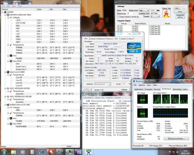

Flashed to the 1.8b11 beta bios today - at stock clocks atm, testing passive cooling options
anyone else have a wattage meter and one of these boards?
The new bios knocks my idle power below 195w (cpu volts @ 0.95)
was at 210+ with 1.4 bios - reviews says it's an Energy efficient 80watts at ldle NOT
lowest power draw at wall - durring intelburn (yes I do mean lower watts that at idle)
Blips in task manager are posting linpack output data (that takes 240watts for 1 second then back to 129w)
But oddly durring intel burn it DROPS to 129w (with cpu volts increasing to 1.192)
superPi burns around 216watts
furmark - 246 (460 @ 675/1350)
furmark - 268 (460 @ 850/1700)
New bios also shows gains in superPi 1M - 10.657 (10.89 with 1.4 bios)
but single threaded app's core jump, like crazy - with reduces the multi at default settings (35x most of the time) :(
1.4 bios - super Pi running
1.8b11 bios - super Pi just finished
Note the lower min (idle) and higher max (furmark) of the CPU vcore to 1.4 bios
