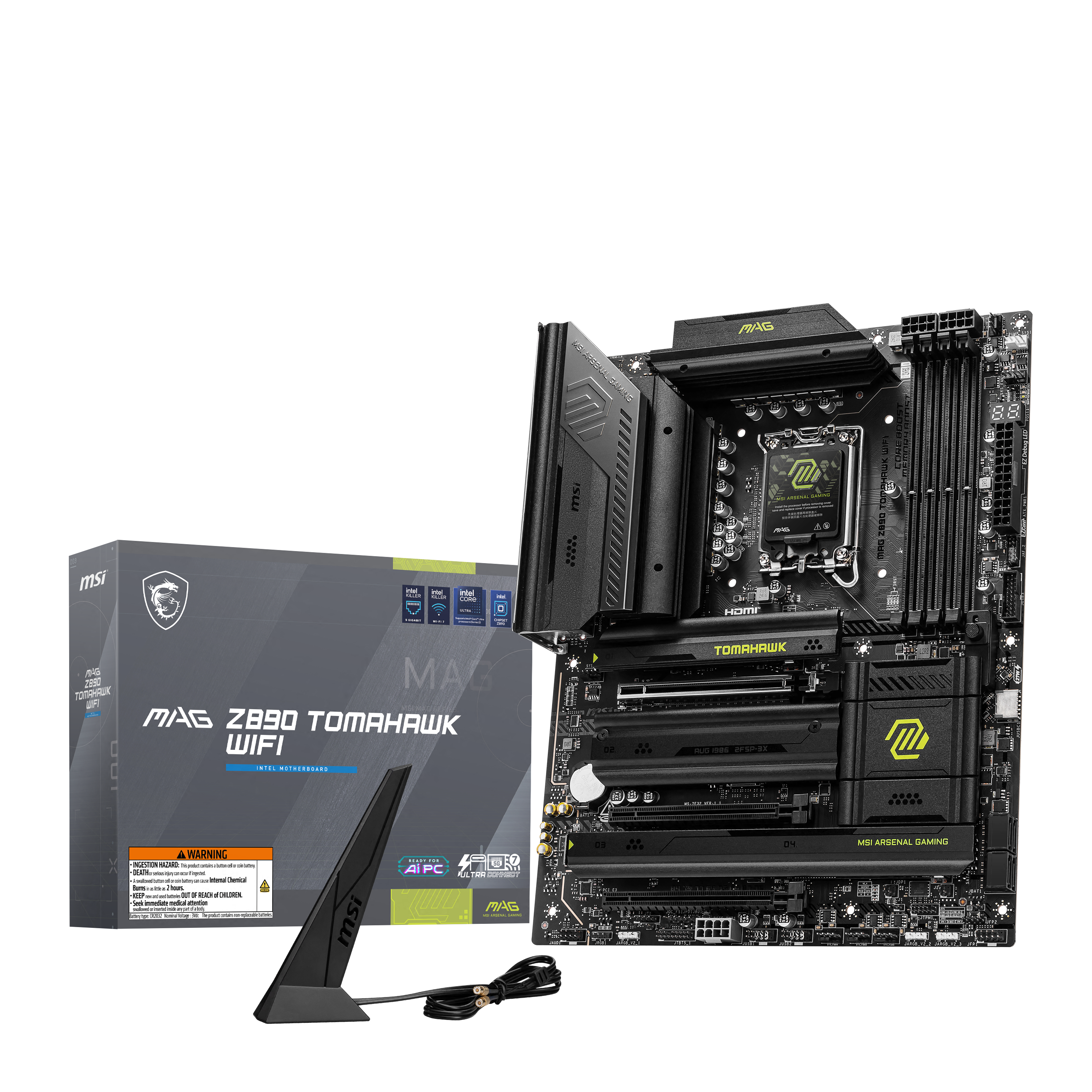

I have a new MSI Z890 Intel Tomahawk Motherboard and would like to add some LED’s. I have purchased a set of Phantek LEDs to match the case I bought and they don’t seem to work. I have tried board connections JRGB1, JARGB_V2_1 and JARGB_V2_2 with no luck at all. I did see a faint red light on the LED strip at 1 point but nothing other than that. I have tried MSI support but can't get beyond registration and the page errors.
Can anyone tell me what I may be doing wrong please?

There's two types of RGB.
- RGB, which is 4 pin and uses 12v.
- ARGB, which is 3 pin and uses 5v.
Phanteks unfortunately have their own proprietary connectors, which means they include adapters for the part that connects to the motherboard.
In the description on OCUK, this appears to be a RGB kit, which uses 4 pin and 12v, corresponding to the JRGB connectors on the motherboard (likely with an adapter).
BUT, the closest kit I can find on their website is actually a DRGB kit, which I believe Phanteks consider equivalent to ARGB and uses 5v. Again, an adapter might be required and it corresponds to JARGB (Rainbow) on the MSI motherboard.
If you're able to confirm which type of kit you have, that would tell you which connector to use. Please don't try both without knowing though, because you can fry stuff.
