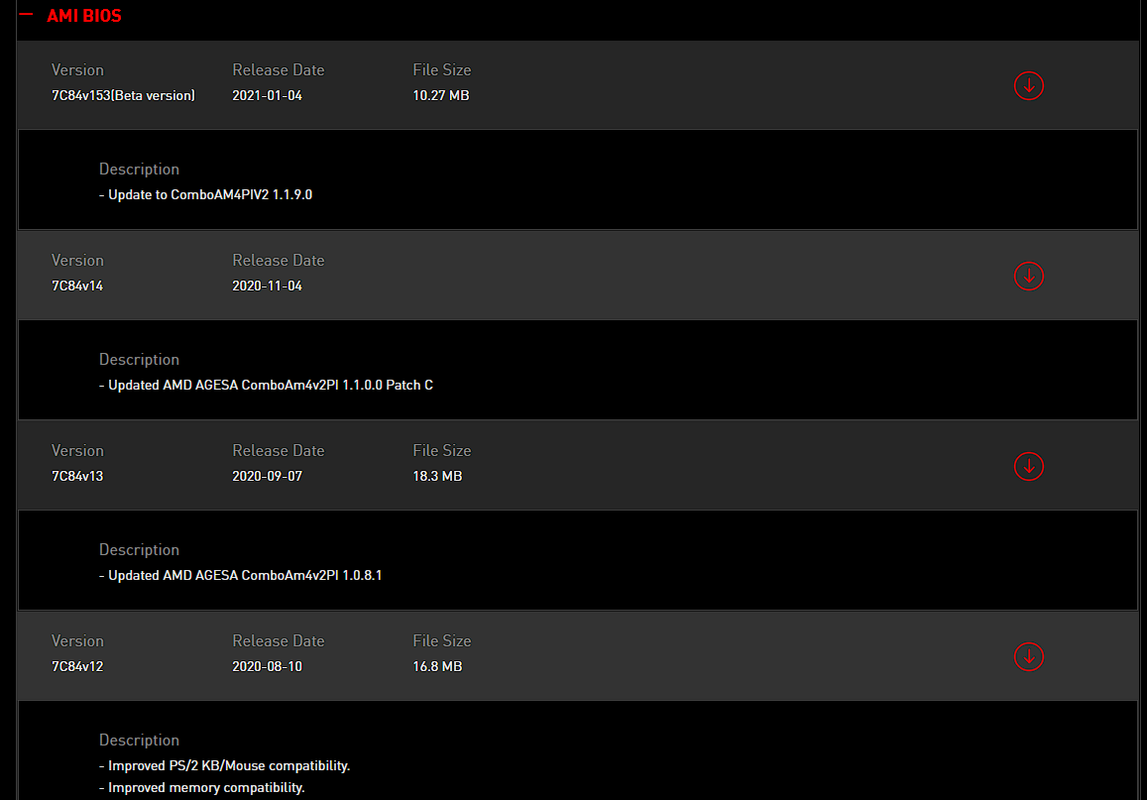

Also, why is the latest beta only around 10 MB down from around 18 MB in the previous normal versions?

MSI haven't released a regular BIOS for this board since November 4th? :confused:

BIOS 1.40, dating from the end of last October is not stable with my Ryzen 9 5900X.
Their BIOSes do not even state that they support the new 5000 series, no mention of SAM, nothing.

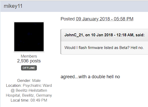

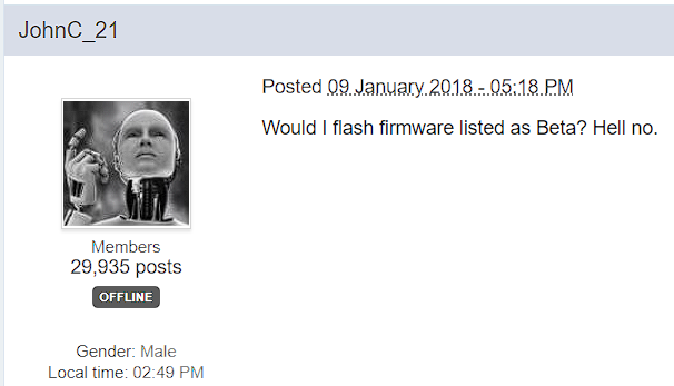

Would you flash a BIOS listed as "beta" - Internal Hardware (bleepingcomputer.com)
Don't use the beta BIOS? Some people enjoy playing new features and that’s what the beta is for - if you use it instead of the stable then that’s your problem.
But it won't brick your system..

The most recent 3 MSI bios have had beta beside them, one was for 5000 support, next was to introduce SAM, and the current is for the agesa update.
They've removed the previous one, when uploading the current one, and it would seem although the changelog isn't there, they have been built on top of each other to add features
its a poor implementation of a changelog, but the current BIOS is the one for all of the above.
I think in its case beta means unfinished, as if they have further features to add, rather than potentially broken
