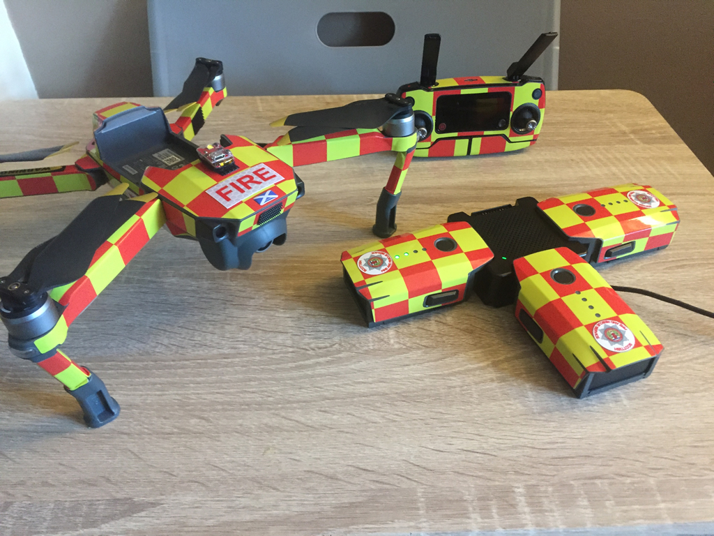

Weather been rubbish but it is to be expected at this time of year I suppose. Got out a couple of weeks ago and grabbed some footage of Stirling Castle and the Kings Knot. Charging batteries just now for tomorrow, dry and wind looks light'ish for Sunday. :cool:
Considered the Mavic 2 Enterprise at all with the FLIR camera and additional parts (high power LED lamp for example)?
I'm on it, looking at expanding our SAR capability with something similar. Gotta persuade senior management its a good investment first though.
