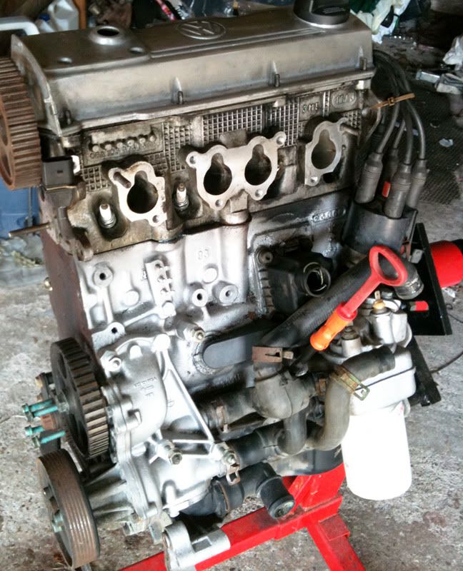

Ok, another little update. I finally decided to get my arse in gear and start work on the 'new' engine. I stripped it as far as I needed to and removed the head. It was looking a bit sorry for itself so I gave it a de-greasing and a couple of coats of engine enamel:
The pistons and bores are in great shape, very little coking on the pistons and the honing marks are still very visible in the bores.

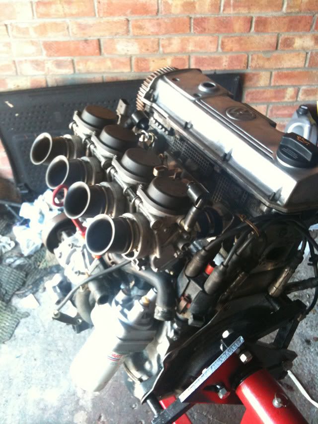

I made the small mods needed to the head and fitted it:

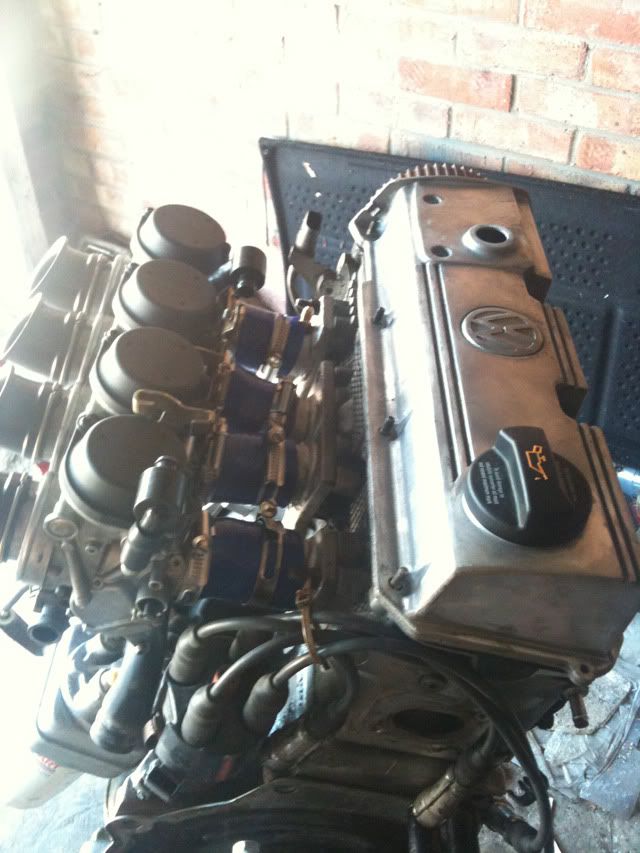

I fabricated a quick 'n' dirty inlet manifold, it's not the prettiest thing but it'll work for now:

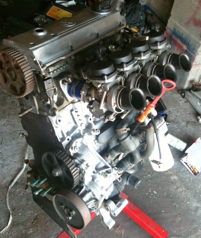

I then loosely fitted the manifold and attached the carbs to check fitment:
The runners are ~90mm long, could doing with being longer for better torque but that length is ideal for space and 'packaging' under the bonnet, and it's only a fraction shorter than the length of the runners on a Bogg Bros manifold, and they know a thing or two about fitting bike carbs to a car engine.
I'll be ordering a Newman 272 deg Camshaft tomorrow, after that's installed it'll be pretty much ready to swap into the car :)
cool build, what head did you say you use ? a mk4 golf one ? (2.0l i presume?)
And what / how did you go about the mods that needed to make it fit ?

Yeah I used a MK4 crossflow head. I had to blank/reposition an oil drain hole, and open out two of the head-bolt holes. Other than that it's a straight fit onto the 2E bottom end :)
