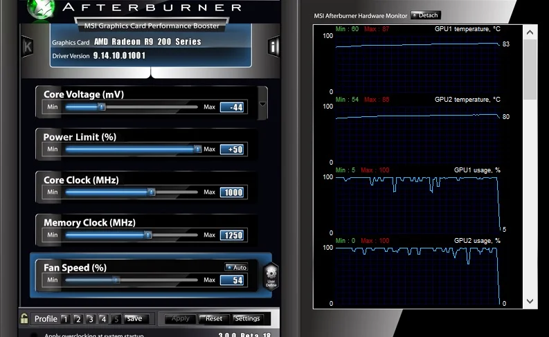

It does not look right. I'll play 5 minutes and report back with my findings. What OS are you using?
Windows 8.1, cheers for checking.

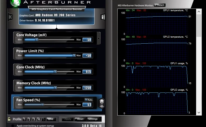

Ltmatt, does that look right to you below? That is my GPU Usage when playing BF4 in Crossfire?
Wow, completely different. Just unparked core 0 and 1 I think it said.
Im running BF4 on Ultra 1920x1080, vsync off and motion blur 0%
Just tried again and although the AB graph looks the same it felt much smoother? What settings are you using?
I'm at 1440P, ultra preset with x4AA. I think you might be a bit cpu bottlenecked at 1080P. Try running at the highest settings and overclocking your cpu as much as possible.
Unparking the cores has definitely helped. Seems much smoother. Graph is looking a little better as well. Will try and clock up CPU. Gutted it's not as simple as new PSU though.
Good man, glad to hear it working better. Core parking made little difference for me, but for some it seems to help. Doubt your gpu's are getting much of a work out at 1080P. Once Mantle hits and is more stable you should see a big boost.
