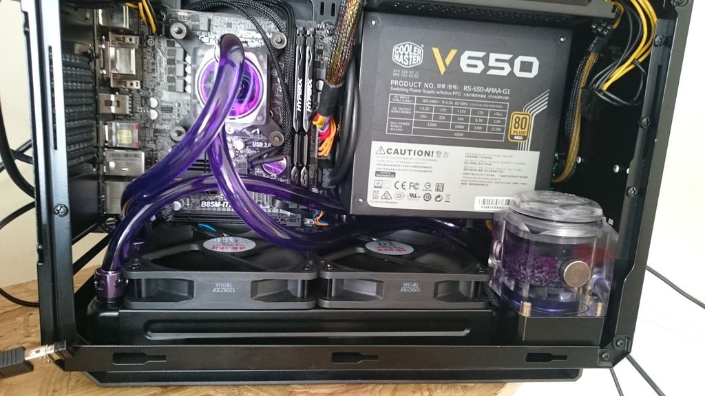

New WC Loop
Will experiment with the sponge
Decided to exclude ball valve and go with res drain port instead, as it will be lowest point if tilted
Will all make sense once put together
I have measured tried all possible scenarios
Can only fit thin single 120 or thin dual 240 with single fan
Thick single rad isnt going to fit. Clearance from ram clips to top is 35mm
Tried to do an imaginary loop and can see i need 2 45 angle fittings as tubing bends easily
Ive managed to put it together
As mentioned, i'd need few 90 degree fittings and will be adding a 120 rad on top
So far everything fits perfectly and as mentioned with 1-2mm clearance :D
Placed a rubber piece on the psu where res might be touching it to decrease vibration
Replaced Res drain port with a G1/4 cap as this is what it is, drain port :D
Another dilemma I am having is the GPU clearance now
I have placed the rad onto the rubber padding and also I think it sits on 1-2mm of screw debris
So far so good, managed to cut a tiny incy bit of the front of the leg ( can barely notice ) to fit them back on with res screws sticking out
So far so good with extra fittings I can make it work every better
Going to be a VERY tight fit once its done but I think its worth it
Glad I decided to go with this case, hopefully id be able to perfect it in a similar way to my previous ITX project :D

Like the purple coolant. With the sponge in the res it actually makes it look like you've got Aurora in there!
ITX Cases: You do like your small cases! I was that way inclined when I was doing LAN parties but I got fed up of the noisy fans. Wasn't until after I'd gone back to ATX that I got into watercooling
Drain port: Does the side of the case fit with that on? It looks like it protrudes :eek:
Some options regarding rads and GPU: Could you mount a rad at the top? (not pictured) Could you mount one on the side panel with enough tubing that you could still open the side for access? That could get you another 240.
If you can get the rad and fans low enough, all well and good but you're going to need some clearance for the fans to pull air in too. Could you use a PCI-E riser cable and mount the graphics card at 90 degrees to the norm? This also gives you the bonus of being able to see the water cooling block too. There's a few projects that have done this to good effect.

Stop cap is about 5mm bigger than the original cap. I can slide it in but taking the panel off I need to lift the bottom corner slightly then it comes off. Not a problem really
ITX cases yea, I love the idea of having meaty hardware in a tiny space and now that I experiment with WC might be able to go further
Drain port is fine, all closes and not in the way of anything. Glad ive came up with this plan to exclude valve from the process
No bubbles in the system as that pump is very good I think, filled loop in less than 5 mins. Hopefully doesn't leak :D

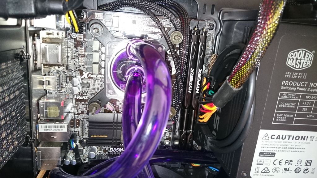

Something strange is going on
Tube that is going from pump to cpu I can feel vibration and assume liquid is moving as its full
The other tube that runs from cpu to rad had a massive gap with air in it and its not moving
The last tube which is rad to res is also full of air with no movement
Temps don't hit 50 even when running 3d app/games
What could this be?
blocked up loop? rad or cpu block?
If you've got the gfx card flipped up on a ribbon, you can take the tubes in and out from the back - near the motherboard.
It's normal to have tiny air bubbles in tubing but not massive bubbles. Being soft tubing you can squeeze it to see if they start moving. If you've got the pump at variable speeds, you can turn it up full and see if it blasts them through. If I've not suggested it already, an Aqua Computer PowerAdjust is a good way of controlling a 3-pin pump. If it's mole and 3-pin they do an adaptor or you can re-wire it youself. If it's PWM you could run it off the CPU fan header - the rest may not do PWM even though they may be 4-pin.
To give you a reference point my CPU is a 6700K and it currently hits about 70C when gaming but I have a 980Ti in the loop and CPU turbo's up to 4.4GHz on all cores. If I remember correctly it was in the 50's or early 60s before overclocking.
Can you feel the water flowing on the 2nd tubing? as in not the direct tubing that come out of the pump
As I can only feel the waterflow from pump to cpu block
Its like cpu block is actually blocked and doesn't let water through
There were massive air gaps in the loop I have managed to make it go away and all the tubes are now filled with no visible gaps or air bubbles
But there is not flow/water movement apart from the first tubing section
Pump is on full all the time so there is enough pressure to go around, its working because I can feel the flow of the first section/tubing directly from the pump
there is no gpu in the loop yet but I think the best thing is to drain/clean and refill
I am all out of ideas otherwise

I have done all that and still there were huge gaps in the tubing and so.. I've done this:
Decided to drain the loop. Never done it before so there were spills on the kitchen floor :D
I have opened a res drain and got rid of some liquid, closed it and then unscrewed cpu block port when there was no liquid either side
Basically simple process. Used de-ionised water on rad to clean and warm water for tubes
What I've done while draining is sip the coolant through a fine mesh to trap particles, dirt etc. I have then poured the mix back in the bottled and refilled the loop with it
Figured it wasn't there long so no harm done
I have shortened the tubing as well
I have then opened a cpu block and cleaned it, there was a lot of dirt and stuff, used a small plastic brush
