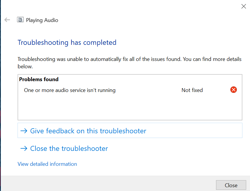

still the same, Problems found.. One or more audio services isn't running

So did you:
  • Clear CMOS after BIOS update and check settings F10
  • reinstall chipset
  • Reinstall realek
  • And Perhaps GPU
*Also have you tried:
Check the box for 'Disable Front Panel Jack Detection' - it's in the top right folder icon located within Realtek Audio Manager. This will effect both front and rear jacks.
Look at this thread - Clicky
Had had very similar problems to you a couple of days ago (ASUS board too) - we ended up reinstalling, clearing partitions, formatting and reinstalling - with only one drive attached.
He also did the above too - so may have been a combination of things - but ultimately fixed. Read the thread and do assess what may apply to you. It would seem like the latest Windows update was the problem.
The only other thing that i added was to only have critical updates applied - and when installing Windows have internet disabled and drivers ready to install (if you go down this route).
Any questions - if you choose to do this - just ask...
