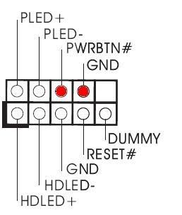

just downloaded the manual as i couldnt not get a decent pic if the mobo
i have put red dots for the 2 pins needed for the power switch
fenderbass86 yes it's important. Double check all the pins to make sure you're not plugged any more in the wrong places.
Ok, so the PWR switch has to cover two pins, however, I only have one available once the PWR LED is covered. It takes up 3 pins alone. Can that be right? Or should I return the motherboard for a good one?

Can you draw out, or describe all the pins that you have on the motherboard please? I agree with maf718 - get the power switch and the reset switch on there first. Then have a look at the other ones (which are less important). In this day and age who needs a little LED to tell them the PC is on - that's what all the fans are for :-)
I used to have an asrock mobo and the pin assignments were exactly the same as cupra drew a few posts above, I think its a pretty standard setup. When I changed my case to an Antec one, the power LED connector was 3 pin with middle one blank, so didn't fit. I just left it off, everything else fitted, its no big deal. If you absolutely have to have the power LED just butcher the connector from the case to give you two single connectors. ;-)
The picture above in Cupras post is correct.
PLED+ and PLED- is a 2 pin for the LED, and PWRBTN# and GND is the 2 for the one / off button.
If you have a 3 for the PLED you maybe able to make it into a 2 by moving a pin over. Fiddly to get out, but it's possible one some.
Else just cut it in half, and make 2 seperate singles.

Your picture in this post is wrong.
You also have the reset on the dummy pin!!
GET IT OFF.
I doubt your going to be able to show us anything....if the top rail has 4 pins and the one below has 5 then you don't have anything missing.
Ignore the Power LED one (your 3 pin) it's NOT needed.
Your reset has 2 pins and above that sits the on / off (power button and ground)
The dummy pin is NOT used.
Also note HDLED+ and HDLED- is also 2 pin only and does NOT need to be connected. Its a light only.

if you haven't done so already try just plugging the power switch connection into the motherboard header, and make sure you are looking at it from the right side - they are pretty much standard, but often the manuals aren't 100% clear on which say you should be looking at it.
You should also (normally) be able to see the markings on the motherboard for the header, you don't need to worry which way round you get the switches onto the pins, as long as it's on the correct pair of pins (unlike the LED's it'll work anyway).
