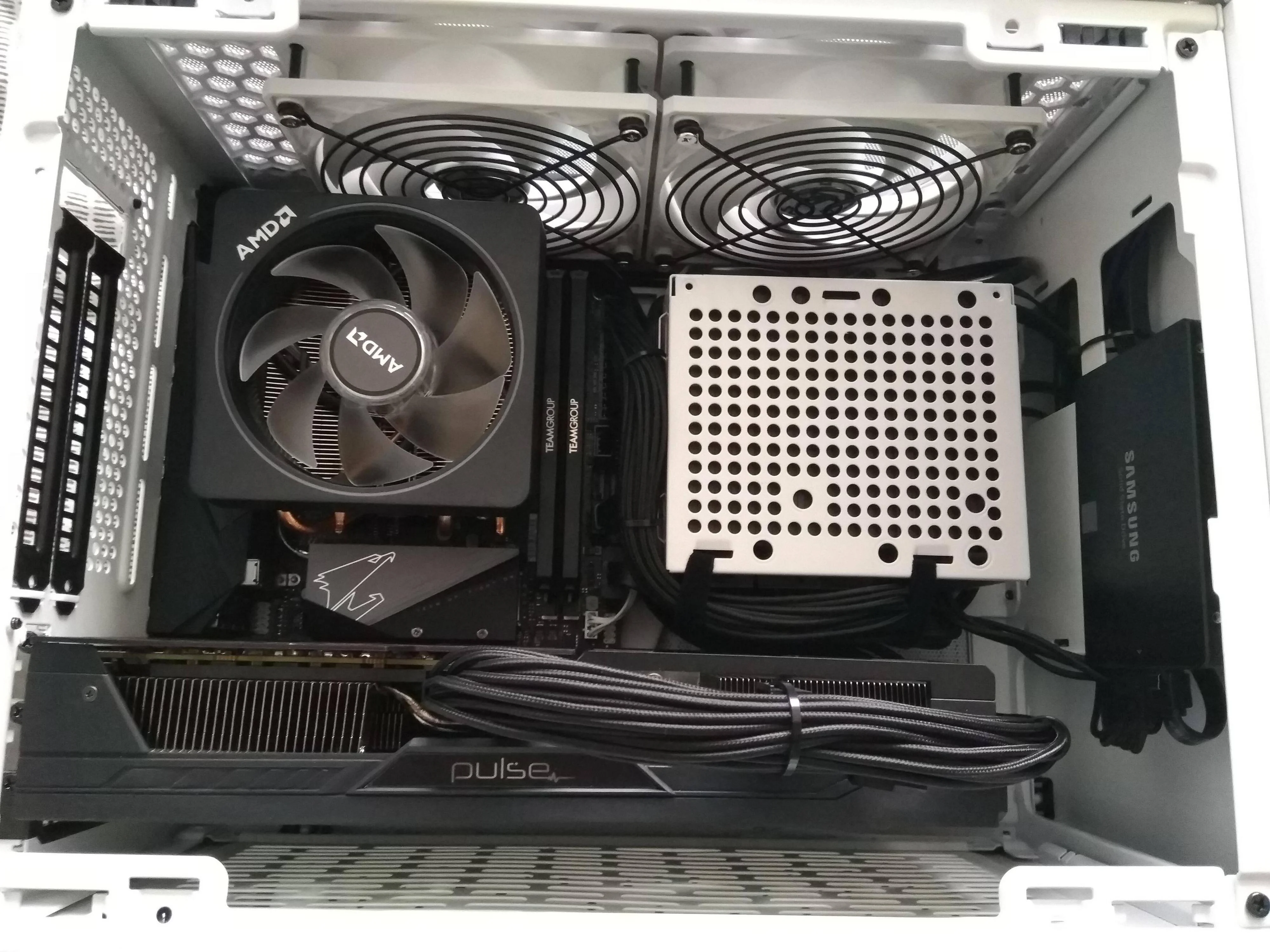

Redone cabling looks good Relentless, shame the card is a bit too chunky for the fans underneath. Suspect it will be fine though, I'm not getting any temperature issues on my 1070 without the fans below it. Although think I'll be doing a test run of squeezing some fans there for comparison later.
Yeah the card performs fine, I'm concerned about the dust ingress due to no intakes at the moment

I'd have thought that the majority of the air being brought into the case would be from the filter side and bottom panels, so wouldn't expect dust ingress to be too big an issue.
