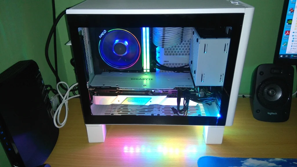

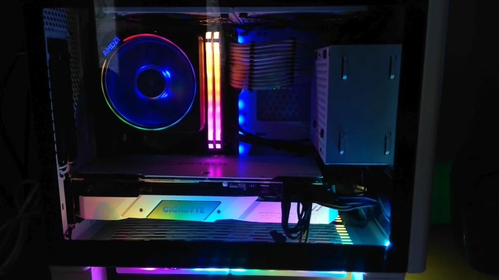

Right guys the TG panel fits only just, with the Scythe Mugen 5 cooler with 2 fans in push pull.
check here
https://share.icloud.com/photos/0PufkXnUOWUMbmJ_uSwqqIANQ
Ok this is interesting, is this your build? Very nice if so, loving the GPU deshrouded look
Did you do anything to get the Mugen to fit or did you just install and pray, what kind of gap are we talking to the glass is it touching or is their space there?
Must admit I'm a tad confused because tech testers clearly showed the Evo 212 not allowing the glass to shut
Edit - Ah ok its 154.5mm tall so 1.5mm taller than CM's recommend spec, this probably the best 120mm cooler that'll fit with the TG panel if it is a straight drop in and it doesn't touch the glass

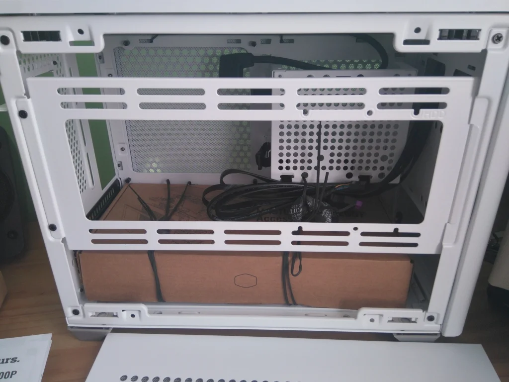

My build/Project mod in the "Coolermaster NR200P ITX case" Revision 1
The best ITX case so far I have built-in,

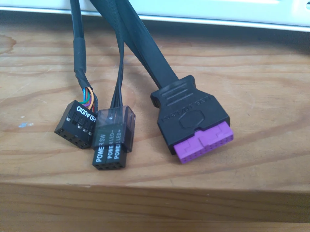

All quick release panels, Quick mount SSD/HDDs, even the front I/O wires Reset, HDD, LED, Power
are already fitted to an adaptor, Just plugin.

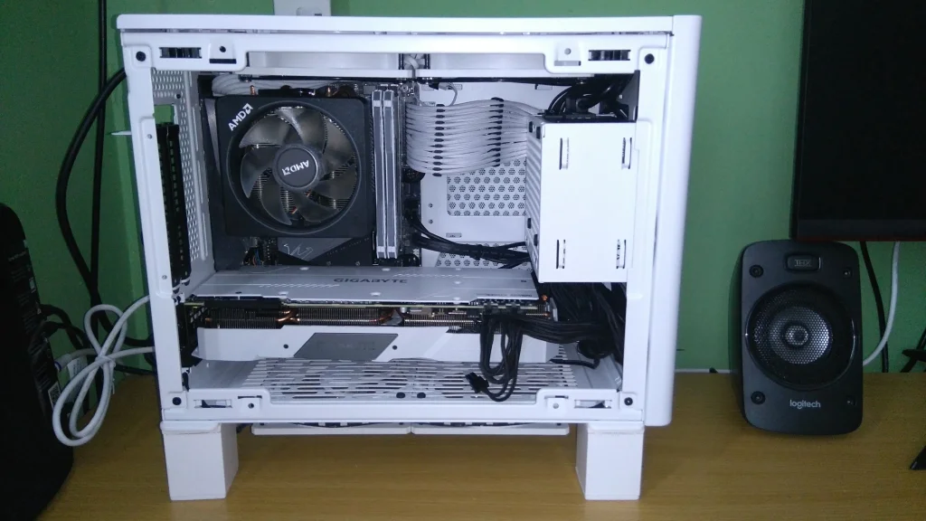

After my first practice build, I moved the PSU Cage to the front mounting point
Since I am not using the GPU Riser Cable for Vertical GPU Mounting
at the moment.

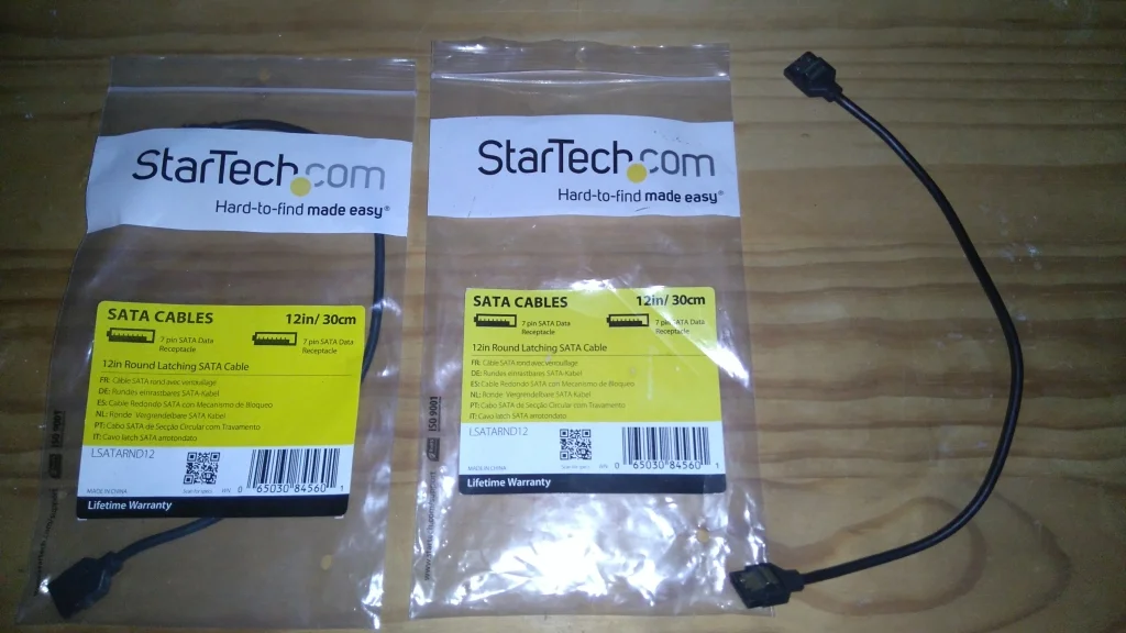

2 x star tech SATA 12" Cables

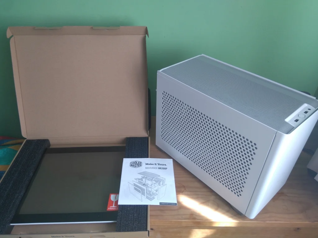

The NR200P as the TG window in the box with the case

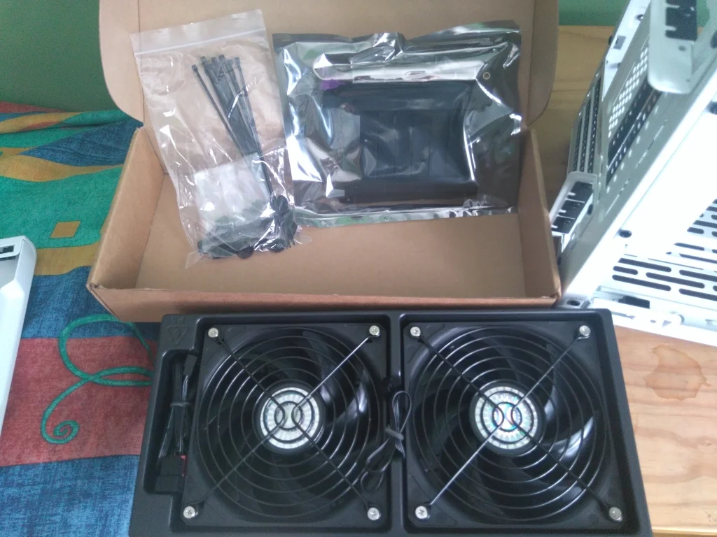

NR200P accessory box that contains: 2 x SICKLEFLOW 120mm fans, PWM fan splitter, GPU Riser Cable, & a bag of screws with cable ties.

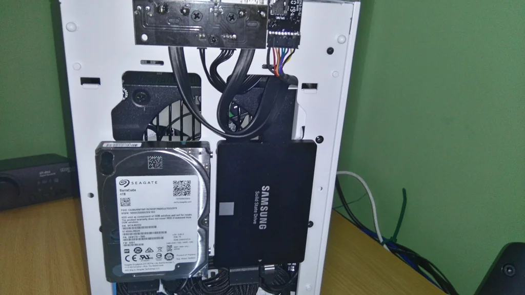

Another nice feature, The front I/O wires are fit to an adaptor so you only need to push in the right way up.

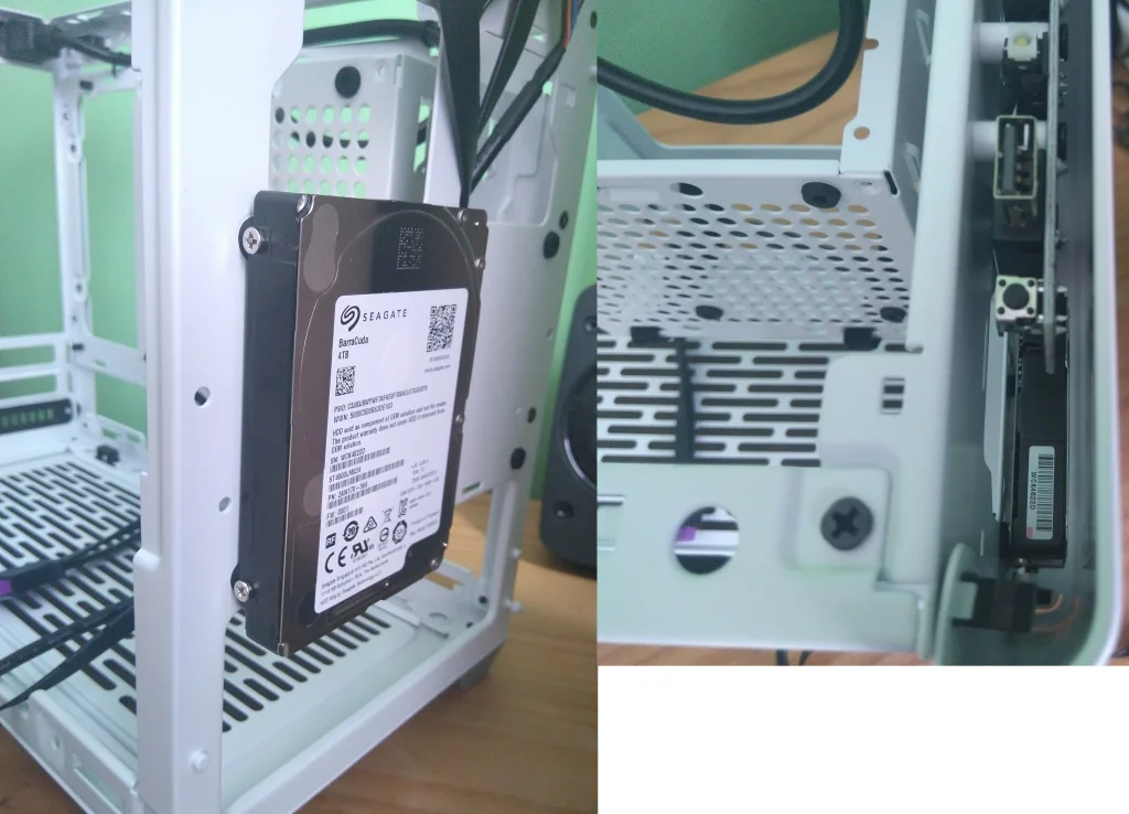

Front 2.5" HDD mounting up to 1.7cm with the front panel on
Used 2 x 12" Short SATA Cables

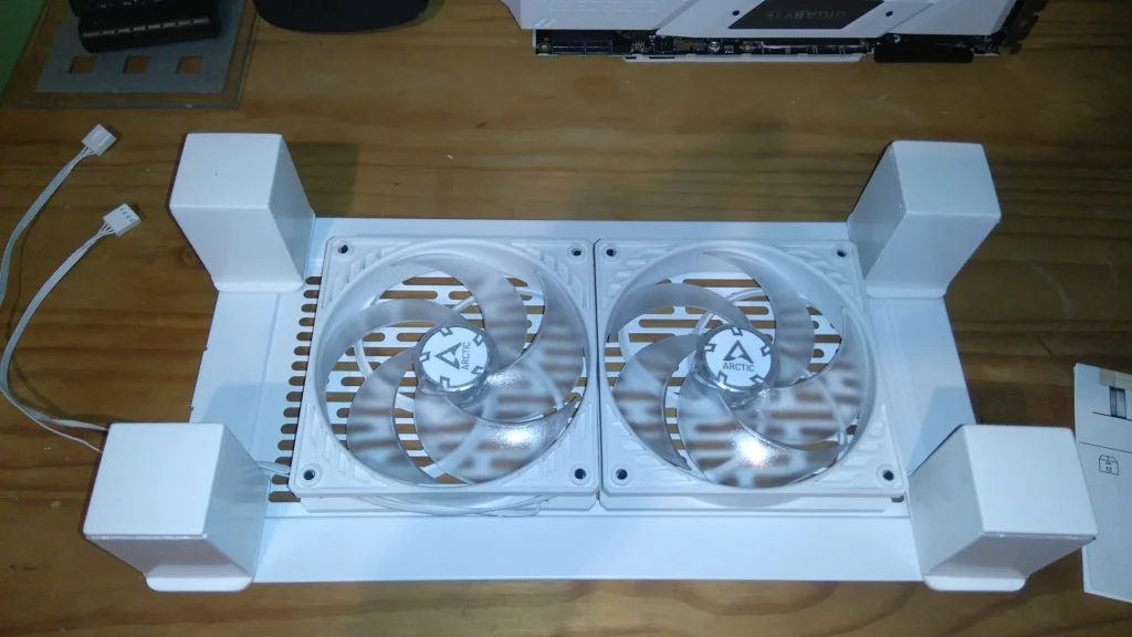

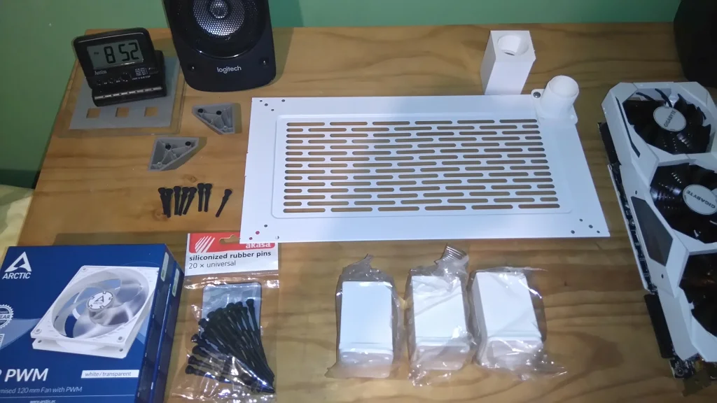

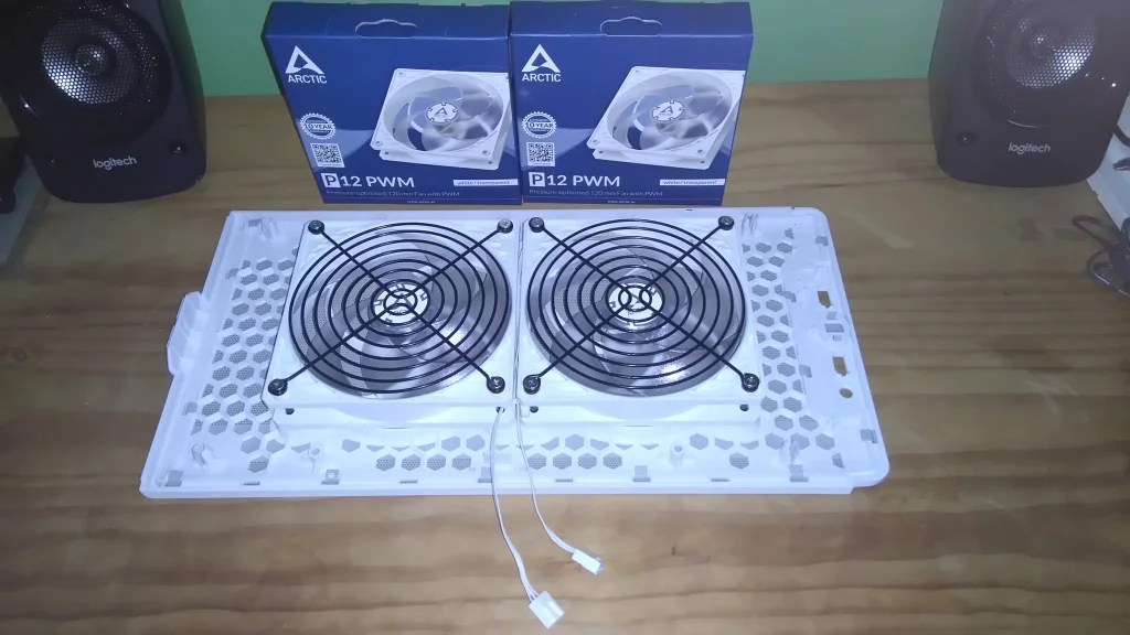

Replaced the 2 top panel Coolermaster pwn fans with Arctic P12s white

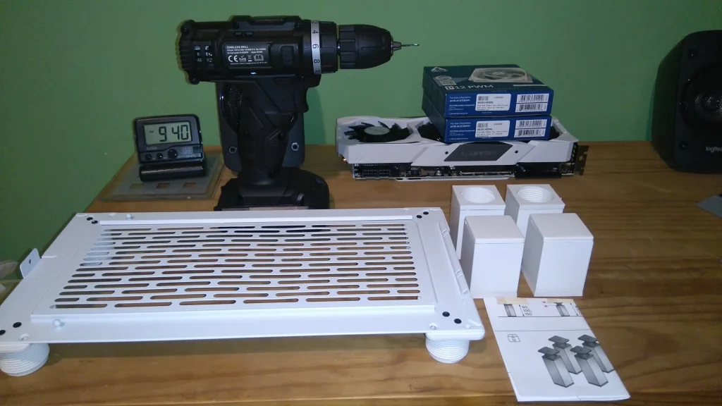

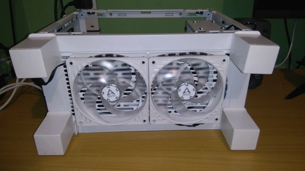

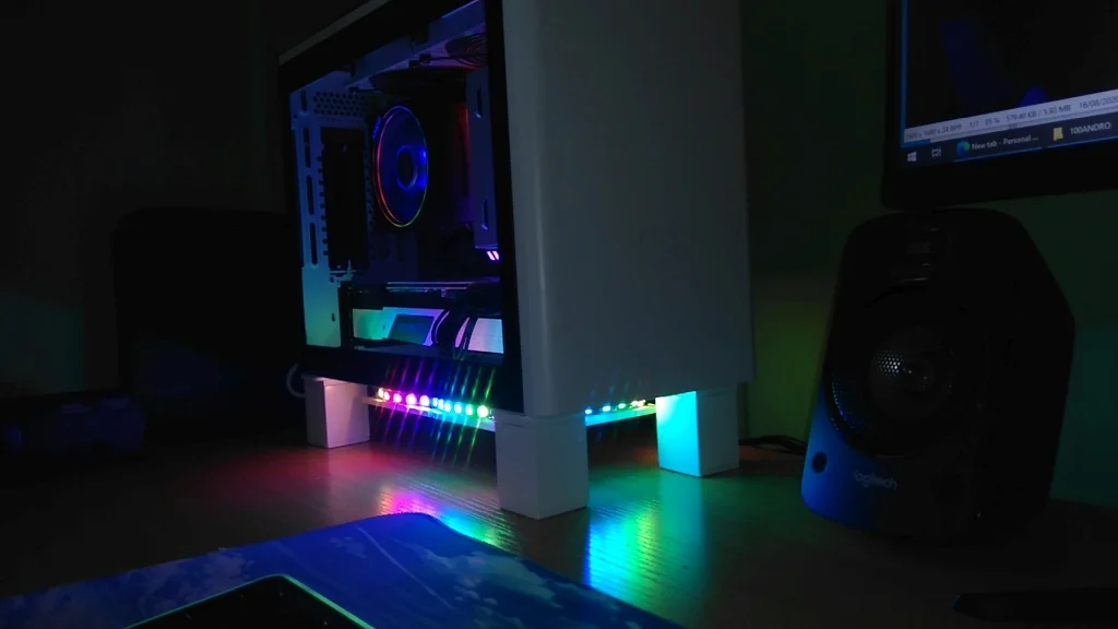

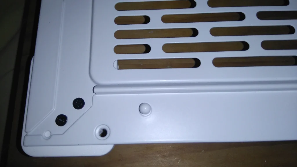

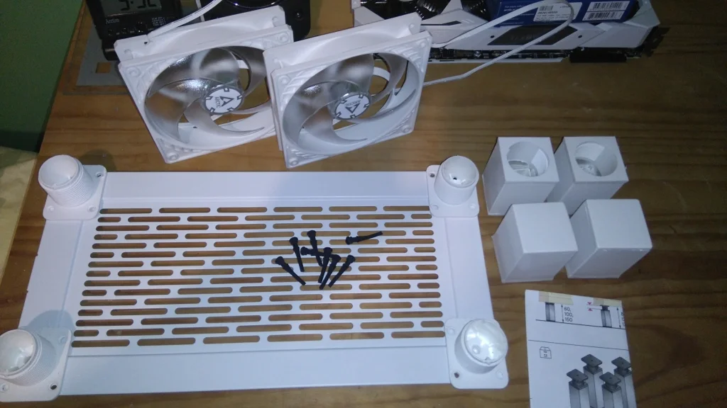

Modding the case feet
I changed the case feet to ones that can be adjusted in height,
where the stock feet once were.

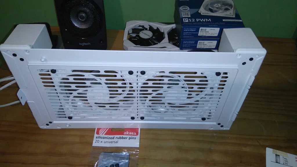

Now I have some height from the ground I can mount 2 more Arctic P12s using easy silicon rubber fan Pins under the bottom panel,
I also have ARGB Strip around them.
Reused the stock feet screws & holes in the bottom panel &
drilled 2x 1mm holes into the new feet base & screw the feet on.

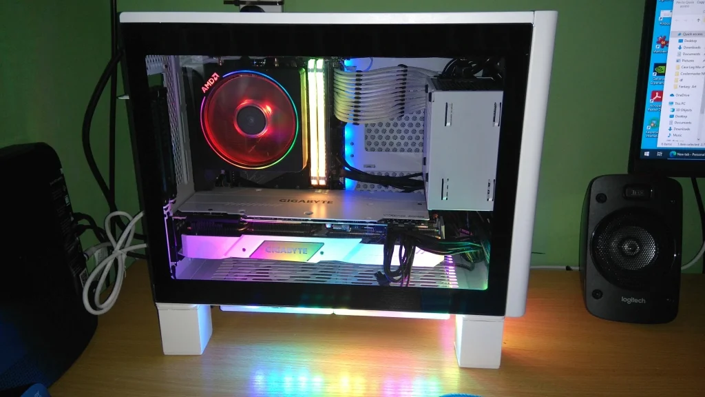

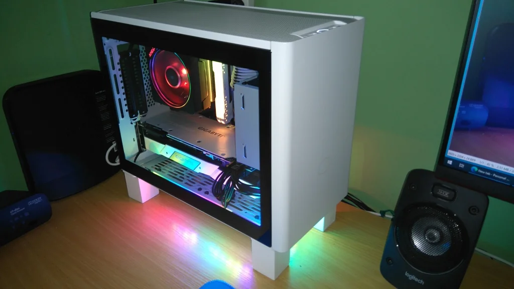

Case Around 93% Tidy will improve in the near future, The PCI-E power cable will be changed to white one soon also.
The Finished Build

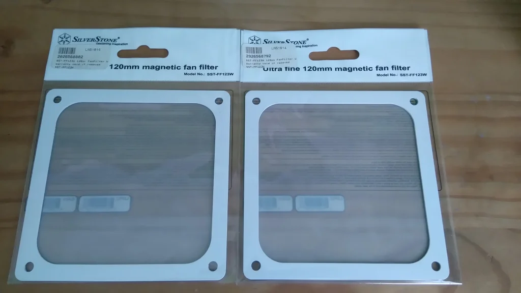

What were the two white filters for?
Arctic liquid freezer II 240 may get one later on,
when the 240 first come out & Arctic was not well known for coolers, could be picked up for less than £60
Yes, the side panels are magnetic filters, the same as the bottom. Only the top filter isn't easily removable.

Yes its my build and thanks very much.

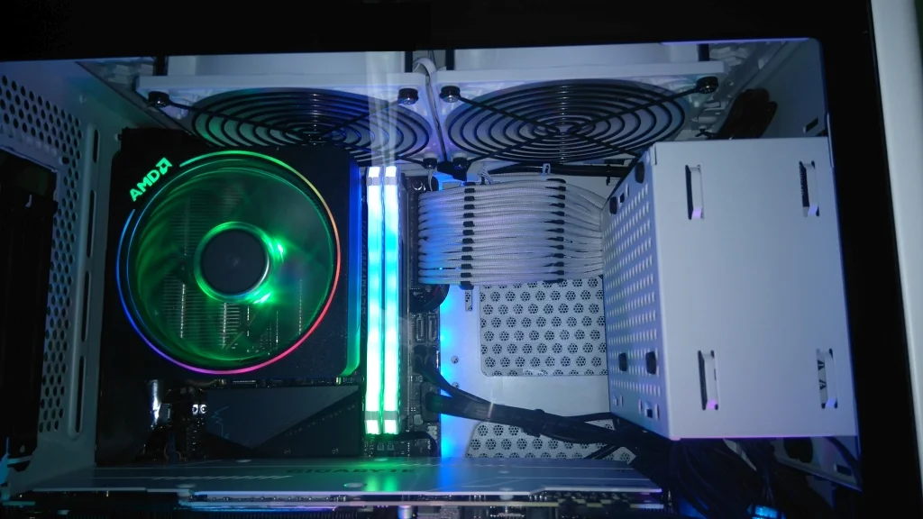

The mugen is just out of the box fitted, had to take the top of my mem sticks off (using the teamgroup) to allow for secondary fan for push and pull.
The gap is probs less than 1mm but the gap is there.
Thanks, when you say you had the remove the RAM heat spreaders do you mean to the rear of the cooler or the front?
Edit - looks like you reversed the cooler so the rear of the cooler is at the front of the case so it over hangs the ram slots, assume this is so you could fit two fans otherwise it would be too close to the rear
