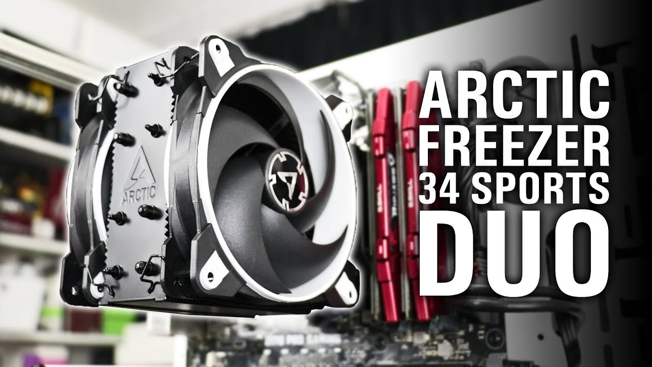

I was considering the Arctic Freezer 34 esports duo at 157mm in height. Are the sticking out pins for anything in particular? It wouldn’t take much to shave 3mm off with a dremel (photo below of the pins/studs below that could be shaved back)
Swap to the 33 and it'll fit fine. The 34 is 157mm. The 33 is 153mm.
