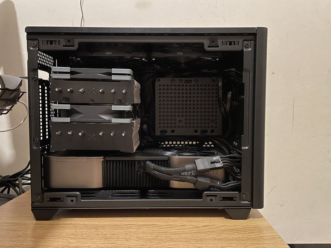

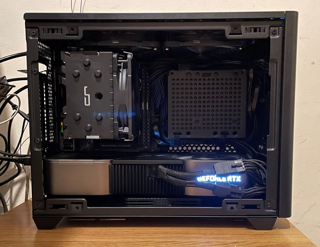

Cryorig H7 is a decent option for some CPUs with a lower TDP. Finally managed to get the fuma 2 to fit but had to use a different orientation.
It is but there are reports that its convex base are no good for Ryzen IHS particularly 3000 series also there are reports that Gigabyte B550i owners cant install it due to the mounting bracket hitting the VRMs
What CPU are you using and what temps are you getting?
Using a 9900k at the moment. On the H7 high 80's at stock (4.8-4.7 ghz). Not ideal but it's within spec. Currently testing out 5ghz on the fuma 2.

So I was looking into this after you mentioned it a few days ago. Is the base plate actually convex though? The only thing I saw point to anything convex was their heat pipe arrangement.
Maybe it is just the heat pipes and not the plate itself, that image also shows performance vs a stock intel cooler not AMD so for me thats a bit of a give away that its engineered more for Intel but thats just speculation on my part
You can google "Cryorig H7 Ryzen Reddit" and you'll see a fair few discussions about this, I wont be taking the risk anyway
