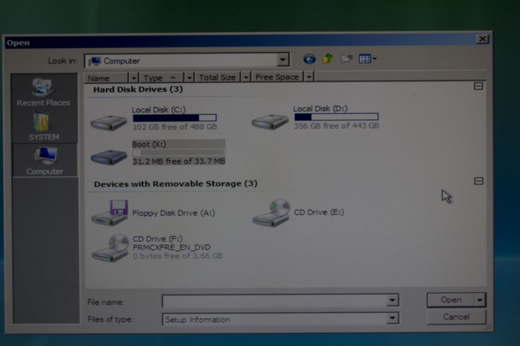

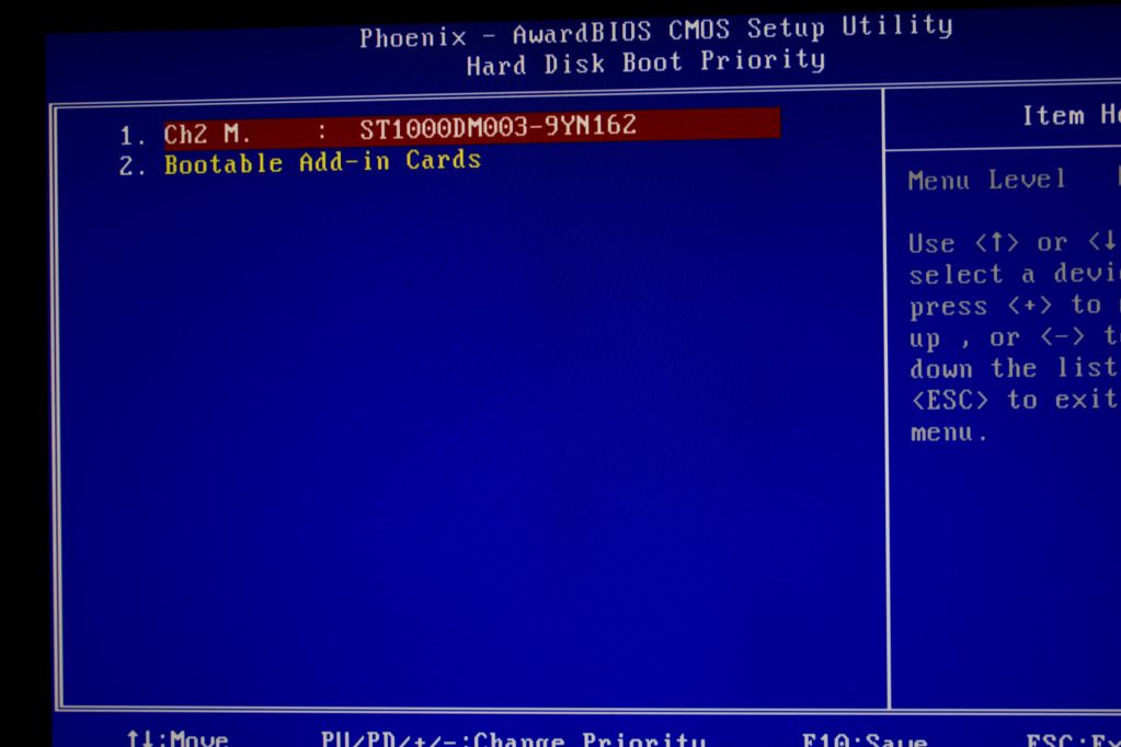

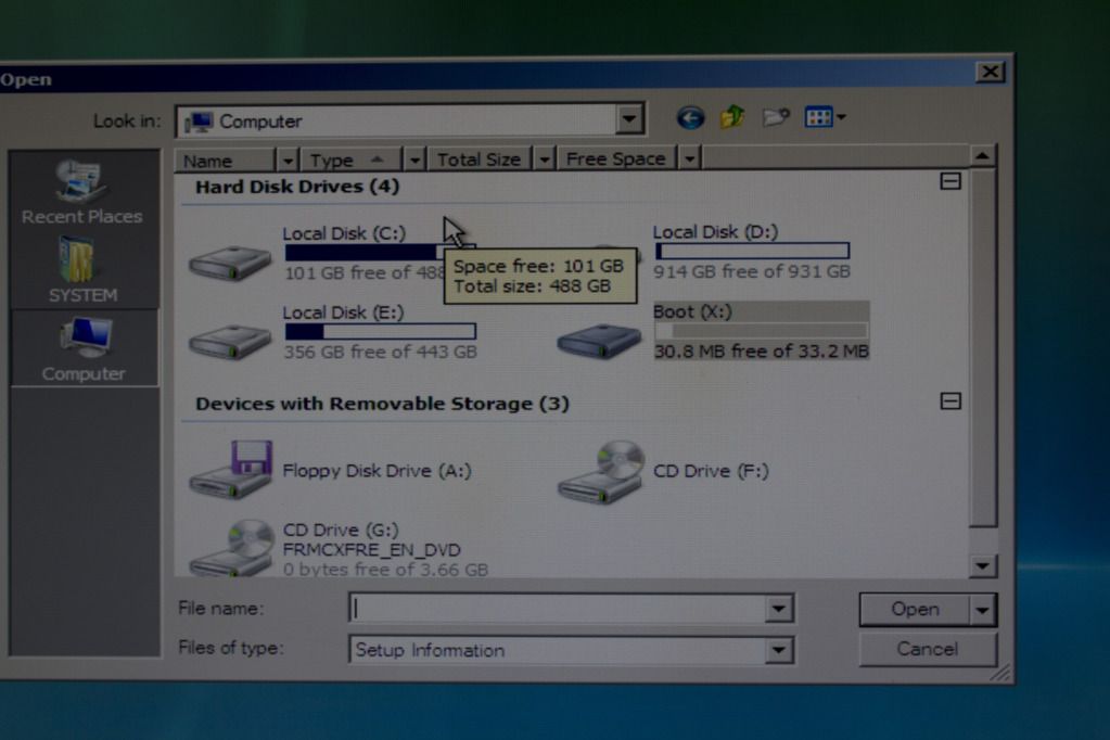

The first thing i did was to use the same cable outlets, so its not that, i tried removing all other boot options then i get a "disk boot failure" error, in the bios "hard disk boot priority" my hard drive is set as 1. And if i insert my O/S disk and go to load drivers my hard drive is recognised in there, so the pc knows its there, this is so weird. Another strange thing, i went to the seagate website and downloaded their utility to find my hard drive details and it didn't recognise any hard drive at all, even when i was on it at the time, :confused:
I have installed EasyBCD to change the boot priority to my new drive which is the only reason i can use it at all, with my old one connected. And i have tried removing my old one from the boot list but this makes no difference.
