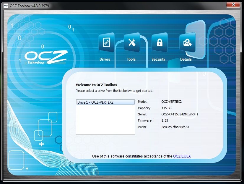

According to OCZ website I should he able to update the firmware from windows, but this isn't working. I'm getting an error regarding installing it on the boot drive. So I took the SSD to a friend's house and plugged it in. I ran the OCZ toolbox again, it finds the drive, downloads the firmware, but hangs as soon as it attemps to write it.

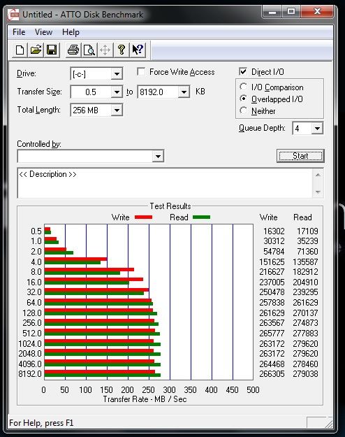

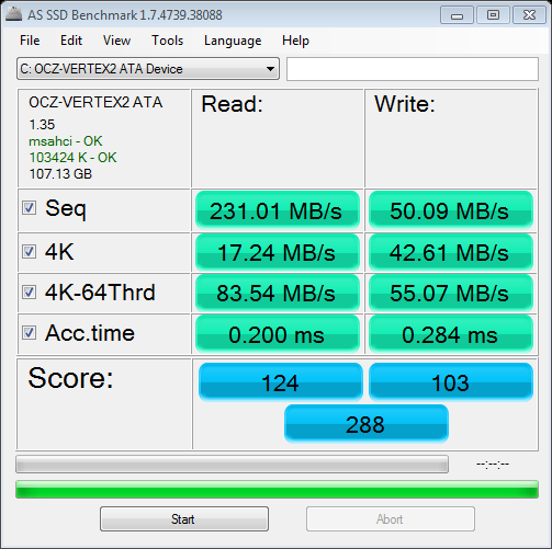

I ran the Atto benchmark yesterday and it shows very slow write speeds(about 50mb), according to a few OCZ forum posts I've read, Atto shouldn't be used to make measurement of speed because it's wrong.
So post some screenshots when home this evening, thanks
Posted from Overclockers.co.uk App for Android
Not sure what posts you have read re ATTO benchmark... but this is most definitely the one to run for Sandforce based drives (as it tests using compressible data). This application is what OCZ use to get the performance figures that they quote in their advertising. It's repeated runs of benchmarks that write large amounts of incompressible data (EG. AS SSD and Crystal Diskmark) that you want to steer clear of.
So yes... a screen shot of a full run of ATTO please.

Regarding flashing the firmware on the SSD. Best method is to try connecting to another machine as a secondary (IE. data drive) ... Unless you are trying to use an earlier version of the toolbox... then you can't update the drive as a primary anyway! ... I know you say you have tried this. And use the latest version of the Toolbox (making sure it's the correct version for your drive ... http://ocz.com/consumer/download/firmware). But if the first attempt fails. Mad as it seems, try it again straight away (and a third time if necessary). Sometimes this works.
Please pay particular attention to the WARNINGS in the guide for the Toolbox.
and if you want to use the bootable toolbox. And are having problems with putting it on USB, then try a CD (never ever had an issue with this... but there is always a first time!).
I got confused earlier, it was AS SSD which recorded the slow readings, I've just tried ATTO and will try and post the images with this post.
Right....
The good news.
- ATTO results are smack on.
- Partition alignment OK.
- Looking at the formatted capacities of the drive under Windows that you mention in post #3 ... it looks like you have one of the newer Vertex 2 drives with the 25nm NAND (rather than the older drives that came with 34nm). So around 107 GB is in fact correct. see http://www.tomshardware.com/reviews/ocz-vertex-2-25nm-ssd,2867.html for a full explanation of this.
- firmware 1.35 should be fine. I think the only difference is "Fixed: Blue screen on sleep mode from S3 / S4". Though obviously best to update if you can.

- The 25 nm drives are no where as good at handling incompressible data (write wise) than the older drives. Though I suspect in day-to-day use I doubt if this would be noticeable. There are numerous articles etc. on the WEB about this "issue" (even on this forum I suspect) EG. http://www.overclockers.com/oczs-25nm-vertex-2-performance-issues/
So all told, I think your benchmarks are in the right ball park for this drive.

Can you update the drive's firmware when the SATA mode has been changed to IDE/compatible? What message/error do you get when trying to update the firmware? Have you tried with the Windows version of OCZ Toolbox?
I just get the error about it being the primary drive so it can't do it.
When plugged into another machine as a slave drive, it fails when in IDE mode. The device has rejected the update. Once in ACHI mode it just hangs.
OCZ Toolbox guidelines say:
3) The SATA controller must be set to AHCI mode in the BIOS to utilize the Toolbox.
If the OP still wants to try and update the firmware in his drive. Then as mentioned above, I would try the standalone tool burned to a CD, rather than a USB stick (I have had problems trying this myself).
