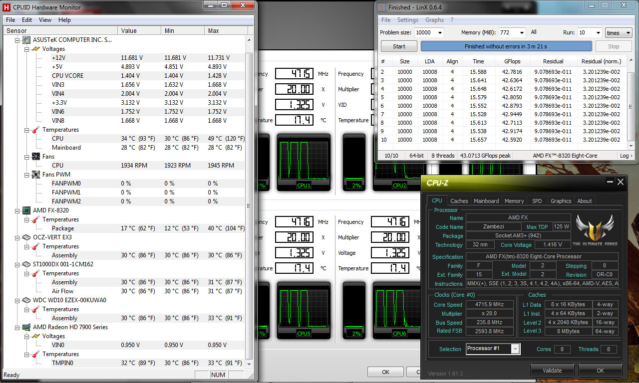

right just had a quick play and managed to get 4.7Ghz with 1.41v fairly stable.
I tried getting 4.6Ghz using the FSB only but it threw a right wobbler, locked up the system and I couldn't even get back into the bios.
Luckily after a few tries I managed to get into the bios via one of the motherboard hot keys.
Going to do a few more tests but it passed asus realbench 2 and that normally means its stable enough for my uses.

I normally run the benchmark first and if it passes that do 15-30 minutes on the torture test. If the system is unstable it normally crashes after the first few minutes.
I normally do 5 runs in linx first though as its quick, if it fails any of the 5 runs in linx it wont pass realbench.
You can test for much longer if you like just keep an eye on the temps.
I've done half an hour in the torture test and i'm happy its stable for my needs.
