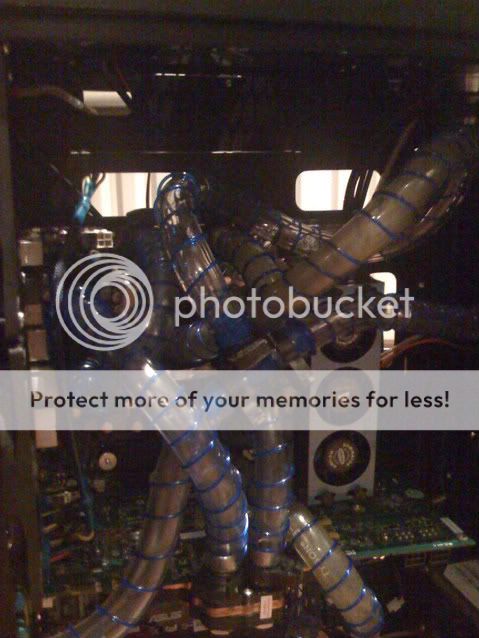

Here's some pics of my recently finished watercooled Antec 1200.
The quality isn't great as they were taken using my iPhone.
The loop is cooling an Intel Core 2 Quad Q6600 in an Asus P5T Deluxe & a Geforce 8800 GTX. The N/B, S/B & mosfets are also being cooled by the loop.
The rad being fitted externally to minimise heat build-up inside the case.
I'm quite please with the results.
External Rad under construction
The spaghetti junction of tubing before filling
Tubing all installed, filled & leak tested successfully
Power on test before putting the side panels on
The finished article
Close-up of the innards
Shot showing the external rad
Shot showing the external rad, top fan & watercooling loop fill-port
